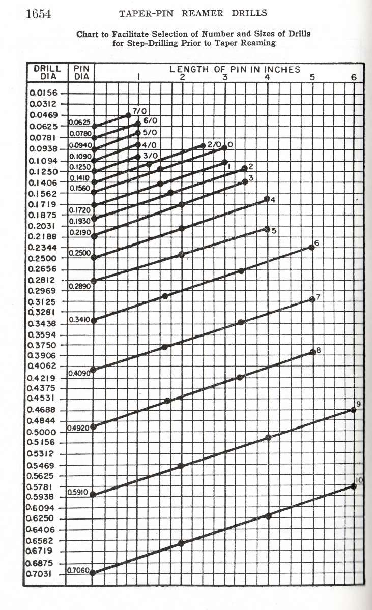

                According to Machinery’s Handbook the drill size for a 1/16″ (#7) taper pin is .0469″, see chart below. Drill size, shown in the left most column,  is determined by following the line to the left of the right most dot on the heavy line corresponding to the taper pin size. As mentioned above if the pin is large and/or long two or more drills should be used to step drill the hole, shown as the other dots to the left on the line for that pin.

                    The table kindly inserted by by John Purdy is fascinating.
                    I’ve never trained as a professional engineer so may be just ignorant of the practicalities of its use?
                    Can you really get a drill of say 0.1875 as shown in one example ? Even assuming it’s a one off, or custom made / d-bit etc would it ever cut to this accuracy anyway?
                    I’m not being cynical or anything, just really interested to learn.
                    Mike

                      Unless I’m mistaken 0.1875 drills are readily available. Most people tend to call them 3/16″ drills.
                      As the page is from an American book the dimensions will be in Banannas inches. it also shows the way the US sizes their small pins by using zeros.

                        I think you’ll find thd drill sizes are decimal equivalent of 1/64 increments.

                          As Duncan says the drill sizes in the left most column are in 1/64″ increments.  The only pins I have used are 1/16, 5/64 and 3/32 (#s 7/0 6/0 and 5/0). To determine the drill size I run a line from the point on the heavy line for that pin that corresponds to the length of the pin in question, over to the left where it ends at the drill size column then interpolate between the two drill sizes it lies between and use the nearest smaller, metric/number/inch drill I have.  Hope this makes sense.
