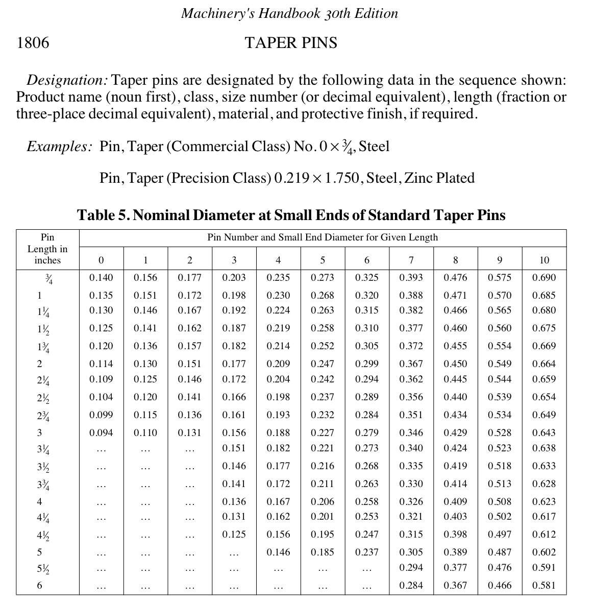

      I have a taper pin reamer that is matked #5. It measures 7.7mm one end and 5.8mm the other. Is this an imperial 1:48 reamer. If so what is the nominal size of the appropriate taper pin

        Hopefully, this one small quotation from Machinery’s Handbook will be acceptable as ‘fair use’ …
        IMG_9806
        #738784
          Worth adding that the table Michael shows is the American designation. In the UK we go by fractional size of the large end so a #5 pin is likely to be 9/32″ nominal
