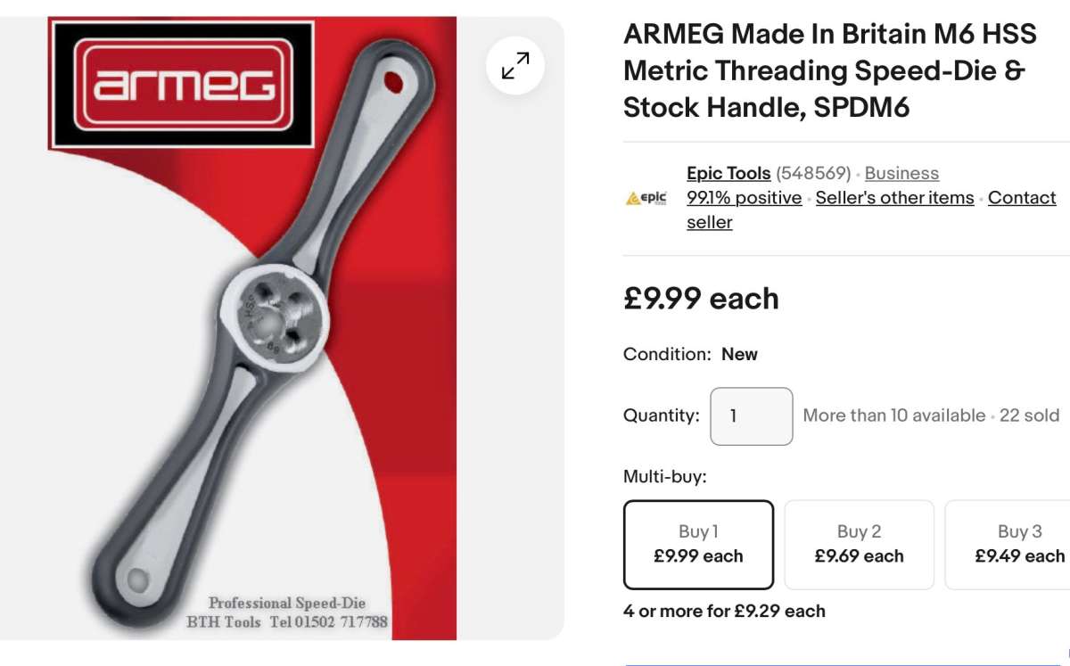

        These are the best Dies I’ve ever used. Sadly I only have M4 and M6 versions.
        They always cut cleanly and to size.

                Roebuck, now owned by Rubix used to sell them. Similar ones were also made by FEW. They now seem to have disappeared? Shame, as they are very good.

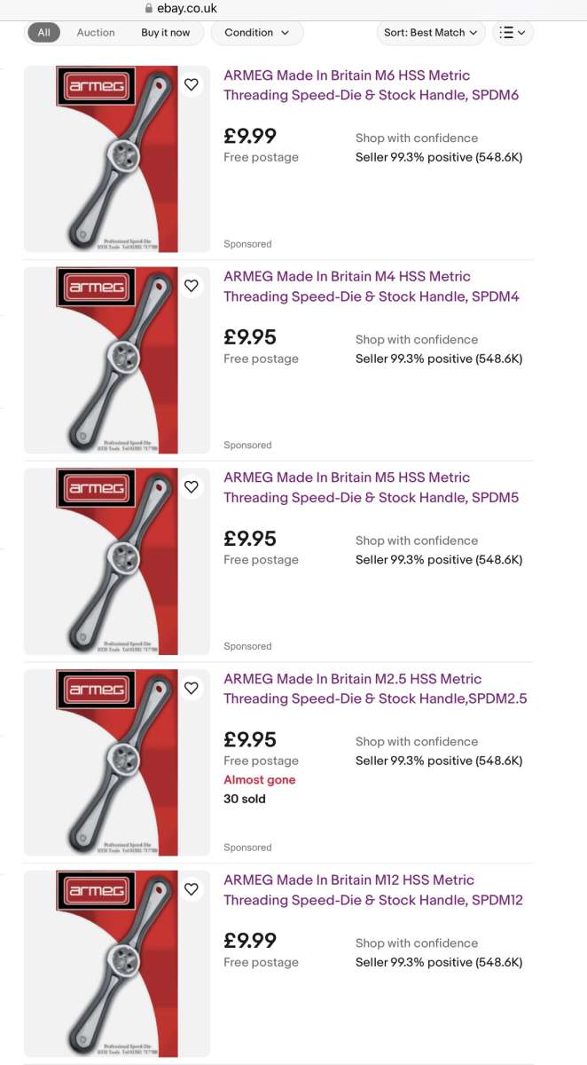

                      There are still a few of these available on eBay. I’ve just ordered an M5 to fill a gap.

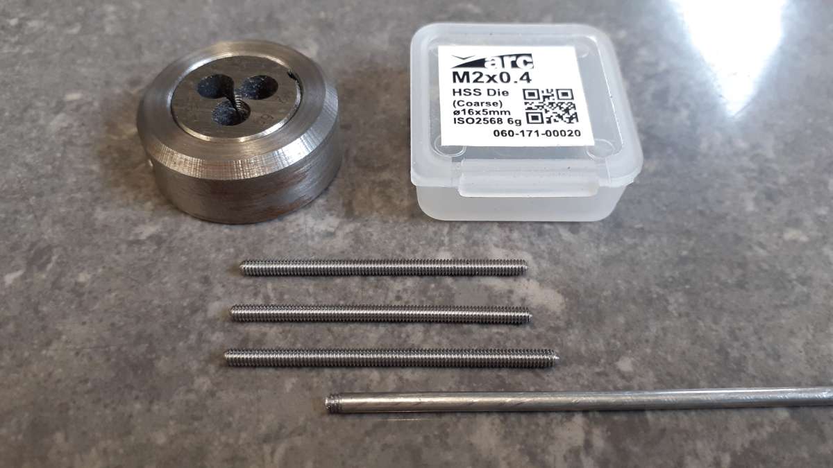

                        Just to show that solid dies are not just for restoring or cleaning existing threads. A couple of lengths of 2mm stainless steel threaded with an M2 x 0.4 coarse solid die. No chamfering of the end first, no reduction in diameter of the stock 2mm 303 bar, no backing off just cut under power at 150rpm, anointed with CT-90 to taste.
                        20240702_144308
