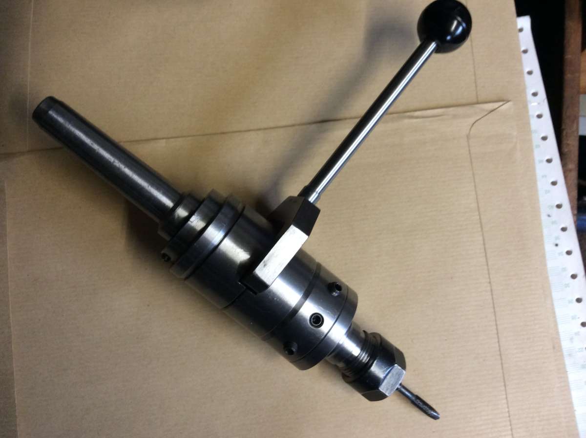

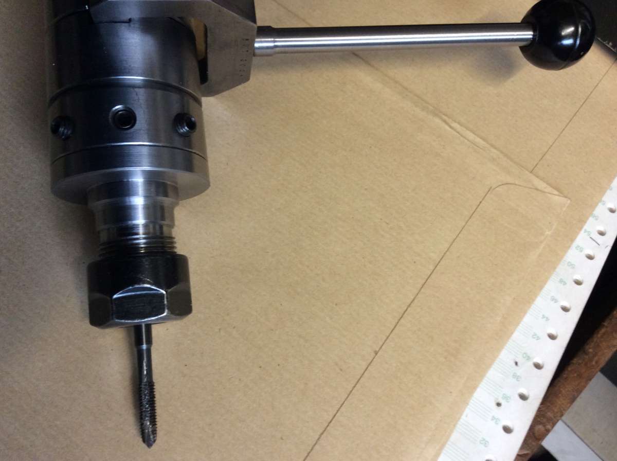

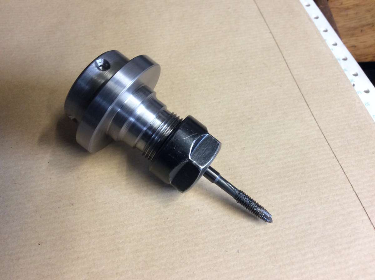

                                      John, you got me thinking about the Hemingway die holder so spent 3 or 4 hours cutting metal and ended up with the adapter for taps to er16 size and yes it works  very well. Thanjs for the idea.

                                        Glad it worked out well, Bernard.  Perhaps Hemingway might be interested in incorporating your design into their range of accessories?  They do say on their website that they encourage new or additional tooling etc.  I’d be interested to see a picture, myself.

                                          Took these this morningIMG_3735IMG_3734IMG_3736

                                            Neat job, Bernard.  I expect Neil could be interested in an article if you ask nicely!

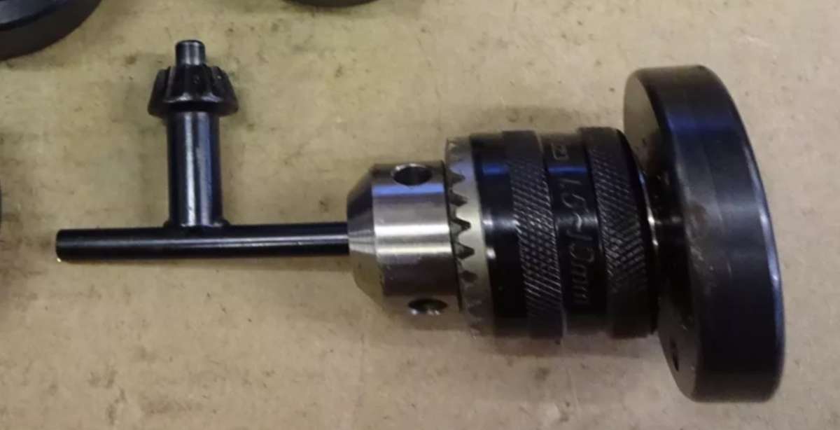

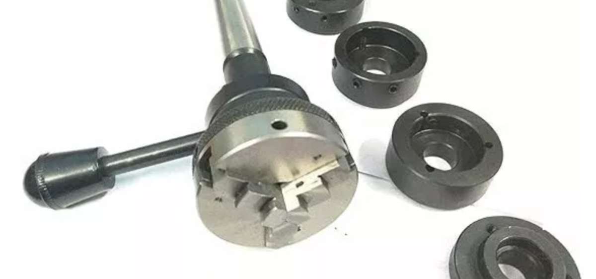

                                              I like the er chuck adapter! 👍
                                              I found these 2 similar ideas online.
