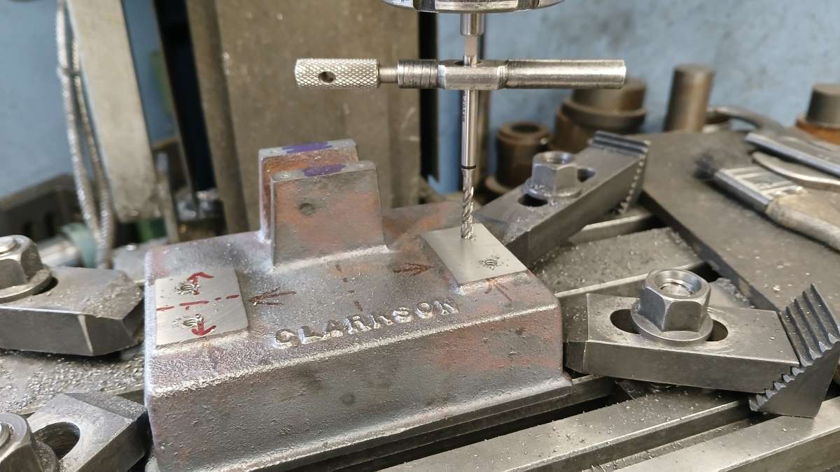

          #762505
            I Put the tap wrench onto the round shank then the square is not obstructed. Bonus is it will slip if the tap goes tight and may save a breakage
            A bit of silversteel with a Ctr drilled hole will locate pointed and chamfered and even square ends. A point on the other end will guide taps that have a ctr hole
            Leave the tailstock unclamped and just push against the handle to keep pressure on the tap. In the mill light quill pressure is all that is needed.
            One I did about 20 mins ago

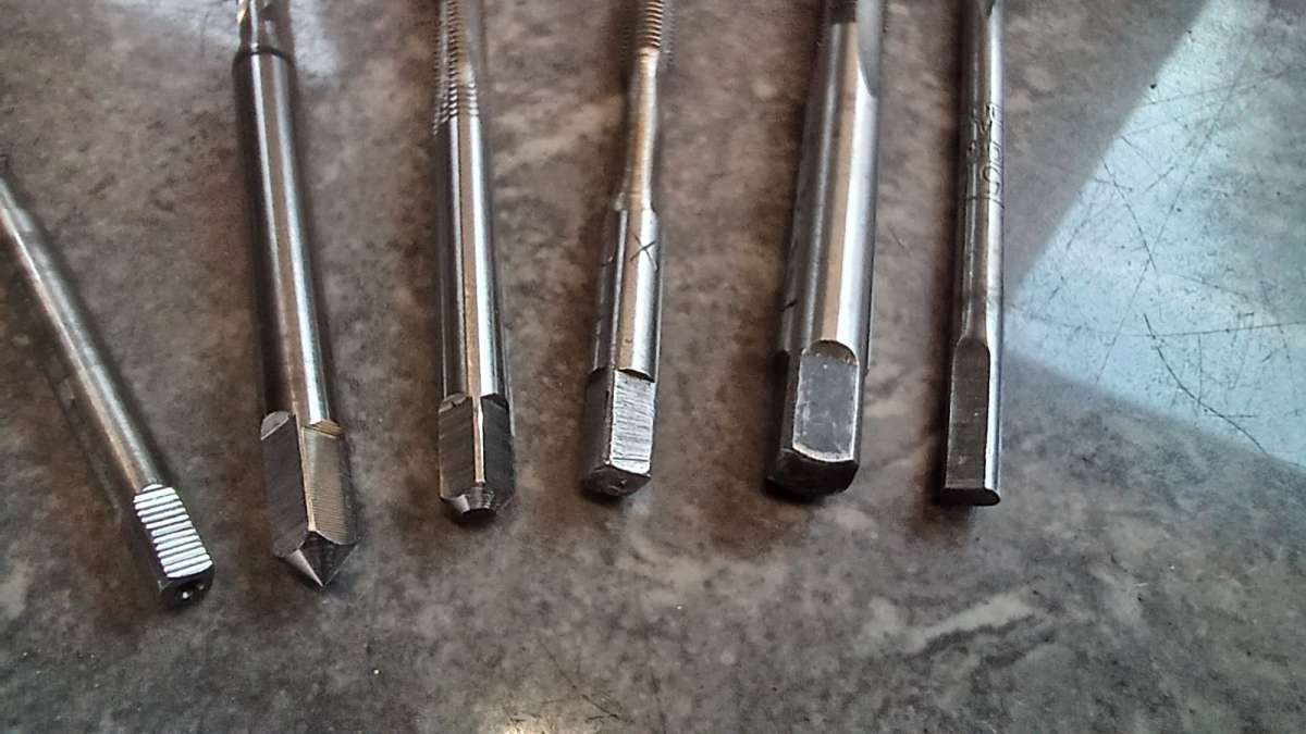

                  #762552
                    Dave, machine taps have square ends with a mix of points, chamfer sor just the edges eased, That is a machine tap in my photo. That is why they make special collets for them with a square hole at the end to ensure they do not slip and lose registration with the spindle when “rigid tapping”
                    I thought there may be comments about the end of taps so took this when I went back into the workshop, quite a range of ends and all will locate with that simple bit of silver steel. I think I must have used the two that I have for over 50 engines.
                    20241102_104039

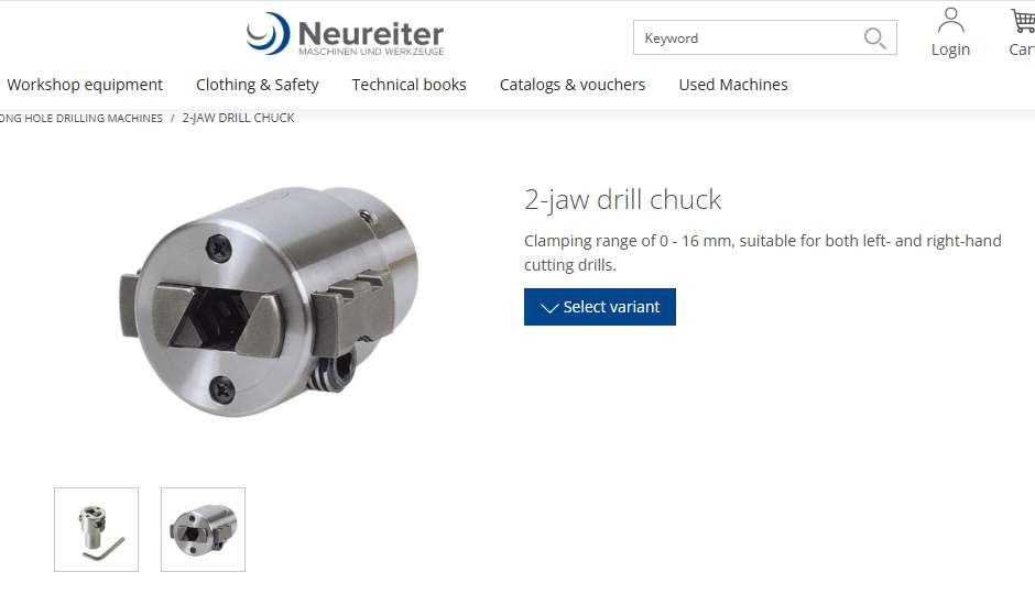

                          Also I find the old Crown style 2 jaw chucks give a good grip on taps; I’ve yet to find one, but apparently they are also available to take square bars/shanks; They are still in production, at a price, though not common; mine are likely older than me. Unlike many keyless drill chucks, they are fine anti-clockwise
                          image_2024-11-02_135040197
                          Maybe also a Morse tapered ER collet chuck, or even a keyless drill chuck intended for battery hand drills, as they work in both directions, and seem to have a finer thread behind the jaws, which gives a tighter grip.

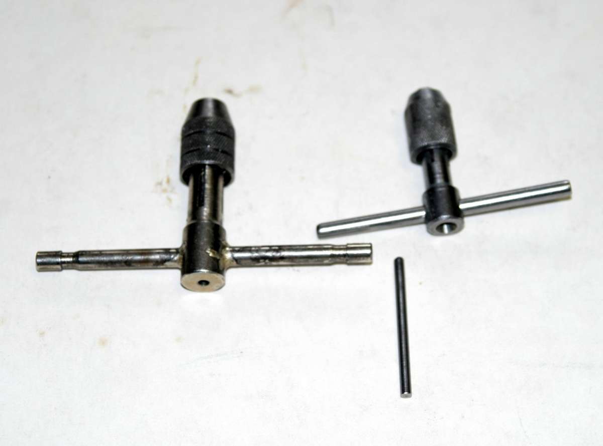

                            #762606
                            John Purdy
                              @johnpurdy78347
                              This is what I use. Standard “T” handle tap wrench modified by removing the handle and any dedent ball and spring then silver soldering the handle back in and drilling an 1/8″ hole up through the body. The tap is chucked in the holder and the short 1/8″ rod is held in the tail stock chuck ( or the milling machine chuck) and the tap wrench is slid on to it, thus ensuring that the tap is aligned with the hole in the work. The larger one will hold taps up to 1/4″ the smaller one #0 up to #10 (.060″ – 3/16″). The smaller one was bought in Woolworth’s 5 and 10 back in the mid ’50s when I was a very young teenager, probably for about 5 cents and is still going strong!
                              Tap Wrenchs

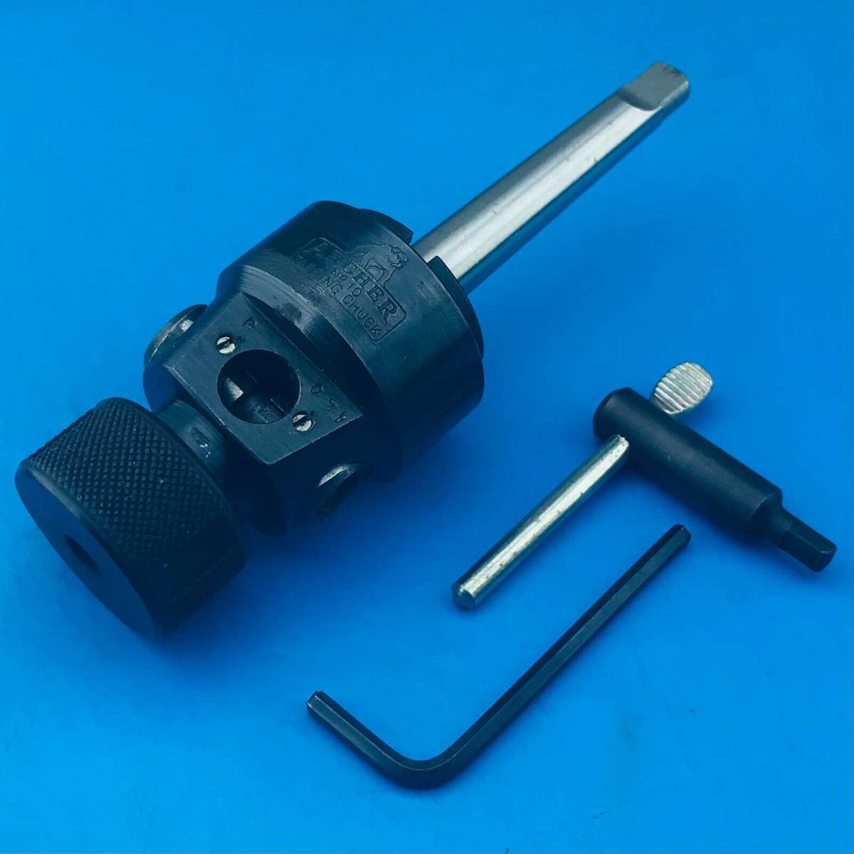

                                          #763398
                                          Ex contributor
                                            @mgnbuk
                                            The “Archer” tapping chuck has separtate adjustments for centering the tap shank & gripping the drive square plus, maybe, a friction overload clutch.
                                            s-l1600
                                            The front knurled nut is a 3 jaw collet that doesn’t drive the tap, just centres it – the cone under the nut that the collet jaws run in is a steep taper to give rapid size adjustment but no gripping power. The two cylinders nearer the shank ( prevented from rotating by the two small screws running in slots in the cylinders, but free to slide side-to-side ) slide in a common cross bore & are joined by a stud threaded LH one side & RH the other & using the square ended key in the stud adjusts the gap between the cylinders to grip the square. The collar with a notch just below the shank has 4 slots across it’s face & I think this is the friction overload clutch force setting ring.
                                            On the rather scabby example I have this adjuster ring has proved impossible to move with a C spanner, but shows damage to the edges of the slots suggesting it has been hammered up very tight. (the picture above came from an Ebay listing & isn’t of my chuck). Mine ia also larger & on a 2MT shank, with the jaws applicable to maybe M6-M10 size range taps.
