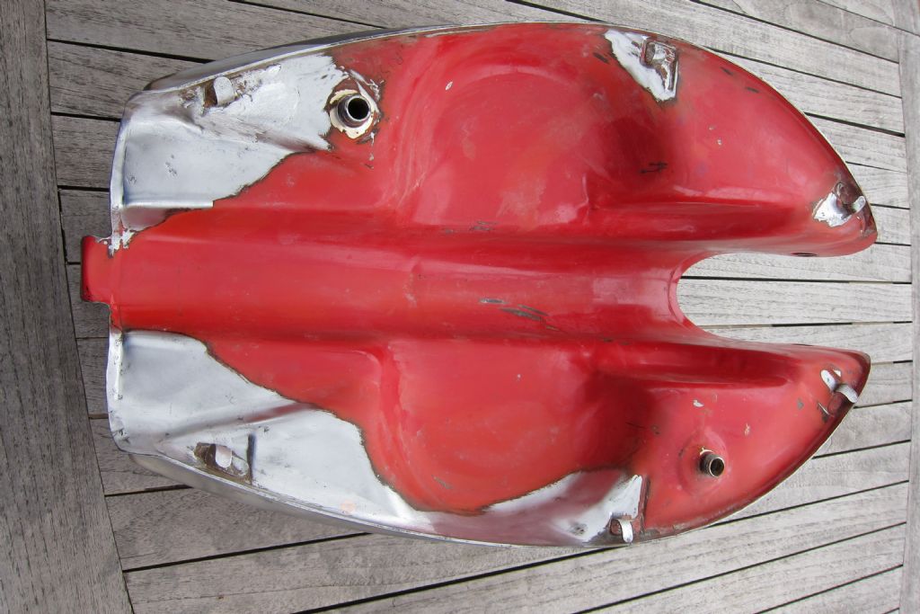

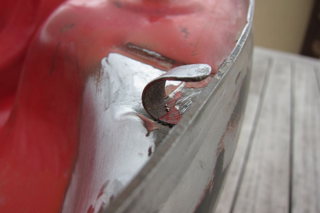

      Good afternoon everybody,
      I am restoring my bike and would like to have your opinion about the best way to treat the six small metal tabs fixing the plastic chrome trim along the lower end of the tank:
      I'm afraid to snap some of them while opening again and bending, because of work hardening of the metal (I don't know how many times this has been done before, I bought the bike second hand 35 years ago). I understand that I could anyway glue the trim on the edge, but I would like to handle this in the best possible way and, in general, know how to treat similar problems.
      What do you think is the best way: heating the tabs while reopening (I can use a small oxy-gas torch I own), annealing them in some way etc…?
      Thanks,
      Massimo

              If I were worried about them snapping at the welded joint, I would clean the joint up well, use active acid flux an put a good dollop of soft solder in the joint. I doubt the tab would break, more likely the weld joint.
              BobH
              #285020
                First be sure you have every trace of petrol out of the tank.
                Normalising them by heating to red and then withdrawing the torch very, very slowly should be enough to prevent them cracking.
