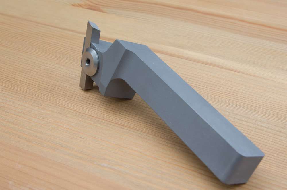

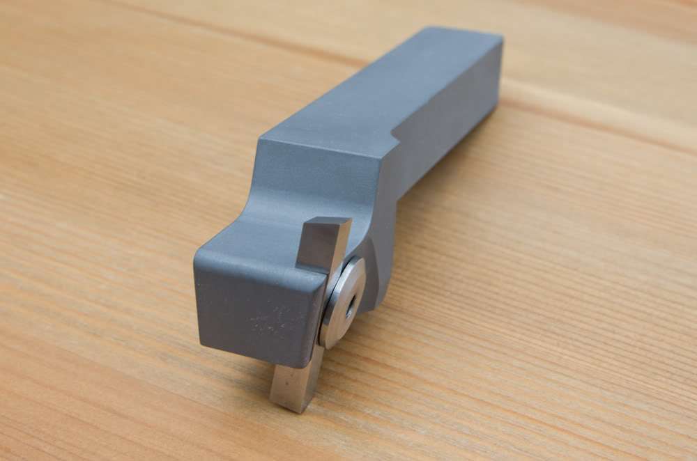

        l also want a tangential cutter but so far I couldn’t decide if to order one or to try to make it myself.
        #731273
        Thor 🇳🇴
          @thor
          Not difficult to make, I have made two, one for my small lathe and another for my slightly larger lathe. The are use a lot.
          https://b56b541582.cbaul-cdnwnd.com/15a4602be4074f1b8217350ccf583f6b/200000026-83350852aa/TangToolholder.pdf
          Thor

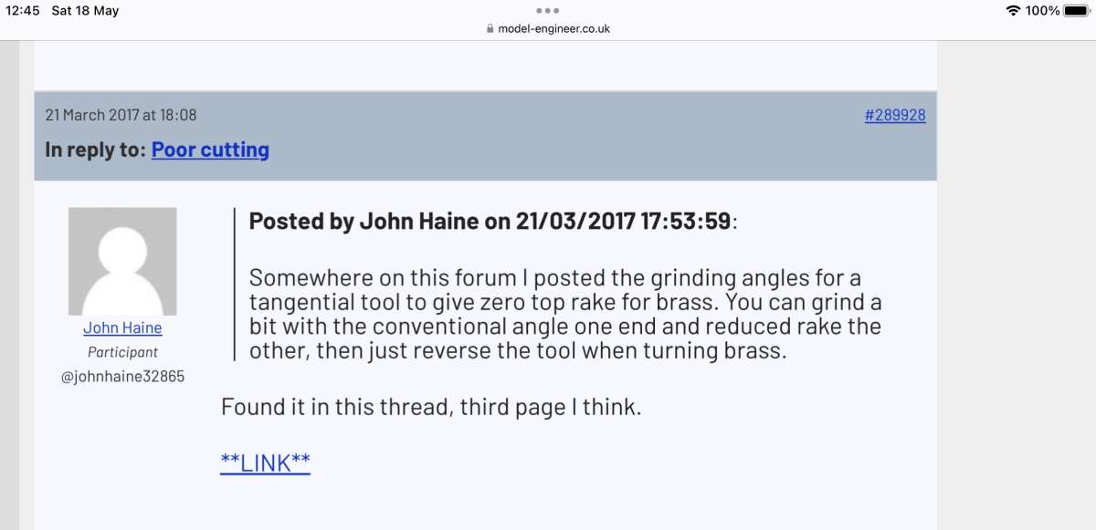

          John Haine
            @johnhaine32865
            In the “old” forum somewhere I posted how to calculate the grinding angles to get a required top rake given the fixed “lean” of the tool given by the holder.  However the site search can’t find it!
            #731322
              IMG_9657
              John is clearly correct, on both counts … the **LINK** returns the dreaded LEGO blocks.

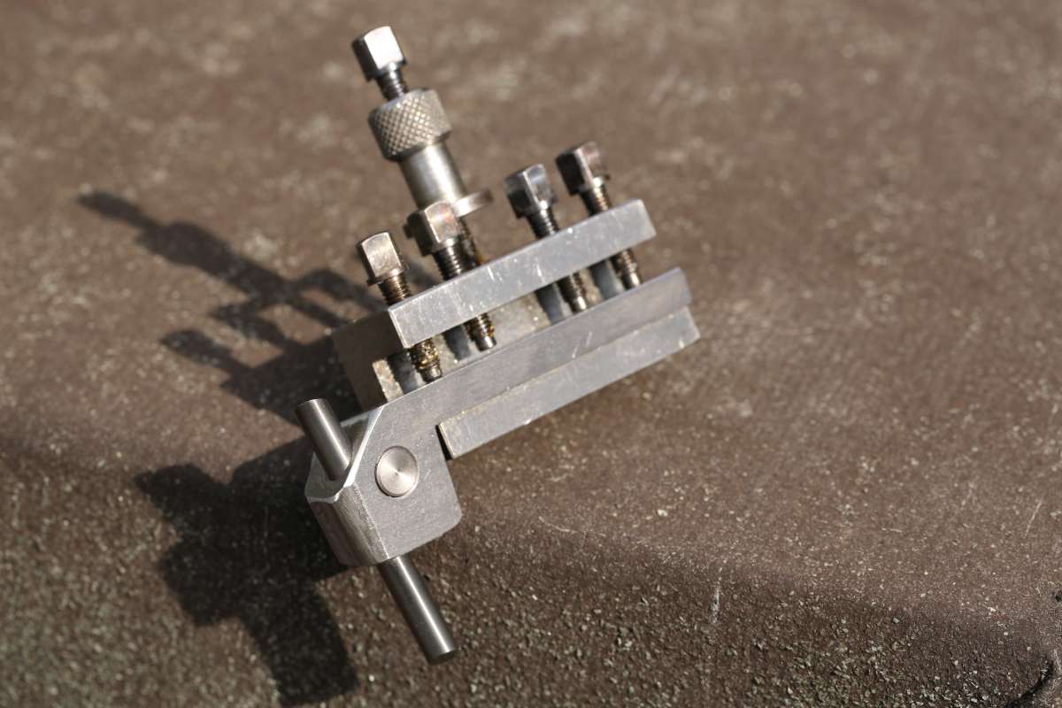

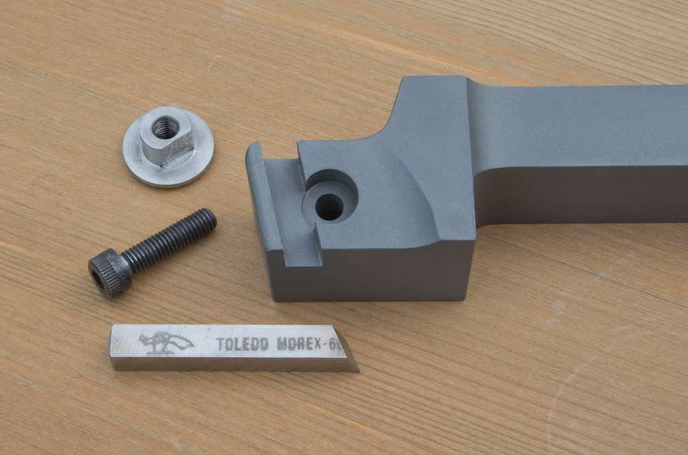

              Vic
                @vic
                They are easy to make, this is mine.
                IMG_1297IMG_1296IMG_1298

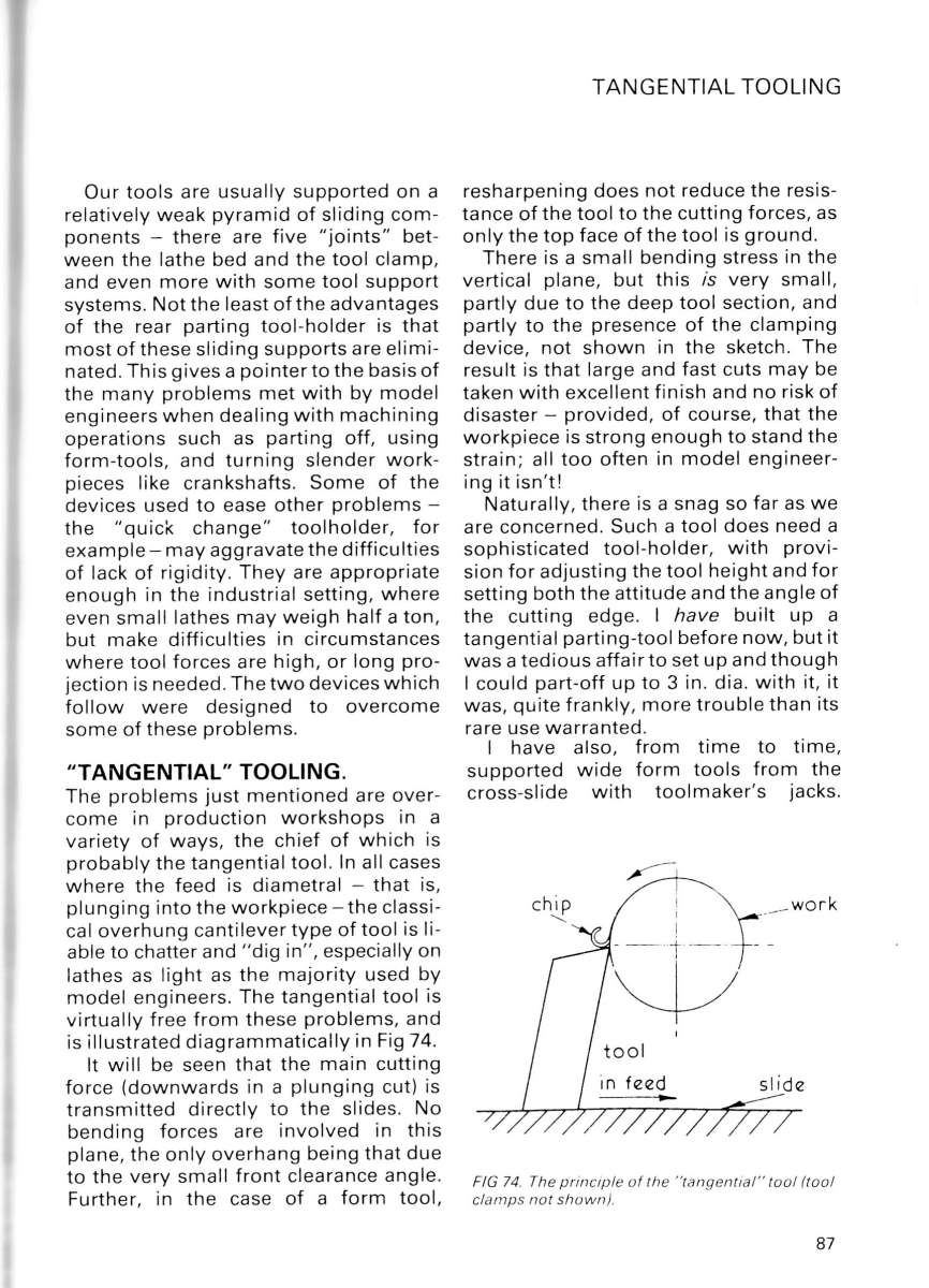

                  Andrew Tinsley
                    @andrewtinsley63637
                    Interesting that GHT mentions tangential tooling in his Workshop Manual. He was pretty disparaging about them, yet lots of members here think they are great.  If I remember correctly (and maybe not!), GHT didn’t like the fiddling with the set up which took time to get it right.
                    GHT was usually spot on with his comments, perhaps this time he was wrong?
                    Andrew.

                      I use mine a lot. I also have a bought one which takes round tool bits as well. Loaded with old broken carbide end mills, suitably sharpened, it can tackle many jobs.
                      I wonder what GHT means exactly by “set up”?
                      The best design of Tangential tool holder is the type where you flip it upside down on a flat surface to set the bit height. I didn’t think of this when I made mine so I use a height setting post instead.

                                Vic
                                  @vic
                                  On bernard towers Said:
                                  surely flipping it upside down doesnt give centre height but puts the tool tip at the same height as the holder? that doesn’t necessarily put it at the correct height for the lathe.
                                  Well it does if it’s made to suit the lathe. As I said, I didn’t think of this when I made mine but I’ve seen others make them.
                                  To be honest though, tangential tools are great for four way tool posts as they have their own height adjustment.

                                    Sonic Escape
                                      @sonicescape38234
                                      The tool holder looks very nice! Is it painted? But I don’t think this model is easy to make. At least not by me.

                                        #731449
                                          Andrew.
                                          What exactly does he say?  My copy of George Thomas’s Workshop Manual has gone AWOL.
                                          I’ve never used one, but loads of people rate them highly.   I think the advantage is they deskill tool-grinding, making it easy to keep an HSS cutter in good order.   Chaps who have the knack of grinding HSS often assume everyone else will find it easy too, which ain’t so!  Cack-handed types like me would definitely benefit from tangential grinding simplicity, though I actually prefer carbide inserts supplemented by painfully bodged conventional HSS grinds.  Though my results aren’t pretty or quick, they work well enough.
                                          The disadvantage of tangential cutters is they only do one type of cut, though this is probably by far the most common.
                                          My guess is someone as experienced and skilled as GHT wouldn’t get much benefit from a tangential holder because he could quickly grind whatever he needed for optimum results in all circumstances.  But unskilled and semi-skilled grinders would save a lot of time and bother by using them – a way of getting good results from HSS with less fuss.

                                            Roderick Jenkins
                                              @roderickjenkins93242
                                              I can’t find any reference to tangential tooling in the indices of either GHT’s Workshop Techniques or Workshop Manual.  Tubal Cain mentions them in his Simple Workshop Devices:
                                              tc tangential tooling
                                              Possibly, long before Eccentric Engineering made their version, GHT was referring to the type described by TC which rests on the bed of the cross slide and, as TC mentions, is very awkward to set up.

                                              Paul Kemp
                                                @paulkemp46892
                                                Rod,
                                                That fig 74 makes perfect sense, removes tool post, potentially top slide and puts the tooling force close to vertical on the cross slide.  However that is a long way removed from having a tool holder in the tool post holding the tool in the same attitude.  I have used the screw jack dodge to good effect on tools with unavoidably long overhang.  Adding that feature to the tangential tool holders shown by others on here may be a useful compromise in adding rigidity and show a tangible result over and above the advantage of a simple grind.
                                                Paul.

                                                Vic
                                                  @vic
                                                  On Sonic Escape Said:
                                                  It’s just sandblasted, then given a coat of wax to help prevent rusting.
