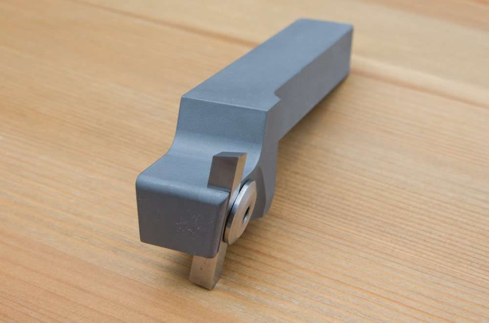

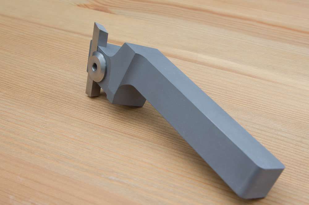

                                      Posting for inspiration, many seem to have liked it in the past. Sorry no drawings, I made it up as I went along.

                                        I remember those pictures from earlier postings and they look good, In think the only dimensions/data is that its 12deg leaning away from the operator and 12deg towards the headstock. The trest is up to you shank size etc.
                                        #791888
                                        Vic
                                          @vic
                                          Yes, you can make it any shape or size to suit as long as you use those angles, or something close to it. I’m not sure where I learned about the angles but it seems to work well enough.
                                          If someone’s tried something different I’d be interested to know.

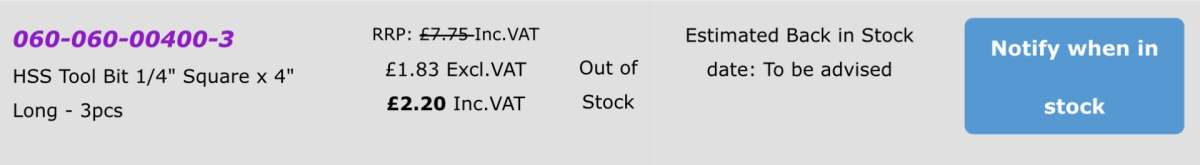

                                                      On Hollowpoint Said:
                                                      With the price of carbide tipped tools now so low are these still worthwhile?
                                                      I’m not dismissing them just asking.
                                                      At £2.20 this could almost represent a lifetime supply for many people, certainly hundreds of cutting edges. Most of the small bits of HSS I’ve used in mine were free, given to me because they weren’t much use for anything else.
                                                      I also use mine to cut sharp corner on jobs. Also good for plastics etc.
