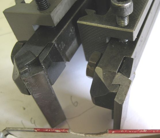

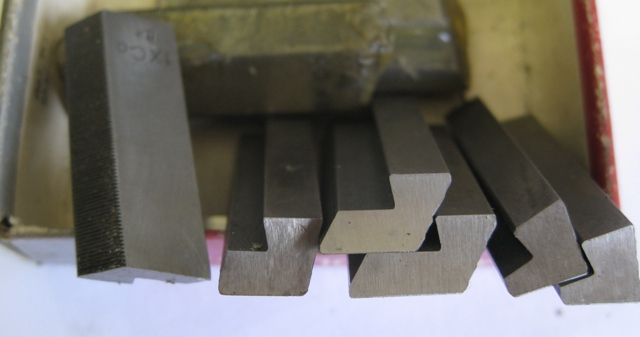

                                Maybe more pricey than the simple square HSS tangential bar holder, but these work very well, solid grip of the cutter- cutter cannot slip during interrupted cuts, and can cut right up to the shoulder/chuck, etc. The cutter and holder has a serrated or knurled section that prevents cutter slip downwards.
                                10 cutters have lasted me more than 20 years…
                                These are some of the cutter shapes – Thread cutting shapes also available.

                                Holders with cutters in place:

                                      Interesting tool holder Joseph. I wonder if you can still get those toolbits though and at what price?! smiley
                                      #364687
                                      Joseph Noci 1
                                        @josephnoci1
                                        Vic, the inserts are quite expensive – I recently purchased some thread profiled inserts for these holders and they were around 60Euro each – From Hoffman tooling in Germany. But, as I say, these last a very long time – very quick and easy to sharpen, and you taken just a smidgen off in the process. The threading inserts were a Komet product.
                                        The length of the insert rear edge – where the clamp bites – is serrated – likewise the clamp, so they grip with no slip, sometimes a problem with the simpler clamped square bar in heavier or interrupted cuts. You can just see the serrations on the upper part of the left hand insert in the first image I pasted. I have six unused inserts left from 10 purchased 22 years ago..and I do use these a lot – they give a very nice finish.
