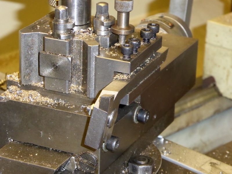

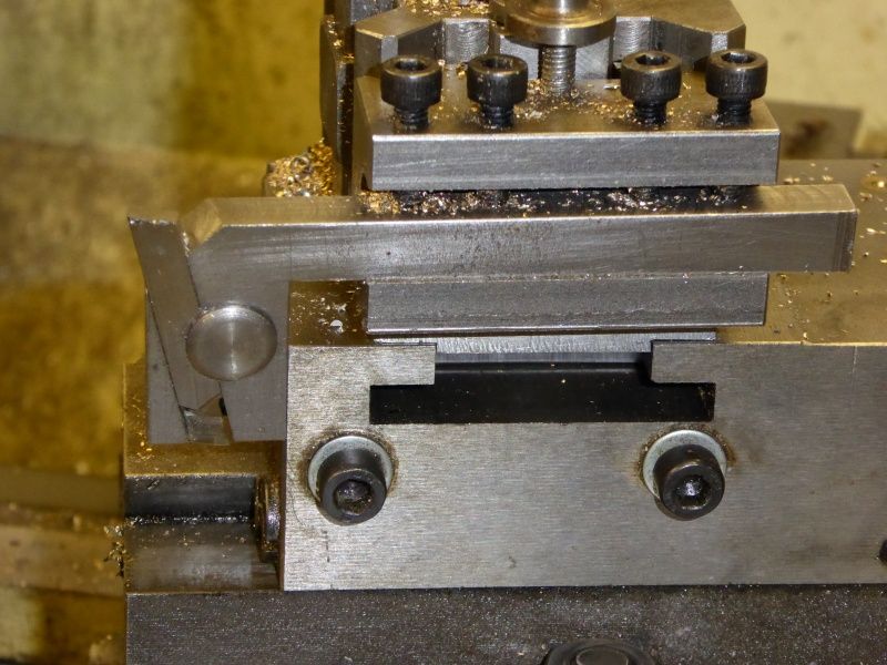

      Hi Clive,
      I don't have a drawing as I milled it as I went along! As for the steel, I have no idea. It was made from bench (gym) machine weights that were going for scrap. Definitely steel though of some description. Sorry I can't be of more help. blush

              Vic, very nice tool, looks the business! Just one query, was there a reason you made the bit where the HS tool bit is held thicker than the rest, or did it just come out like that?
              Chris
              #162145
              Vic
                @vic
                Only because it ends up thinner at the end where it's milled at 12°. It can be the same thickness all the way through though if you like. I started with quite a large lump of scrap steel so I needed to thin it a bit for the toolpost. The reason for the deep step was to keep the toolbit clear of swarf, it also help to see what's happening at the cutting edge. Really though it's just a matter of making it to fit your Lathe. Within reason though bigger is better if it improves rigidity. If I get a minute I'll take some more pictures at different angles if it helps. It's not quite as clean now though as it's had a lot of use, it's my most used tool!

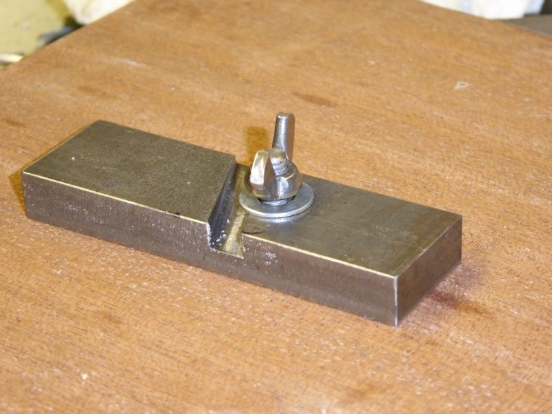

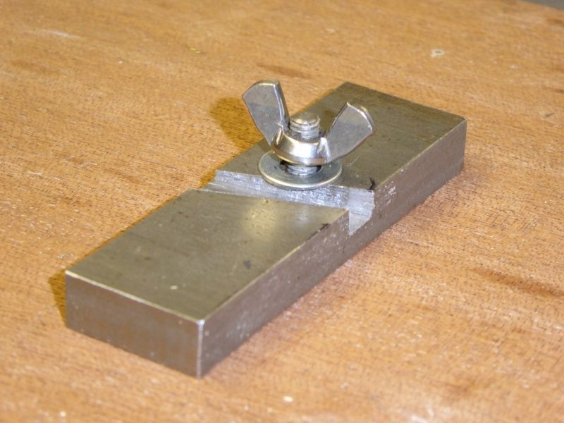

                          I've made several holders for 1/4" tool bits based on Michael Cox's MEW article, for me and some friends. I designed a slightly different sharpening jig to those shown so far; it works just fine and needs a smaller chunk of metal.
                          Here are a few pictures, plus the design of the jig.
                          Tangential jig

                            As requested, a few more pics.

                              Sharpening jig. The small black one comes with the commercial tool. I made the alloy one as being a bit bigger I find it easier to handle and it's slotted to the table on my belt sander for consistency.
