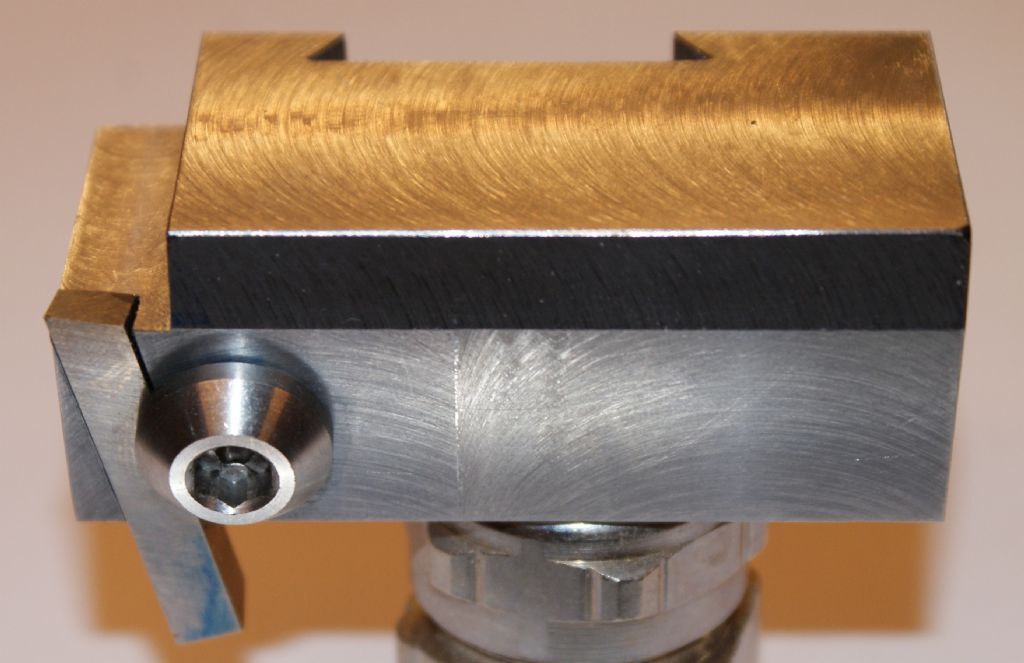

      I just finished my version of tangential toolholder for my homemade QCTP:

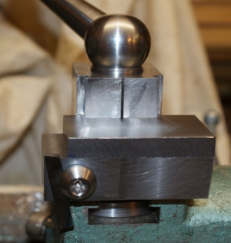

      And here it is on the QCTP:
      And it woorks beautifully!

        Well done Sverre. Hope you will not mind me pointing out that I think you will find some limitations with your tool due to the very prominent tool bit fixing screw head. From the photo it looks as though the head will foul the first shoulder it comes up against – well before the tool point gets there
        This is a problem that is quite difficult to overcome in this design which is why I approached it from a different direction in my version earlier on in the thread.

          Hello Rik;
          Yes – I know! I just wanted to get a quick way of trying out a tangential toolholder. The big screw holds the toolbit firmly, but limits the diameter for facing to about 20 mm.
          I'll have to finish the holder for grinding the toolbit, thought I would make a jig for grinding it on my new Worksharp 3000 (mostly for sharpening woodworking tools), but will give a very nice sharp edge.

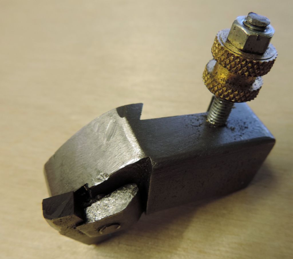

            This is mine.
            #160644
            _Paul_
              @_paul_
              Very nice tool Vic what's it made from or is the grey colour some kind of heat treatment?
              #160653
                Posted by _Paul_ on 14/08/2014 01:52:27:
                Paul,
                I may be wrong, but I suspect it's made from "Ones and Zeroes"
                … Whether I'm right or wrong; it's a lovely job, Vic.

                          No, it's the real deal, I made it from some unknown steel but you're right, it's been sandblasted. Here's another pic of it with some other stuff I made.

                                Thanks Norman! Couple more pics, how it started out:
                                Clamp setup.
