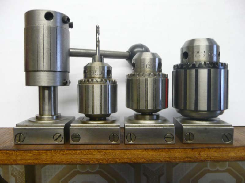

Photo 1 shows my Atlas turret and the potential for conflict with the rear toolpost. (The plain shank at two o'clock supports my Vertex tapping chuck when in use).

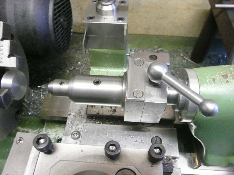

Photo 2 is of the JAR tool with centre drill in extended holder on the Myford. On the shelf above the lathe (photo 3) are some additional holders. From the left, the plain shank takes a die holder and the Vertex, and the short pilot drill second from left can follow up the centre drill without the need to move the tailstock. The additional drill chucks can stand ready with tapping, clearance size drills, etc.
The tool consists of an MT shank with short vertical male dovetail onto which are mounted the various holders via a corresponding female dovetail, the vertical location being set by the screwed-on stops visible in photo 3. In use the small ball handle is rotated one turn releasing the holder which is then lifted away, replaced by another and the handle again locked.
