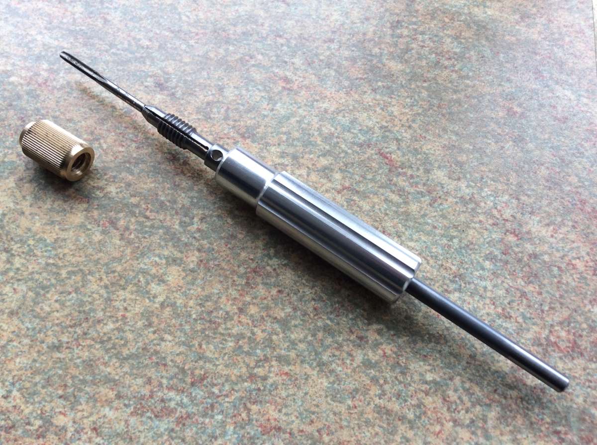

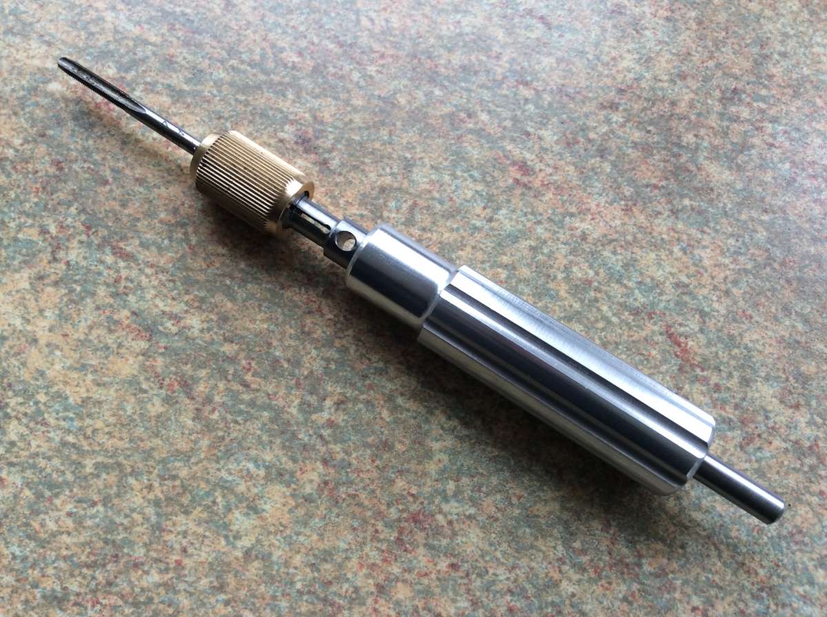

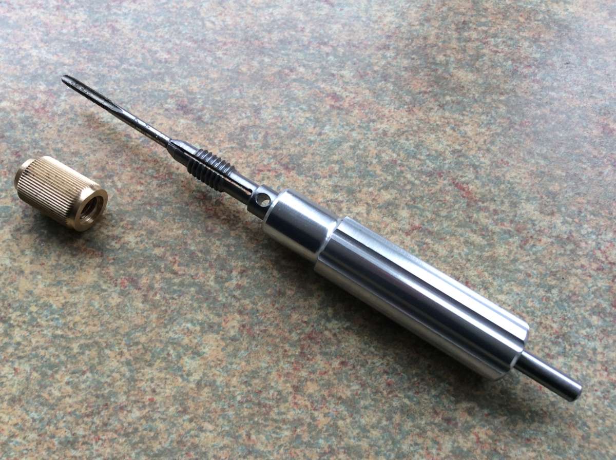

                      As in your first post Bill I have a couple of those and have stripped one to make a couple more and they do what is says on the tin. I have just recently made one for small taps which is gripped by hand and let slip at will, not near the workshop at the moment but will post photo later. Of course there is the option of a Vertex type tap chuck!

                        For very small taps you can always use eclipse pin chucks as they have 4 jaws, if you put a piece of rod in the tailstock chuck that fits inside the pin chuck this will keep it in alignment then you grip on the chuck makes it do the threading. Pictures of the recent one for taps up to 1/4″IMG_3546IMG_3545IMG_3548

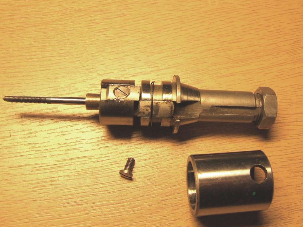

                          I’ve never thought of tapping with mag drill; as stated I suspect it would be less than satisfactory. When I drill the holes to mount my cylinder on the boiler I will use the mag drill to drill the holes, but tap by hand.
                          I don’t power tap in the centre lathe, I just start by hand with the tap in a drill chuck and finish by hand if required. On the repetition lathe I always tap under power, mostly with spiral flute taps. The tap is rigidly held in a collar that then fits into a holder with a dog clutch:
                          Tap_Threading
                          When the holder reaches a set axial limit the tap stops rotating. Reversing the lathe engages the dog clutch in reverse, so the tap reverses out. Works very well and is fast, a few seconds at 500rpm.

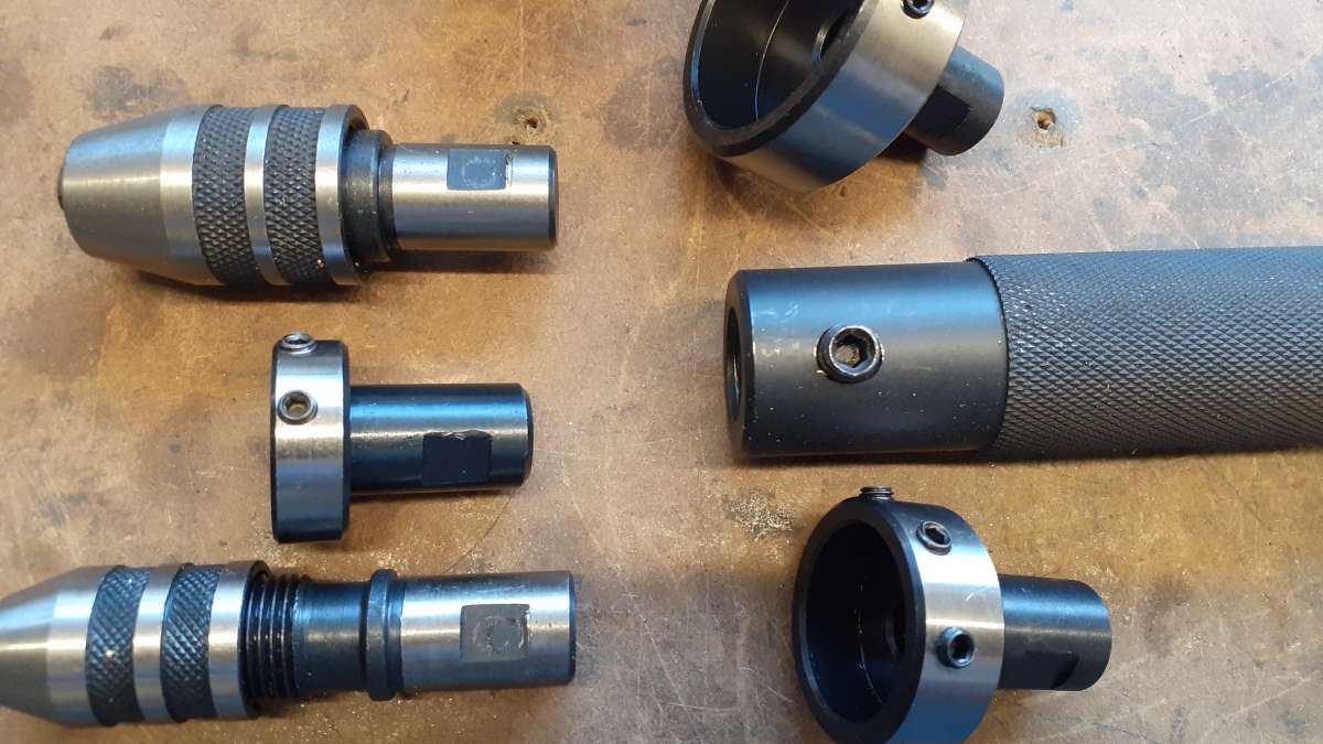

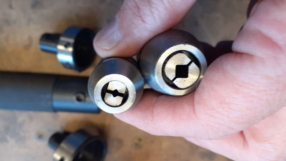

                            Bernard, is this what you mean by the Vertex tapping chuck? Or this one? How do they hold the tap exactly?
                            #723187
                              A nice man from ARC sent it to me for my opinion, I said it was no good and he said I did not want it back. Actually it is nicely made but there were a couple of points that made us decide it was best not to stock it, I have since seen them available elsewhere.
                              It is the same body as the die holders fit into but they all have quite a small diameter spigot. The chucks are like those you find on the tee handle wrenches with two jaws that have the Vee in them. I expect one of these chucks could be cut down and silver soldered onto a suitable disc to fit an existing tailstock die holder.
                              I don’t really use it much but its quick if you have a small batch of nuts or similar to make.

                                Bill its the first one they hold the tap similar to a tapping head which has 3 jaws at the front to keep the tap central and two jaws at the rear for driving the square.
