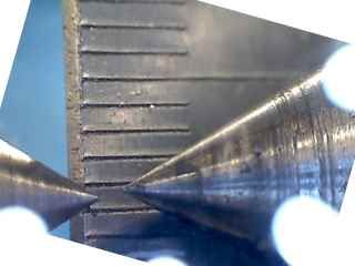

      Doubting my figures I took the following pictures with a USB microscope – I had to rotate it in the computer to make it easier to measure.
      The rule behind is in 1mm increments and measuring the relative heights I get the tailstock centre to be .6mm above the headstock one.
      In some ways this doesn't surprise me since, even when I have the tailstock aligned quite well horizontally, there is a noticeable wander at first when a centre drill is used and there is some scraping (on what appeared to be the top of the hole) when it is withdrawn.
      First of all – does this make sense from a measurement perspective – it seems to hang together, but I could be missing something.

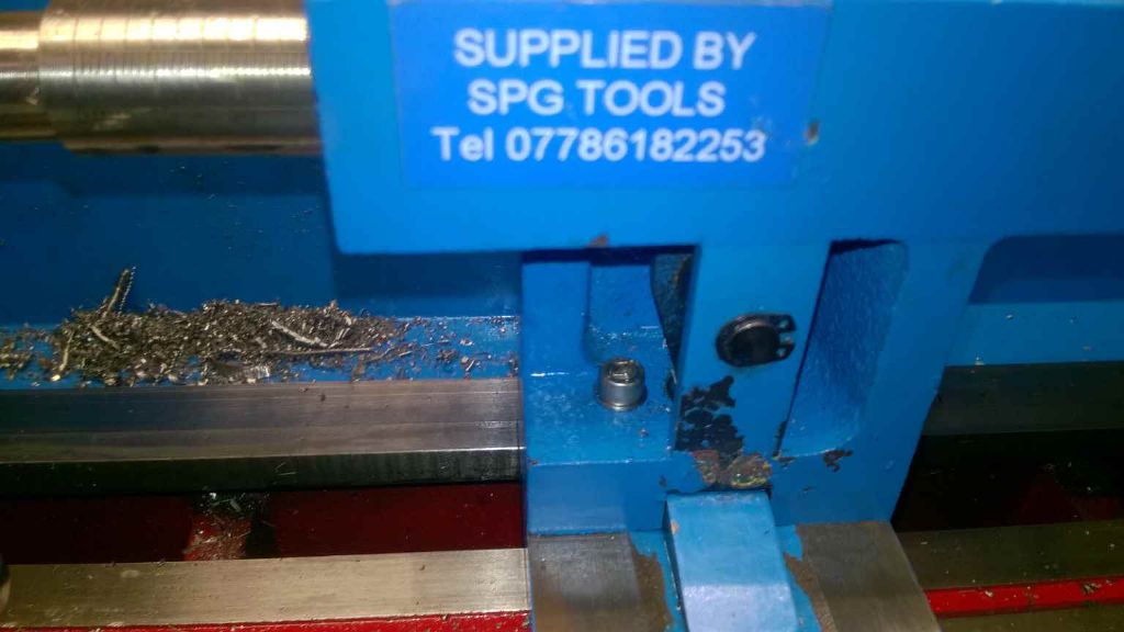

      I would mill the top surface of the base (as seen in the photo below) which should be relatively safe, though I may need to take a little of the channel that sits on it too, I would imagine that the base is available as a spare if I mess it up.

            Iain,
            Nicely documented.
            To answer your question: Yes, I think you should worry.
            BUT; before you start modifying the tailstock, please check that the headstock spindle is correctly aligned with the bed.
            If all's well with the headstock alignment, then check the tailstock details for paint and burrs. … Many of these mis-alignments are down to poor assembly, and your 'fitting' may [with luck] only be a matter of tidying things up.

              Michael – The headstock is out by about 10 thou over a 200mm (measured at 10mm and 210mm) range from the chuck. This is based on measurements using 'Rollie's Dad's Method'.
              True this wasn't measured at the same time as the tailstock but I hope that it's not shifted too far.
              That would amount to maybe 3 thou (.075 mm) over the distance the dial test indicator was measuring – quite a long way short of the error..
              The tailstock is recently re-assembled after I built the tailstock adjuster. I did take care to clean paint off and make sure there was no swarf. Also the centre drill wandering and appearing to scrape has been there for a while.
              Martin. I'm happy to look at alternative methods of material removal, but I have no real idea what I could do. sanding or scraping would take a long time and both would be subject to challenges in regaining a flat, parallel surface.
              The barrel is quite level, certainly within 1 thou over the distance it is extended (about 75mm). It's relatively hard to be more exact as the engravings move the dial indicator around quite a bit.

                I think you should check contact surfaces with some engineer's blue. A small high spot of 0.3mm may be doubled to 0.6mm at the point of the centre if it causes any angular error in the tailstock. These are not unreasonable amounts of material to remove with a file. Use of blue will let you see where there are high spots where material should be removed to maintain flatness. For this small error a milling operation may be a bit of "sledgehammer to crack a nut".
                Martin

                              Martin, I have some blue and some scrapers and will take a look.

                                                I snuck out for 10 minutes to try and check the height with the test bar I made.
                                                That showed the tailstock was 0.23 mm higher than the headstock – 9 thou which is more or less what I understand is normal for a lathe of this type (5 to 10 thou is what I've read in other posts).
                                                The measurement is repeatable if I reverse the test bar and there is negligible deviation when rotating the spindle (carefully).
                                                This is much less than the measurement against the barrel indicated – apparently you can have better aligment with bad results when checking against the barrel, John…
                                                What's a bit confusing is that the lathe is in the same state as when I took the pictures at the weekend. The tail stock barrel is exactly as far out and I've made no adjustments. It's hard to convince myself that the picture is 0.25mm . So unless the bed is moving uphill it's hard to explain. And I'm not even sure that makes sense.

                                                  It was an excellent idea to use your USB microscope to illustrate the problem … but I think there are some inevitable optical effects in this image, which will make measurements difficult.
                                                  I am happy to discuss this, either by PM, or in the thread [depending whether you consider it relevant to the main discussion].

                                                    It can be Parallax, the focus of the image plane is quite critical to evade it.
