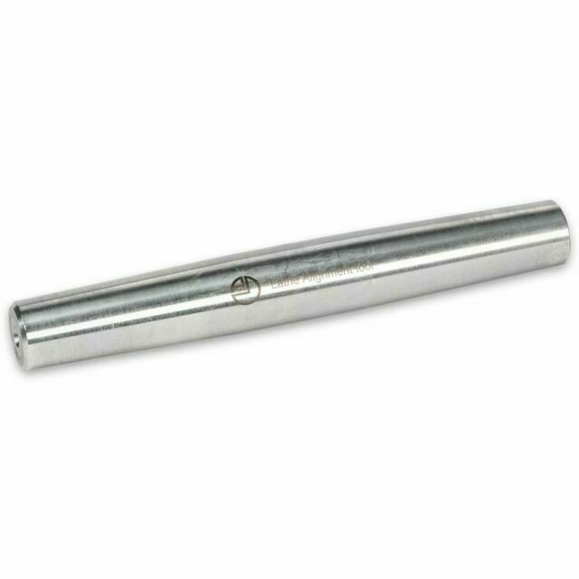

      Be gentle with me here! I am new to lathe issues and have only schoolboy experience and a dollop of common sense (I hope! Ha ha).
      I have just got to the end of a comprehensive refurb of my old Myford ML7 which I purchased a few years ago to find it was so badly worn it was virtually unusable past the most basic of work. The bed was badly worn (you couldnt set the carriage to take up the slack at the head-stock then get full travel of the bed) the bearings had so play in them, it sounded like a dull buzz saw whenever there was any appreciable load on the cutting tool and parting off, well things really got loud!
      Anyways, hindsight is a wonderful thing and now looking back I would have been better off junking the thing and buying an existing better set up with what I had learnt! But yep, I went the hard route (but learning loads along the way) and as this is starting to get long really quick, let me get to the point…
      As I have had the headstock cradle off and re-scrapped the bearings, I now am at the stage where I need to ensure I have correct alignment. Watching the various videos etc, I am looking at MT2 test bar to set up the alignment of the headstock. Trouble is, the MT2 test bars are pretty expensive for a one-off measurement. I have also watched the videos on taking out the twist on the bed as well.
      During my hours of googling, I came across a double taper bar for setting up the alignment of the tailstock to the headstock for WOOD lathes. Being a double taper I wondered why this same system wouldnt work on a ML-7? It just seems an incredibly easy way in which to ensure that the two correctly align to each other once tailstock is set? They are also reasonably priced too.
      Your thoughts?

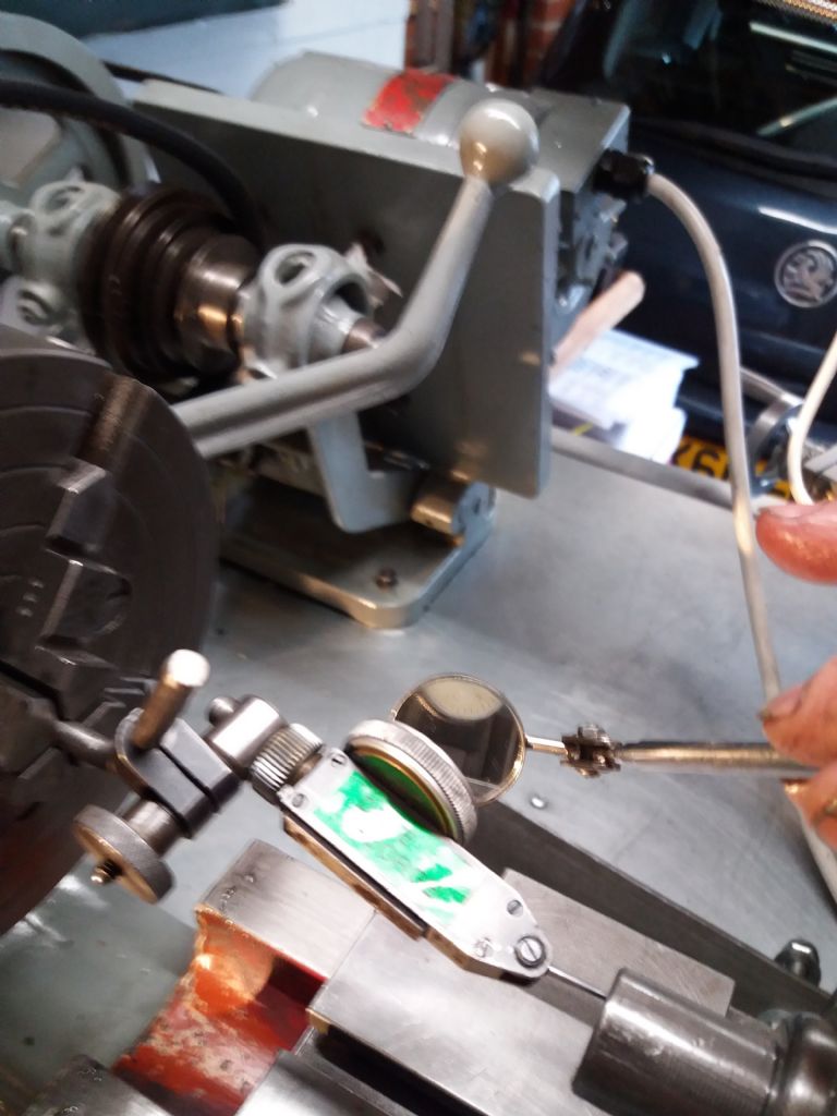

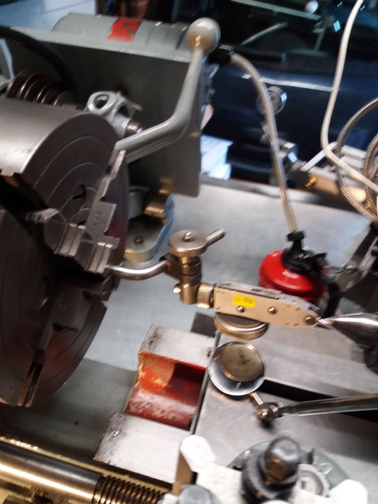

          Hi Bruce you don't have to have a bar to check the alignment of the tail stock. I have a short length of silver steel with a bend in and mount that in the main chuck. I put the dial indicator on to that and as you rotate the chuck with the indicator in contact you can see any out of alignment.
          I hope this helps. I had previously set the main spindle to cut parallel by checking a piece of 20 mm silver steel 12 inch long, held in the chuck, clocking it with the carriage and further cutting a piece of steel parallel.
          David

            That is ingenious.
            John.

                  A proper test bar is more useful as it not only has a MT2 to get the tailstock aligned in more than one axis, but the headstock to tailstock between centres. You would not be able to buy much beer for the price of one of these, and it will last longer.
                  **LINK**
