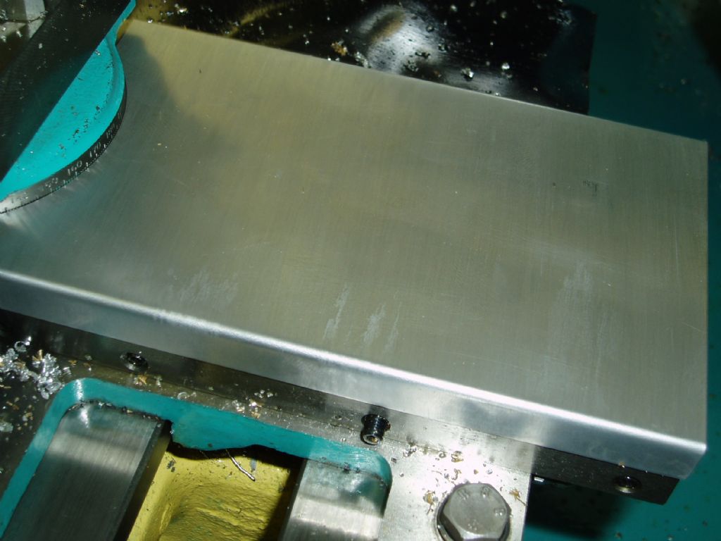

                      Steviegtr
                        @steviegtr
                        Just been making these tonight. Ready to paint tomorrow.
                        Steve.
                        #532698
                        John Baron
                          @johnbaron31275
                          Hi Stevei,
                          Very nice protectors for the mill table ! I'm just about to make some new ones for mine !
                          I've just fitted a set of scales for the DRO on mine and am doing some servicing whilst I'm at it. Surprising what you find when you start stripping a Chinese mill to bits.
                          I'm about to investigate sorting out the quill bearings ! They feel fine in the machine, but quite lumpy with the quill out and turned by hand.
                          Edited By John Baron on 09/03/2021 07:28:48
