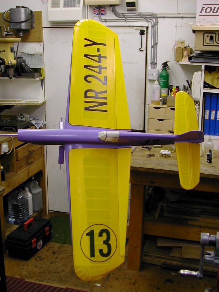

                                                  Yes Mike completely agree – here is an example of cheap skating on my part
                                                  Friday – before clear coating. All masked and sprayed over tissue – no decals

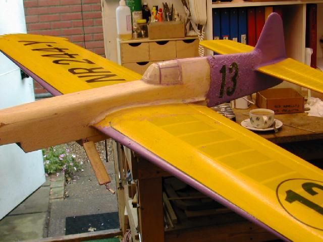

                                                  Monday – after clearcoat went wrong the strip down beginscryingfirst scheme disaster! 04.jpg
                                                  All a result of using the wrong hardener in the two pack clear coat – by choice, trying to save hardener I used the previous batches hardener with another brand of top coat.

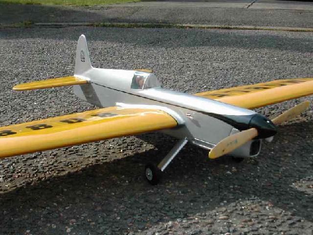

                                                  A lot of work to bring it back to this just for trying to be clever
                                                  Just one example of a few disasters over the years
                                                  As said, "one pays ones money" etc – it all comes down to how much you value the work previously put in I guess.
                                                  Tug
