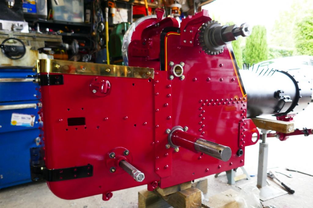

                      I'm only an amateur spray painter and have painted a car with celulose type paint which required a lot of work to get a good finish. Lots of rubbing back between coats and buffing the final coat to get a shine. But it does look good.
                      I've just painted my traction engine with 2 pack paint which is much quicker. The panels were sand blasted and an etch primer applied, followed by a normal 2 pack primer and rubbed back with wet and dry paper. Then 2 colour coats. No clear coat and no final buffing required for a shiny finish. Probably not as good as I achieved with the celulose paint by applying a clear top coat, rubbing it smooth with fine wet and dry and buffing to get a shine but trying to cut and buff around all the rivet heads on my engine would be almost imposible.
                      But as mentioned, you do need to wear the correct PPE because it is cancerous if you breath the fumes. I also did the painting outside.
