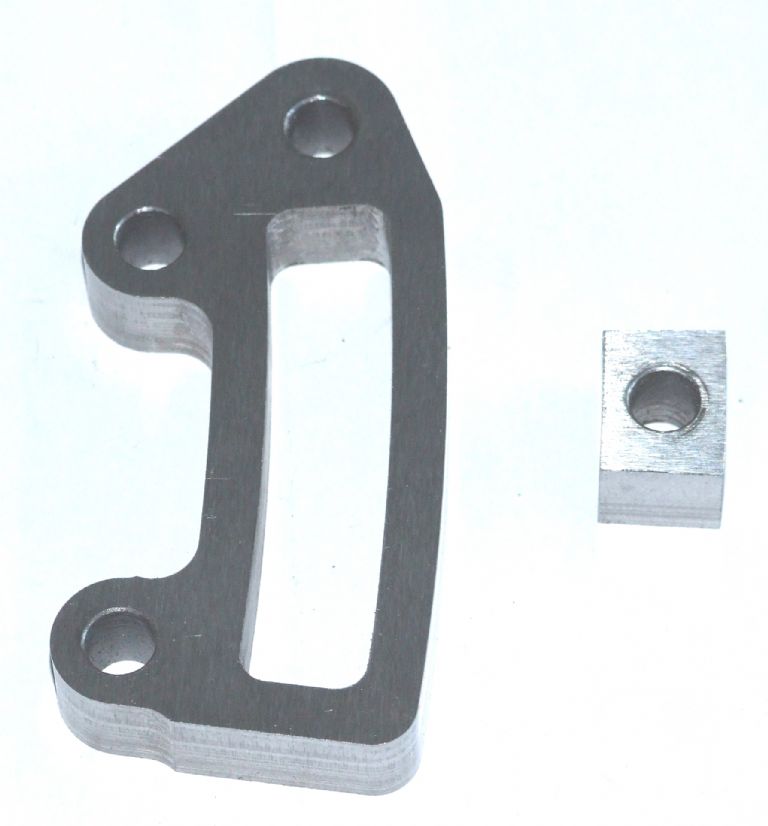

                        Joe: As mentioned earlier in this thread I have a Tormach PCNC1100. As also stated I live near Cambridge, so you are welcome to visit and see the machine. Send me a PM if you're interested.
                        I have cut the gauge plate and cast iron mentioned in my original post, with no problems. Here's an expansion link cut from gauge plate:
                        Expansion Link
                        And here are bevel gears cut in cast iron:
                        Cast Iron Gears

                          Those are lovely looking parts Andrew – and thanks for the offer of a visit – I will gladly take you up on that – PM to follow
