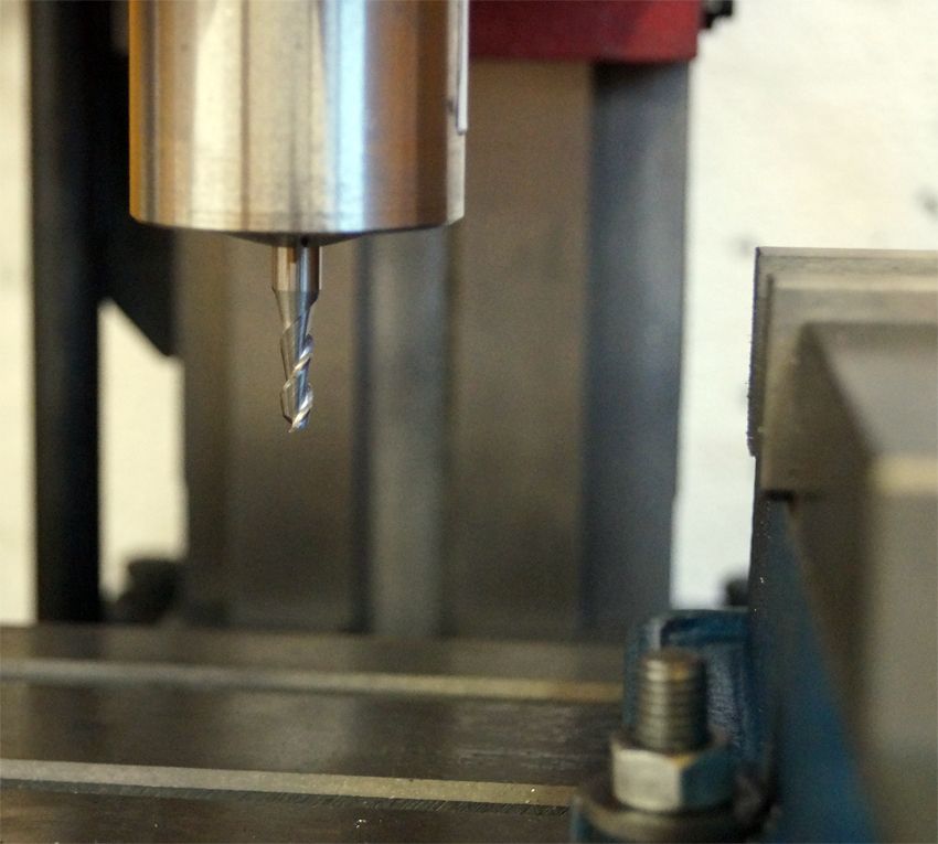

                          Re the loss of head travel with the fitting of the gas strut, I have attached a picture of the head at its lowest position with the gas strut at the end of its stroke. It shows a 4mm std length tool fitted via a finger collet and as you can see its some way above the table, 50mm in fact. A 10mm std tool is 35 mm above and even a 10mm long series would be 15mm above.
                          As I mentioned previously its not a problem if the work piece is vice mounted or packed up from the table plus I would imagine it would be just about ok with a collet chuck. I used the 220-250 strut as recommended which has a 220mm stroke but I see on the SGS website the 6mm struts are also available with a 240, 260 and 300mm stroke.
                          I have only roughed it out in my head but it could be worth having a measure up i.e. head travel top to bottom, mounting positions for the strut top and bottom and required stroke length. It would mean an extension bracket that gives a mounting position above the head but that would be easy to do.
                          Just thought I would mention it in case you would prefer to keep the full travel of the head, I am going to look into changing the strut on mine.

                            Should it be of interest and assuming my calculations are correct a gas strut with a 300mm stroke will give the spindle full travel from top of the column down to the table. It would mean an extension bracket that sits above the head but easy to do.
                            I am going to order a 300mm strut, will let you know how it works out.
