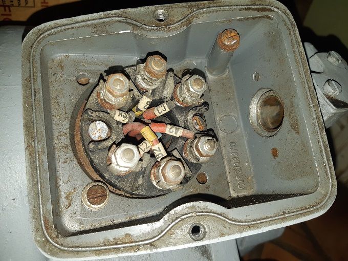

                        The motor you have does appear to be a Bantam motor, the rating plate information , terminal box and winding ID's is exactly as my motor.
                        The very clear DD3 drawing that Andrew linked to show the connection method but with the addition of a shorting out contactor in place of the switch on mine, and a 2nd contactor and overload for the Reverse function, you don't need that if the apron lever is operating the contactor and providing the phases changeover.

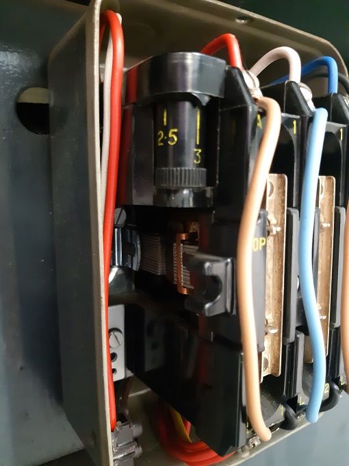

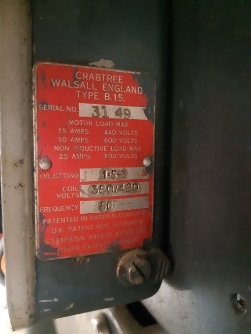

                                          Emgee is kindly staying with the folly, and here are the photos of the box which may contain starter and overload.
                                          You said BD15, so we have a match. Give or take a D.

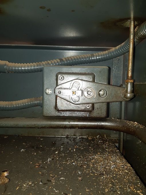

                                            This is the switch which is operated by the lever on the apron

                                                That's good Tom, you only have to buy a switch, best get in touch with your electrician and arrange for him to have a look and order up some materials to do the job for you.
                                                Print copies of the electrical schematics from the manual and the drawing at Andrews link so your man has ll the info needed.
                                                The max setting on the o/load looks to be slightly below full load current but I suggest you turn it to max of the 3 range.
                                                The mechanical linkage operates the 2 phase changing/off switch.
