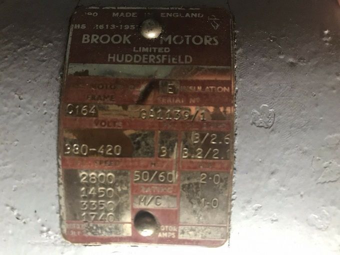

                    Sorry Brian. I ve had a busy 2 days. My motor will be a 2 speed 3 phase motor. But I am replacing a single speed 3 phase motor, so dont have the correct wiring/switch gear for the 2 speed motor. I would like advice as to what to buy and how to connect it.
                    Thanks, Tom.
                    #491390
                    Tom Walker 1
                      @tomwalker1
                      This is the plate off the 2 speed motor.
                      #491391
                      Tom Walker 1
                        @tomwalker1
                        Although I will get my elecrician to do the wiring and connection, I would like to understand what needs doing, and also buy and mount the switches "first fix".

                              I guess your motor has 6 Terminals for connections 3 for low speed and 3 for high speed Your Motor has 2 sets of windings One for Low , and one for high speed , You will need a three phase control panel that allows a complete disconnection of supply from low speed that allows the motor to stop , Before you switch to high speed …
                              Your Electrician will be able to sort this out for you..
                              A 3 phase changeover switch may work I position for low speed and the other for high speed . Dont Switch from one to the other before the motor stops

                                  I believe you will find a pole changing start set-up is needed if you have an original type 2 speed motor, all windings are used for both speeds, similar to Dahlander circuit.

                                    Your motor Data plate shows 3 Phase and voltages for 3 phase , I think you will have to ask your Electrician without being able to check this motor and test , there are a few questions that raise alarm as a three phase motor that starts to run on 2 phases sounds incorrect . Once you run this motor all questions will be answered amperage loadings will all be the same for each phase and may change depending on the speed that you a running the motor free from any load .

                                              From your motor nameplate photograph, you have a two pole / four pole three phase motor. The easiest solution, if you can't source a switch, is to install two contactors with electrical and mechanicaal interlocks that will prevent both contactors being energised at the same time.
