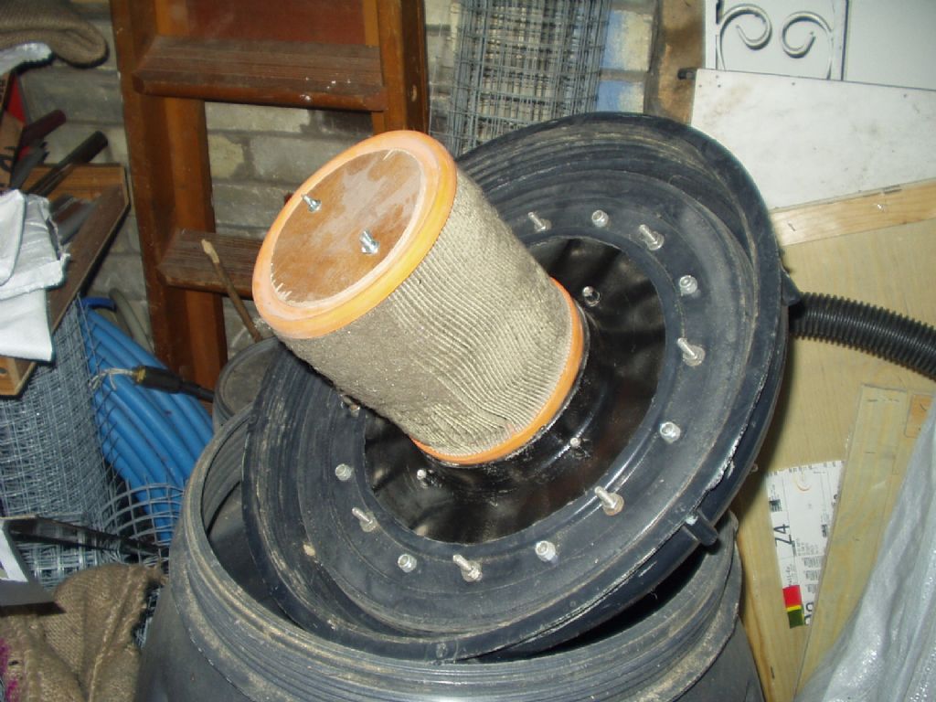

                                      wheeltapper
                                        @wheeltapper
                                        Hi
                                        this is the beast i use.
                                        it's an industrial extractor head bought at a boot sale for a pound fitted to the lid of a large picke barrel.
                                        the filter is a car air filter .
                                        it will pick up everything, including some I dont want picked up.
                                        Roy,
