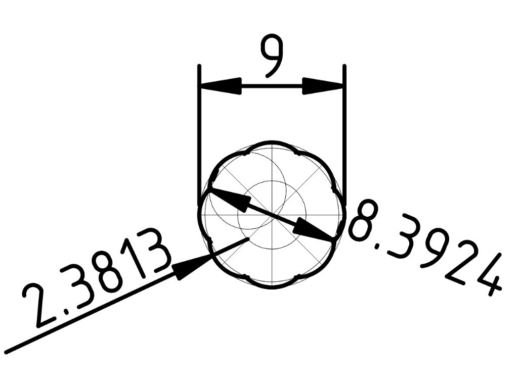

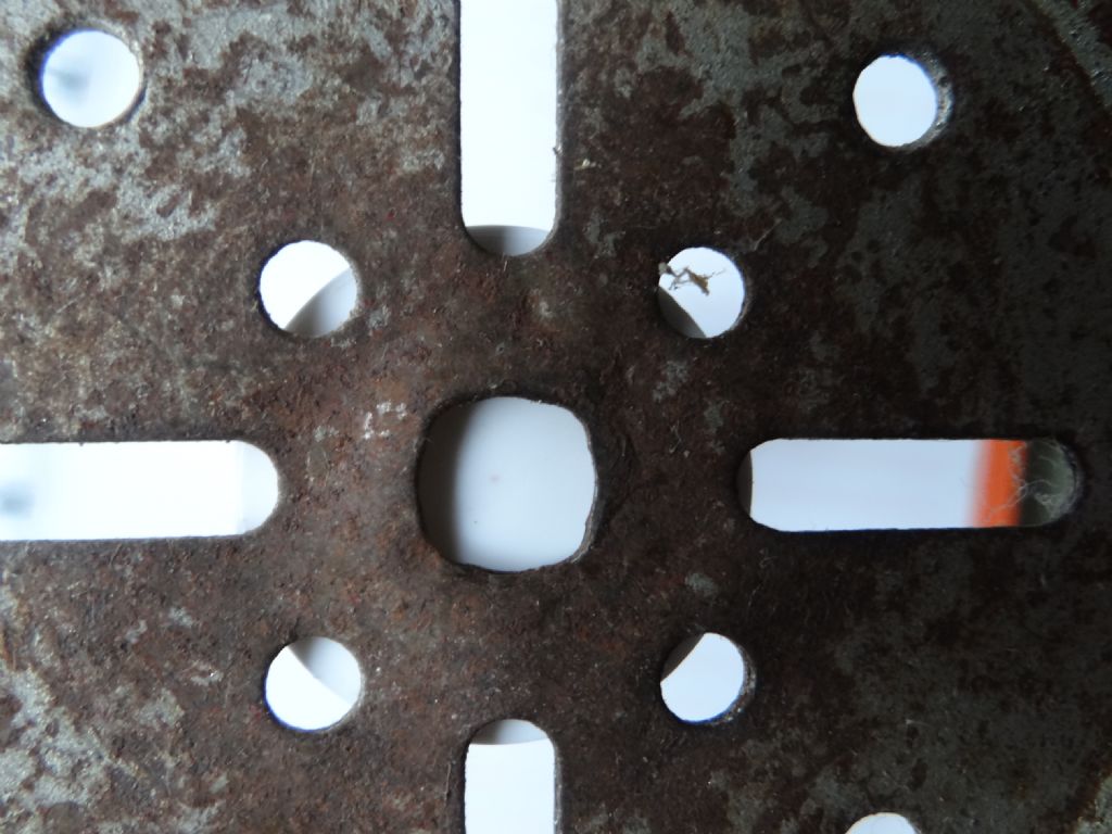

                                              I couldn't find a damaged Meccano gear to investigate but this is what the boss hole in a 3" pulley looks like:
                                              You can see that the hole isn't round, it has eight lobes cut into the inner circumference.
                                              Other than the lobes being about 3/16" in diameter, I couldn't work out the Imperial base. Hence the dimensions are in mm. Apologies to Meccano purists for using metric and also to anyone offended by my drawing package suggesting I can measure accurately to 0.0001mm! Please read about 9mm, about 2.4mm and about 8.4mm. ±0.02mm
                                              Edited By SillyOldDuffer on 05/09/2017 14:42:52

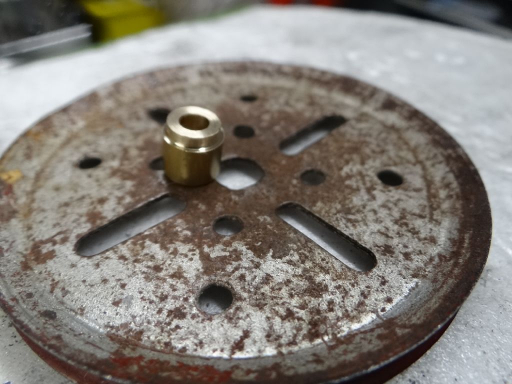

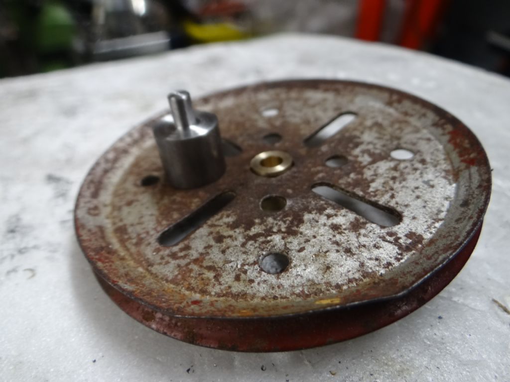

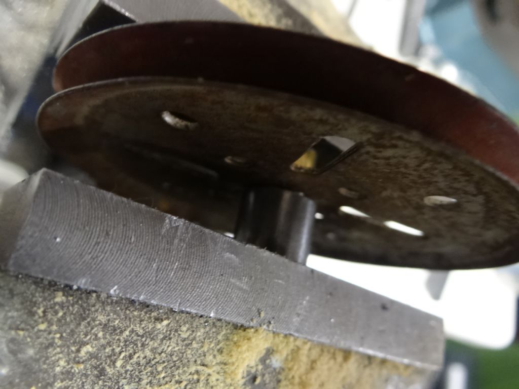

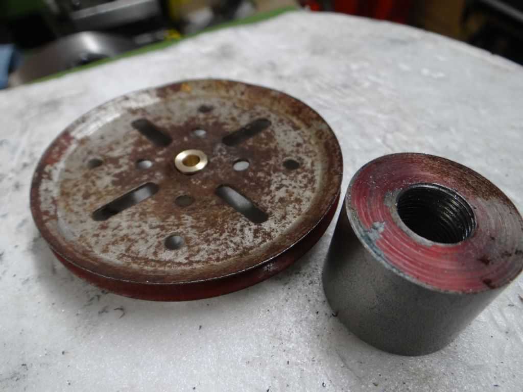

                                                  I turned a 3/8" diameter brass boss with a 4.1mm through hole and a 1.5mm deep step to form the swage. The diameter of the step was cut to be slightly larger than the boss hole's minimum diameter, ie an interference fit with the inner side of the lobes.
                                                  I used an odd bit of junk box steel to support the rear of the pulley and eased the boss into the hole with a 4" vice:
                                                  Then I made a 1/2" diameter mild steel die with a 4.1mm pin to fit inside the brass boss:
                                                  And squeezed the whole lot in my vice as hard as I could by hand:
                                                  Results not very exciting. Although the boss is firmly fixed, and the pulley is at a right angle to the boss, it's not obvious that any swaging has taken place. Actually the diameter of boss is 0.1mm bigger, so the brass has deformed slightly. Hitting the die with a 2lb lump hammer increases the diameter by about 0.1mm per whack BUT the rear face of the boss got damaged and the pulley moved off axis. Not good.
                                                  I conclude that the brass would have to be softened before this approach might work, and that using a hammer is likely to distort the gear. At least in my unskilled hands it does!
                                                  Now I'm off to investigate annealing.
