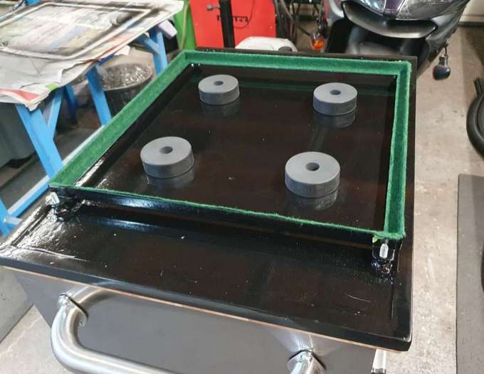

          My 36″ by 24″ cast iron surface plate has three feet cast into the sides. The feet are not spaced according to the diagram but are almost on the outer edges. Mind you it is only Grade B. I The sides, and internal webs, are quite deep, about 5″, so I doubt the table will sag much. A big advantage of three feet is that the table will be stable with no rocking or induced stresses due to over constraint.
          Andrew
          This is in accord with my Metrology book.  Three feet to stop rocking, positioned at two corners and mid-centre on the opposite side.  No mention of Airy or Bessel, but it’s emphasised that Surface Plates must be ‘of deep section and properly ribbed so the plate can take it’s own weight, as well as heavy objects placed upon it, without appreciable deflection‘   The support under the table has to the same, which is why commercial surface plate stands are remarkably beefy!
          The need to avoid rocking means that Taf’s arrangement could be improved, 3 pucks good, 4 pucks bad, not that he’s noticed this is an issue yet:
          taf
          The most likely reason Taf hasn’t noticed rocking, is that the weight of work and type of measurement he’s been doing so far haven’t combined to highlight the error.   But I think it would show if a heavy block and the DTI measuring it were moved around the table such that the same dimension was measured from several different positions.

          #740527
            Andrew
            It is becoming increasingly obvious [to me] that the specified locations are are only applicable to simple cuboid blocks of homogenous material [e.g. Granite surface plates]
            Iron plates with cast-in webs are a rather different beast !
            … There may well be an optimum location for each supporting foot, but it will be specific to the weight and stiffness distribution !
            The best approach therefore, would be for the user to support such a plate at the the same points where the manufacturer did when making it.
            … and this is presumably what Andrew has done.

                  peak4
                    @peak4
                    A few thoughts from a non formally trained engineer; well I am trained, but in telephony and networks.
                    If there is a need to support a surface plate by any particular points, surely use the same ones from when it was originally produced and calibrated.
                    If you’re going to use ice hockey pucks, buy 5, not three or four; support the plate on three of them, and thin the other two down a bit, so they don’t touch the underside of the plate, but will stop it rocking too far if you lean on it.

                    Taf_Pembs
                      @taf_pembs
                      Hi Dave (SOD),
                      I totally agree 3 would be better, I was originally going to mount it on 3 pucks but as I said in my original post, I read a section of a website that explained about the potential for such a small plate to tip due to it’s lack of mass which to be fair, when I was setting up to measure the quill alignment in the gear head of the mill I had the plate supported on 3 points and it did tip when I made the stupid mistake of not lowering the gear head onto it far enough to the side supported by 2 points (I am kift like that!) so I went for 4 ‘soft’ feet in the hope that that would compensate.
                      Unorthodox – yes – but seems to be fine so far (he says with fingers crossed!) and I am only playing at this, muddling my way through as best I can.
                      I still can not find the site I read about the almost unmeasurable amount of distortion for such small but fairly thick granite plates even if they are just sat flat on an old bench etc on (it was talking workshop environment not lab obviously), I can only find the Eley Metrology site that produce stands that says they don’t do a stand for 600mm x 600mm or smaller at the stand is liable to fall over being top heavy for such a narrow base I was looking at their site for ideas. Not that my plate is anywhere near expensive or accurate enough to worry about that, it does what I need better than expected though.
                      Time will tell if I get any rocking but I’m hoping that the ‘give’ in the pucks will allow it to sit OK.. if not it’s back to the drawing board!
