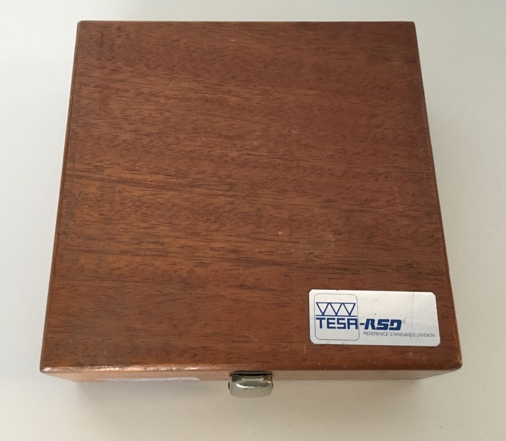

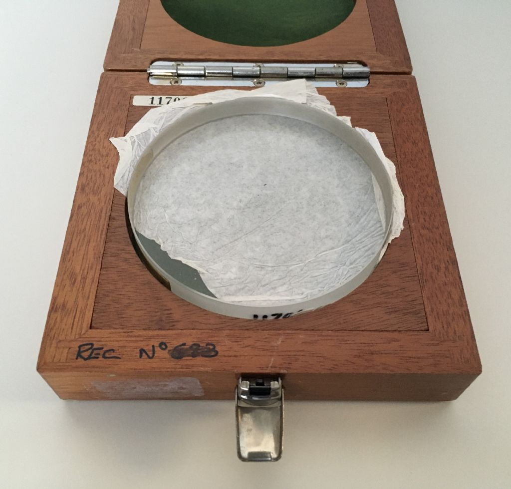

                #622609
                  Posted by Michael Gilligan on 25/11/2022 10:13:15:
                  In that position … I would be looking for three thick ‘pyrex’ discs [like telescope mirror makers use] as my starting point.
                  But … being, at the time, in a rather more fortunate position … I saved myself a lot of work by buying this:
                  The important point being that I understand how to do the job, if the need should ever arise.
