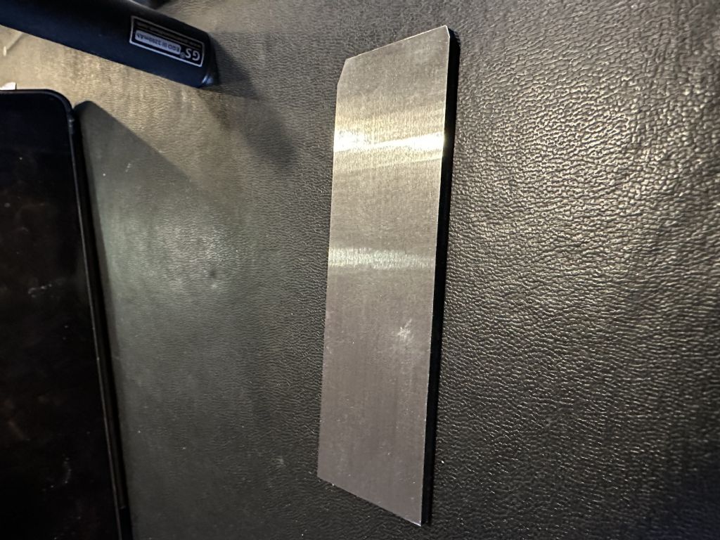

          BTW I have switched over to the carbide scraper, with a little skinny blade I made to get into dovetails. I’ve been sharpening it with a diamond hone. I think the diamond disc I was sharpening with before was no good and the diamond coating had come off. I really could do with a diamond wheel of some sort.

            Your table flatness is fine, once you have your magnet in place and ground in that will be your working surface. To sharpen your carbide I recommend something like these
            1 Set 6 Inch 240/600/3000 Diamond Coated Wheel Lapping Disc Flat Lap Wheel Kits
            4” ones are also available, you just need a backing plate and some means of rotating them. Stefan G made avery nice 24V powered slow speed grinder attaching them to the backing plate with magnets and two drive pins. I copied it and it works beautifully, I also use it to touch up carbide inserts and HSS lathe tools. My grinding rest is a 3D printed tower with 5 degree iirc top surface.

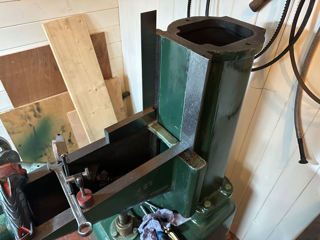

                    The good news….
                    Of the bearing surfaces I’ve now scraped the column, the table (top and ways) and the knee (horizontal and vertical surfaces). All seems to be reasonably flat and square: I’m now starting on the carriage between the knee and the table.
                    The not so good news….
                    Measuring parallelism of the column dovetails, it looks like about 0.009 of wear.
                    Column dovetail
                    I reckon I need the straight edge for this, which hasn’t turned up yet, despite chasing. Even then it’s a significant job.

                            I can’t help thinking though that with such a big dip that the table will “flop” in that area. It’s easy to see why it happens, there’s a lot of weight pulling against the dovetail around there, if it’s scraped it will surely hold oil much better.
                            Taking 9 thou off is a lot – and the wear area is quite small, maybe 1/4 of the length of the dovetail. That’s a lot of scraping.I’ll have a look and see if the bulk can be removed with a file.

                              Update…. I have finished the scraping of the main services to a reasonable level, obviously some could be better, but I could probably keep at it for weeks. The problem is still the dovetails. Despite assurances, I still haven’t got the straight edge. so I have started putting it back together to see how it works, despite the 0.008 wear on the vertical dovetails.
                              I have been pleasantly surprised by the squareness of the knee with the column, it’s pretty much bang on. However, predictably, adjusting the gibs on the knee doesn’t really work very well due to the wear. If I tighten up the gibs while the knee is in the wear area, when I lower the knee, it gets stiff and interferes with the gear that is raising and lowering the knee, potentially causing it to come loose.
                              given that I know this, I can work around it, in practice for any particular job the amount of vertical movement I need is very small. But at some point those dovetails need to be sorted out. I am tempted to carry on and put the machine back together this weekend carefully, measuring and checking everything as I go.

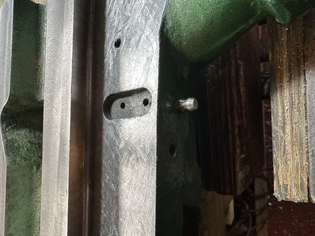

                                Stupid question no doubt, but what are these oil reservoirs called/how do they work? Do I need a wick of some sort?

                                  Those reservoirs should have a losenge-shaped felt pad in them. They are just a giant oil wick that lubricates the table as it slides over.

                                      Hi Tony. Well, I put it all back together yesterday for tests today. It is most annoying but to be honest I could do with a break from it. I have plenty of other projects to get on with, and I really want to get it to something usable.
                                      It has the oil grooves you mention on the gibs and opposite dovetail of the table. So I can see what you mean.
                                      One question, I’m guessing I need a special oil gun to fill the reservoirs from the oil nipples. Any idea what type? I’ve never come across this before in my very limited experience,
                                      Steve

                                        I had to make my oil gun from an old grease gun. I cut it in half, turned a heavy cap to serve as a base and welded it on. Cut the handle down to 6" long and filled it with way oil.
