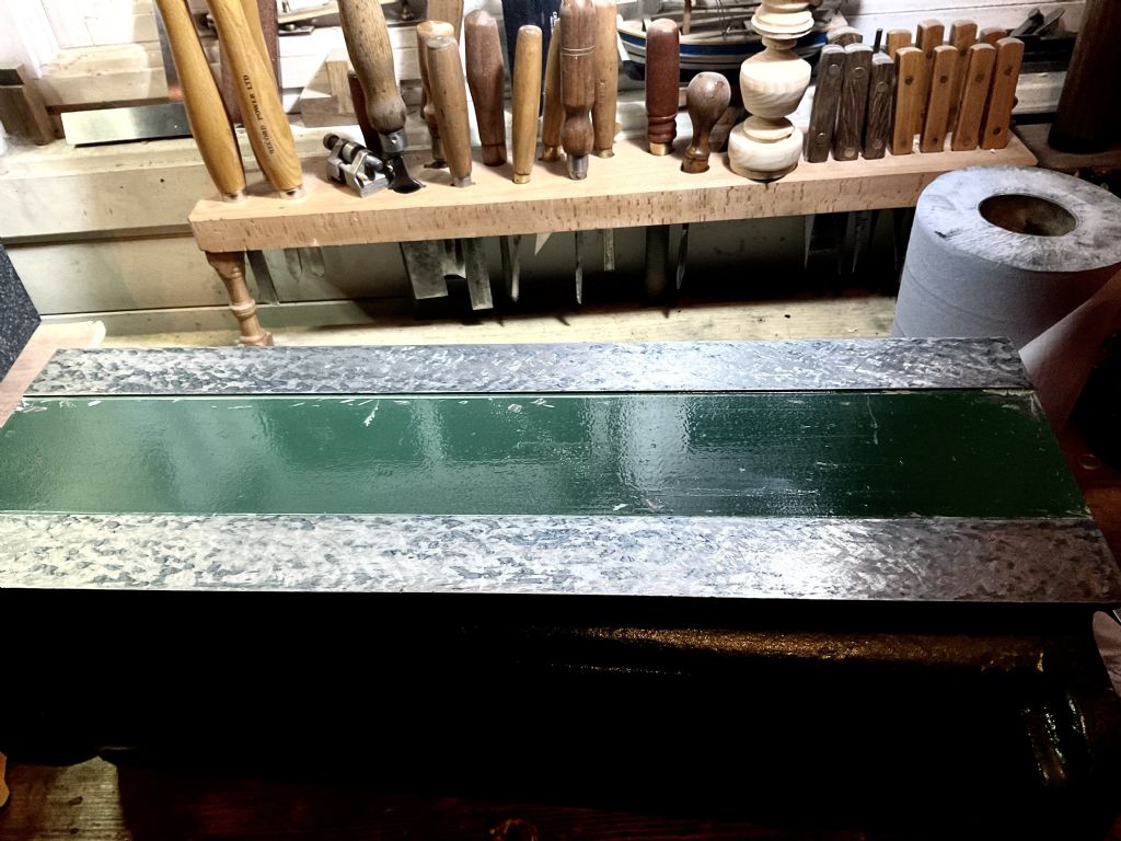

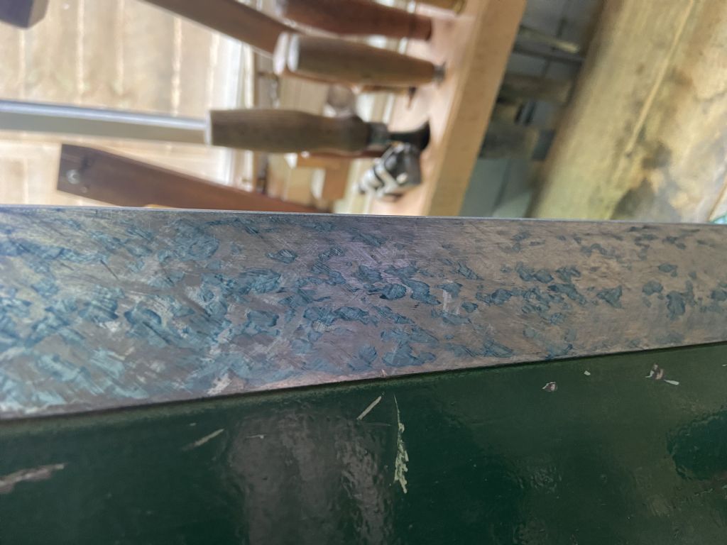

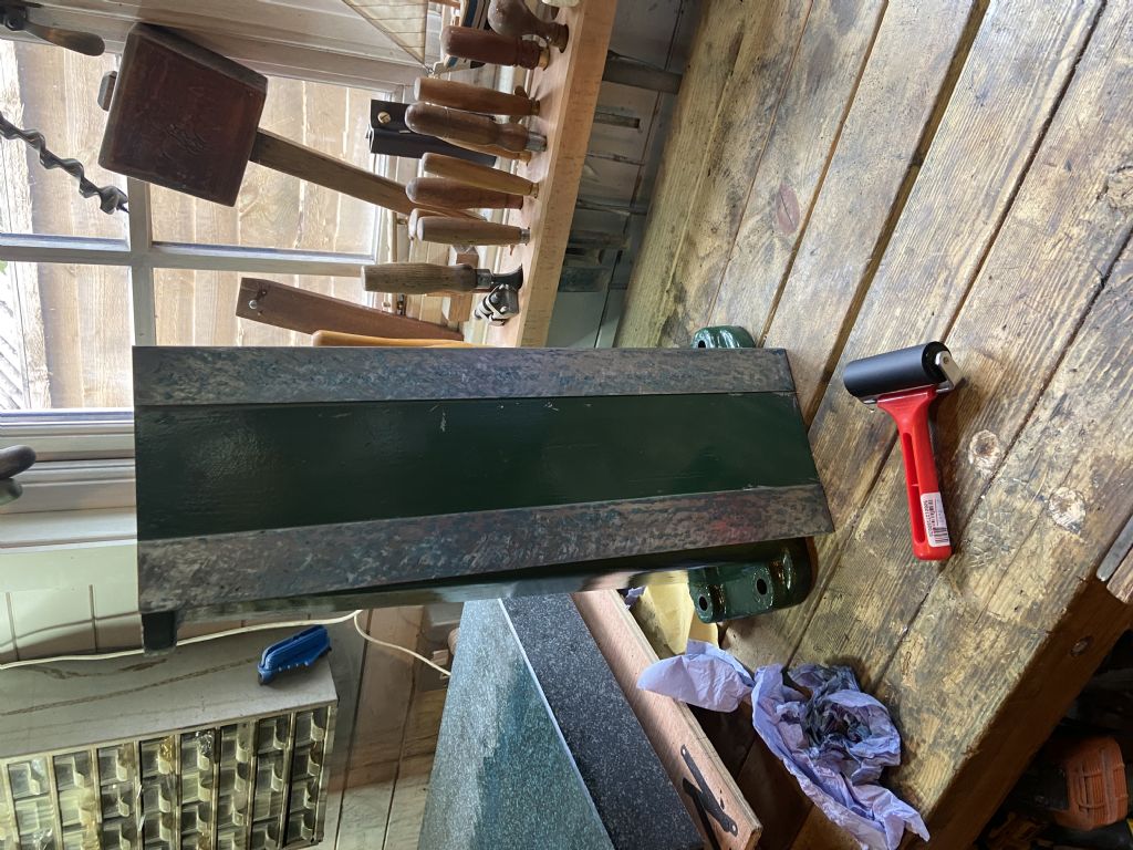

                  Steve355
                    @steve355
                    Thanks all for the advice
                    I went to the local art shop this morning and picked up a new roller. It seems much better than the other one I have.
                    I like the “Tom Cruise” solution of standing on a box. I have a workmate somewhere, it may be worth trying that also.
                    I hope I am getting closer with this column, my latest spotting below. It seems like it’s question of breaking up the blue in a few areas and I’ll be there. Does anyone beg to differ?
                    one thing – the contrast isn’t good. It isn’t easy to see blue patches under the light.
                    Then tomorrow I can go at the grinder table with the crosshatch pattern and wider spacing Pete was talking about.
                    #615614
                    Tony Ray
                      @tonyray65007
                      The blueing looks ok now, but I would say there are relatively large areas not making contact as seen on your second image. It may be helpful to go around the edge of those areas with a marker pen, This will help to visualise them and it’s easy to avoid them on the next scrape. I can also see lines of almost continuous blue along some of the edges also similar lines of non contact near the edges, that suggests that scraping is not being started at the edge. This is to be expected as this is difficult to do and unnecessary as It’s far easier to turn the work and scrape off the edge.
                      As Pete has suggested you need to shorten your stroke and you should scrape in a regular pattern at 45 degrees. I would do this all over the piece omitting strokes in those marker penned low areas. I would then repeat in the other direction without blueing in between. I trust that you are checking for hingeing and that the surface is flat rather than convex or concave as it is easy to produce a nice looking surface that isn’t flat.
                      #615623
                      Pete Rimmer
                        @peterimmer30576
                        Definitely the result of over-scraping. The good thing is that you have a decent spread of blue across the length . So long as it's hinging nicely you're not far from done. As Tony says, scrape only the blue but not all of the blue. Leave9what you would consider to be) large gaps between scrapes and watch the pattern come in as if by magic.
                        It certainly sounds like your bench is far too high for comfort. Mine are 900mm off the floor and they could do with being lower. I am just building a lower height bench just for the purpose.
                        #615626
                        Steve355
                          @steve355
                          Thanks Tony & Pete
                          Here’s where I got to last night, basically trying to break up the blue areas.. Yes, it is hinging nicely. But I feel I’m going around in circles, each pass doesn’t really seem to improve the pattern, just change it. I am having trouble with making smaller scrapes, and also with accuracy. It’s difficult to predict exactly where along the blade is making contact, so sometimes I miss the target.
                          In the end I stopped and moved on to roughing the table, which too me at least 1/2 hr for just one pass. I realised quite how much of this I have to do – the whole surface grinder, and the straight edge when it arrives, plus eventually other machines I have. I’m not one for giving up though.

                            #615682
                            Pete Rimmer
                              @peterimmer30576
                              Posted by Steve355 on 01/10/2022 07:31:55:
                              Thanks Tony & Pete
                              If you are finding that the print pattern moves about every time you scrape, the only thing that can cause that is the difference in height between the last blue pattern and the changed blue pattern is the depth of one scrape or less. If you think about it, this is a good place to be but it does mean that 1. your blue is very thin and 2. your scrapes are very shallow.
                              You need to increase the depth of your scrapes so that this stops happening. Once you do that your pattern will develop and you'll be able to use slightly heavier blue without it smearing.
                              This is also a time where having a flat stone can help a lot.

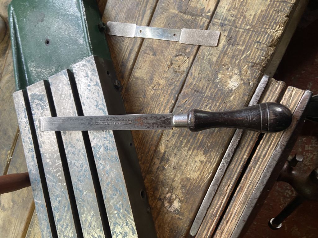

                                          #615808
                                          Tony Ray
                                            @tonyray65007
                                            I think your scraping is improving, it looks a more consistent on your last image. I hope I didn’t send you down that power scraper rabbit hole; I have been working on mine on and off for months, it’s Makita based as I can get parts for it relatively cheaply. The main issue is balance as the scraping gubbins is heavier that the saw blade & clamp. I have increased the counter weight but need to do more testing. It can produce a nice even pattern so I think it will at least  do for initial roughing. There is an alternative design on the Tube base on what looks like a windscreen wiper motor, the design is good but it’s more of a scratch build but I am tempted.
                                            I think your lack of depth of scraping at least in part due to the sharpness of your blade. You also said you are having trouble aiming the blade; join the club, some put a sharpie mark down the centreline of the blade to help. I found it took me a few months until I started to get the hang of it, unlike a chisel where you have a wide contact, with the radius on the blade it’s tricky to get that centre on the desired spot. I would suggest slowing down, place the blade on the spot then look to see where you have placed the blade before making the scrape The difference between a hit and a miss is quite small.

                                              #615840
                                              Steve355
                                                @steve355
                                                Posted by Tony Ray on 03/10/2022 00:39:48:
                                                Out of interest where are you based?
                                                Edited By Tony Ray on 03/10/2022 00:42:55
                                                I had a couple of hours before work this morning, thought I’d have a good look at my blade. Under a magnifier it was clear that it wasn’t really sharp at all. Out of frustration I grabbed an old eclipse scraper I have to see how it performed. It was a total revelation. I found I can get it really sharp in about 15 secs with a simple diamond hone. And being short, I can get my elbow behind it. I was getting the little black piles of cast iron dust at the end of each scrape again. Sure it goes blunt after a pass or two, but it’s so quick to resharpen it isn’t a problem. Just goes to show that hi-tech carbide isn’t necessarily better.
                                                I’m in Hitchin, near Stevenage.
                                                Edited By Steve355 on 03/10/2022 11:48:44
