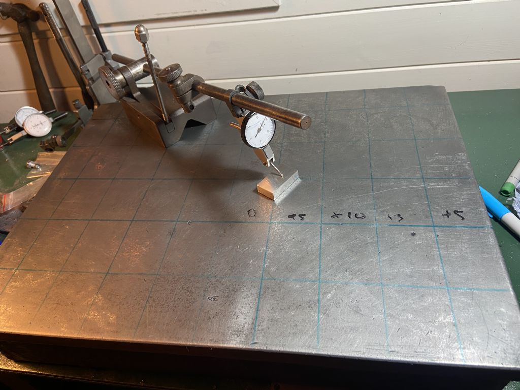

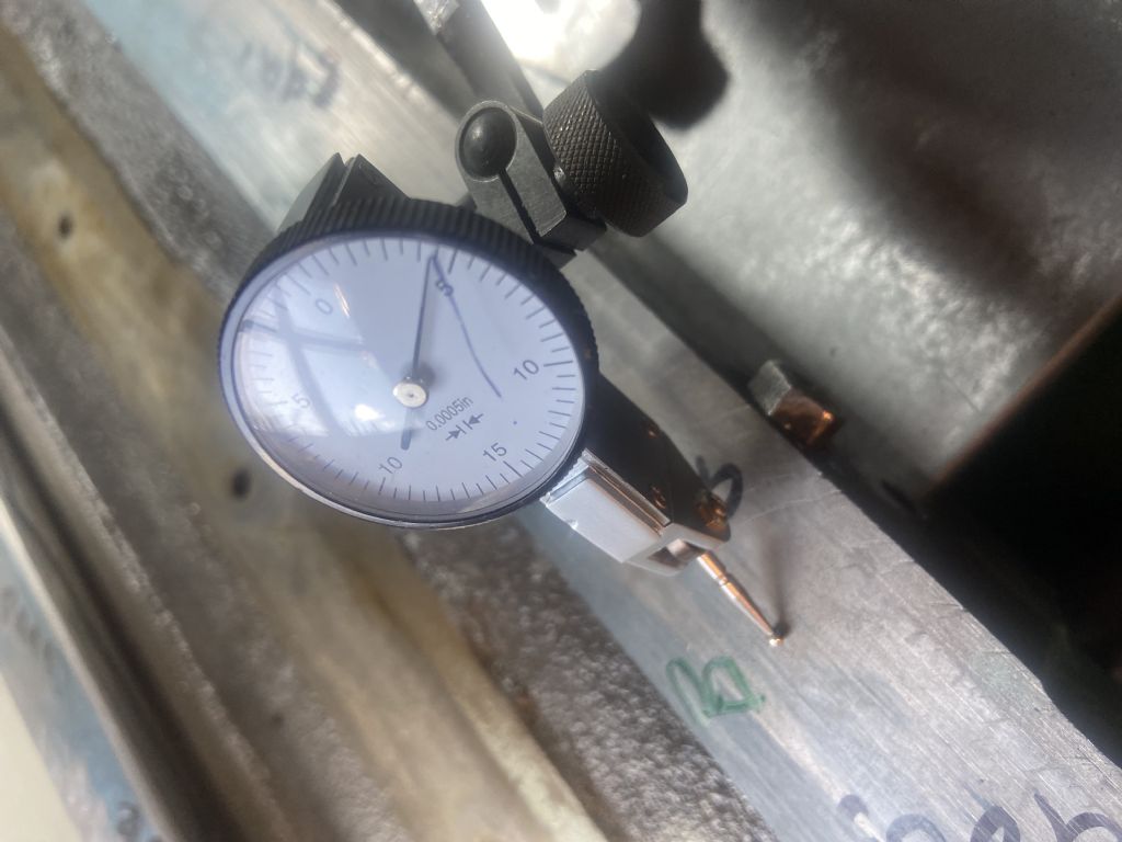

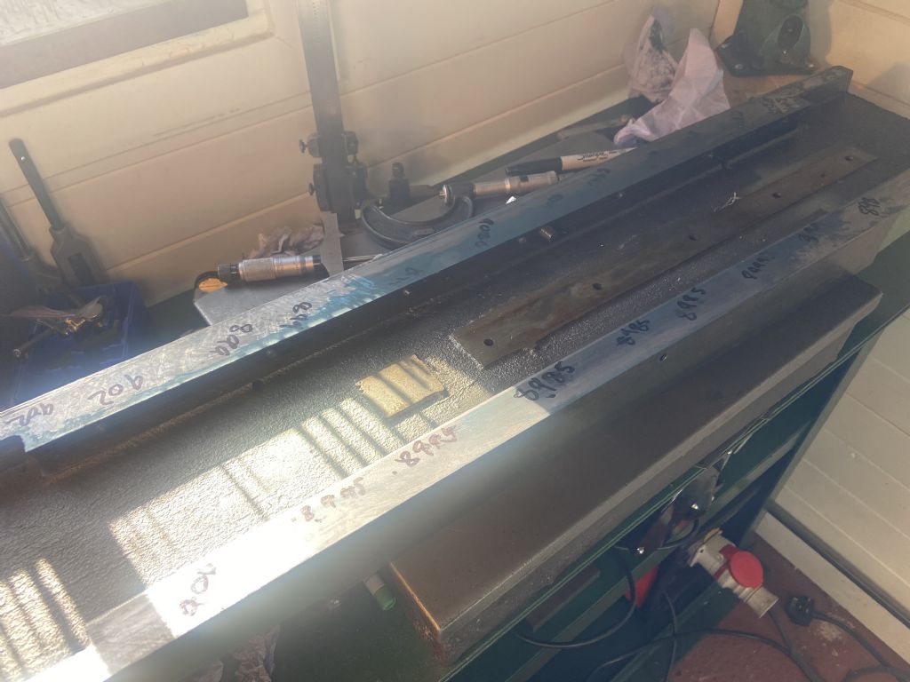

          I’ve measured the thickness of the table and it seems to mostly now be between 1.899 and 1.901. It was difficult to measure the extremities – had to use a depth micrometer, I don’t think the most outboard measurements are particularly reliable.
          So 1.899 to 1.901 – I would guess that’s a reasonable tolerance to start the bluing/scraping process?
          I had a go at bluing using the surface table, but 1) I don’t have a roller, one is on order but hasn’t turned up yet. And 2) it gets wobbly and unreliable at the extremities, it’s an 18” surface plate and a 32” grinder table. So I can see the benefits of the straight edge.
          The thing I am not understanding about the straight edge is how to keep the ways parallel to the table, and free of twist.
          I’d take up Pete’s kind offer, but if I could find one suitable I’d probably buy it. With all the machine refurbing I’ve done so far I have stripped, cleaned, replaced bearings etc but as for the basic workings of the machine I’ve had no ability to do anything for accuracy other than adjust/shim etc. I have several machines I can go back over if I have an accurate surface grinder and scraping skills/equipment and get them to a much better condition.

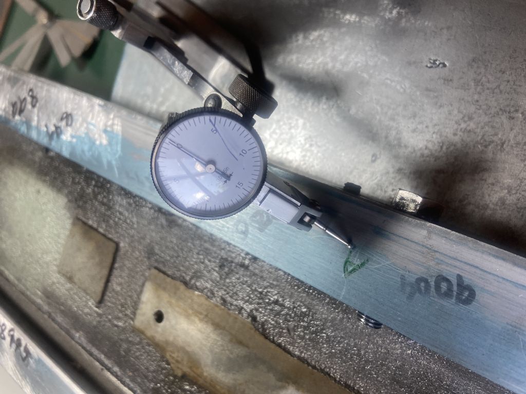

            Brilliant. So I wasn’t getting the same results from my surface plate/DTI measurement as with the micrometer. Turns out that the top of the table, somehow, isn’t flat. I’ve checked the surface plate and it seems ok.
            The micrometer reads 1.999” at A and B. The DTI differs by 0.005.
            I think it was Bill earlier who said he started by scraping the top of the table, and then use that as a reference surface. I did check the top of the table with feeler gauges, and it seemed to be fine down to one thou. But clearly it isn’t. Or something isn’t.

              If you look at my pic at full size in the album you'll see that the centre section is quite flat so by measuring from the top flat which is only half the length of the table you'll get a pretty good result. The ends see very little bearing so there's a section at about 25% and 75% where the surface takes quite a change.
              In my pic from 1 to 6 (tenths) is half a thou difference then 6 to 12 is 6 tenths difference but over 2.5 times the length. the centre is straighter than the ends.
              Also account for the fact that the micrometer measurements are not affected by gravity but DTI measurements are. The table is thin so will droop depending on which way up it's held. If it's flat upturned on the plate which it seems to be, it will be negligible.

                                          I actually have an old scriber stand, earlier I spent some time trying to map my surface plate to see how bad it really is. But it’s all so bouncy and unreliable that after an hour at it I am none the wiser. Each time I return to a square I get a different reading. Of course this could be because the base is not in exactly the same place, but even if it is I often get a different reading.
                                          I do wonder if I should buy another 18×12 reliable surface plate, or even a smaller one and use it as a reference to scrape my existing surface plate,

                                            Your setup there will work but it will tend to read what's under the front end of the scriber block rather than what's under the pointer. Shorten it up by pulling the rod back through the clamp a bit.
                                            A basic repeat-o-meter is simple enough to make. I made mine from a chunk of cast iron with the corner cut off and using a stanley blade as a hinge. Took a few hours and it works very well.
                                                repeat-o-meter
                                                Imdeed, I should have thought of this. This setup is functioning exactly like winding sticks in woodwork. It is amplifying any difference between the near and far sides of the base (and then adding on any difference at the location of the probe). In my defence I was just copying 2 experts from YouTube!
                                                I’ll think about how to do this better, the repeat-o-meter looks great, with the snag that the base needs to be surface ground (bit of a problem at the moment!)

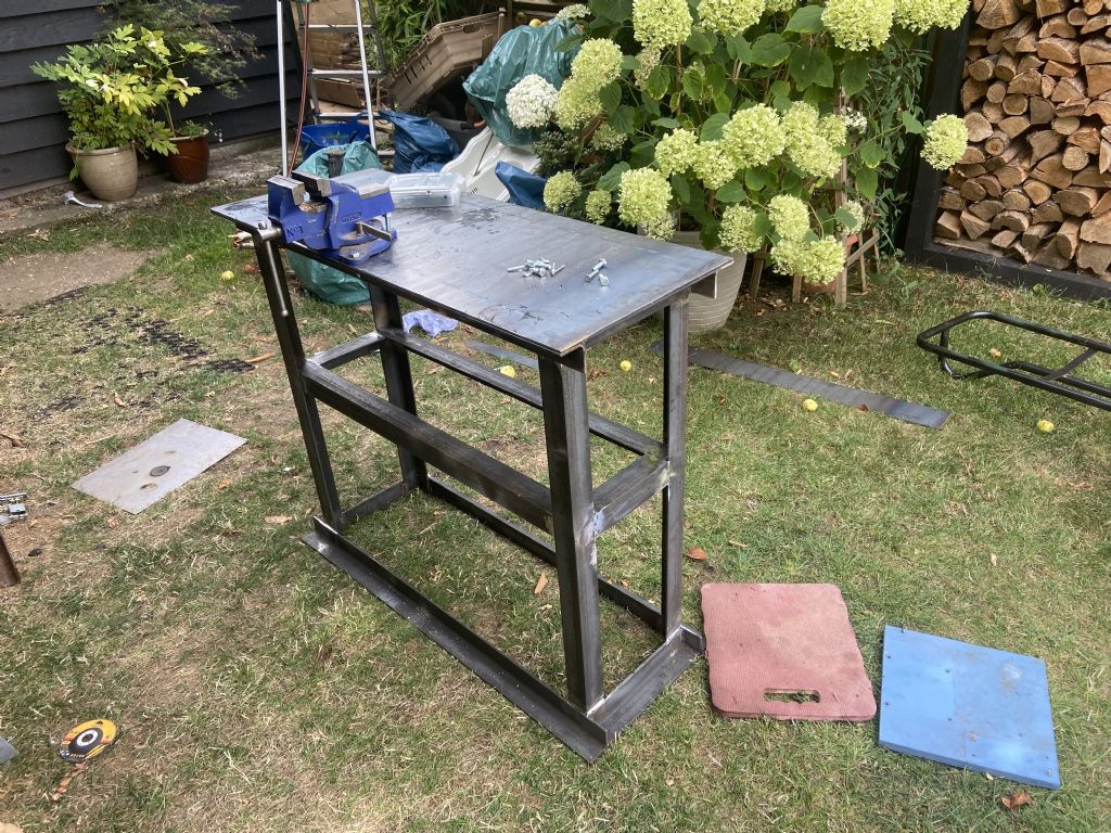

                                                  Here’s the thing… last weekend I lashed up a little metalworking bench. The idea being to get all the metalworking equipment out of the woodworking side of my shed, due to grinding dust, oil and grime not mixing at all with woodworking. Had I realised that I was going to want to find a space for a bigger surface plate, I could have done it differently. Here’s a vid of the area, the surface grinder has now moved to a more sensible position. See surface plate in its spot behind the DW.
                                                  Metalwork side
                                                  There may be a cunning plan available where I chop off the top of the bench, weld in a couple more lengths of angle to support a surface plate, and make the bench top removable. It would still be inconvenient/heavy, and the surface plate would be a few inches lower that I would like, but it might work.
                                                  Such a shame, the bench is 40cm deep. If only it were 50, it would fit a surface plate much better 🤔

                                                    Posted by Pete Rimmer on 06/08/2022 22:12:48:
                                                    I’ve had another go at this this morning, and got altogether better readings on my surface plate
                                                    DTI on surface plate
                                                    Displacement in most places is 0-0.0002 with a few spots that are maybe 0.0005. But it is difficult to do well, and the surface gauge spring is very springy (is this normal? I doubt it) and difficult to adjust accurately. If it slips off the gauge block, it often needs readjusting back to 0. I need a better surface gauge.
                                                    The errors are as likely to be me/the setup as the surface plate, I’d say.
                                                    The question is, is this surface plate good enough to work with the surface grinder table/ways etc? I wish it was, but probably not. But it isn’t as far out as I feared.

                                                      I you cared to pop down to me in Gravesend I would do a quick evaluation of your plate. You could bring the table and I'd do that too.
