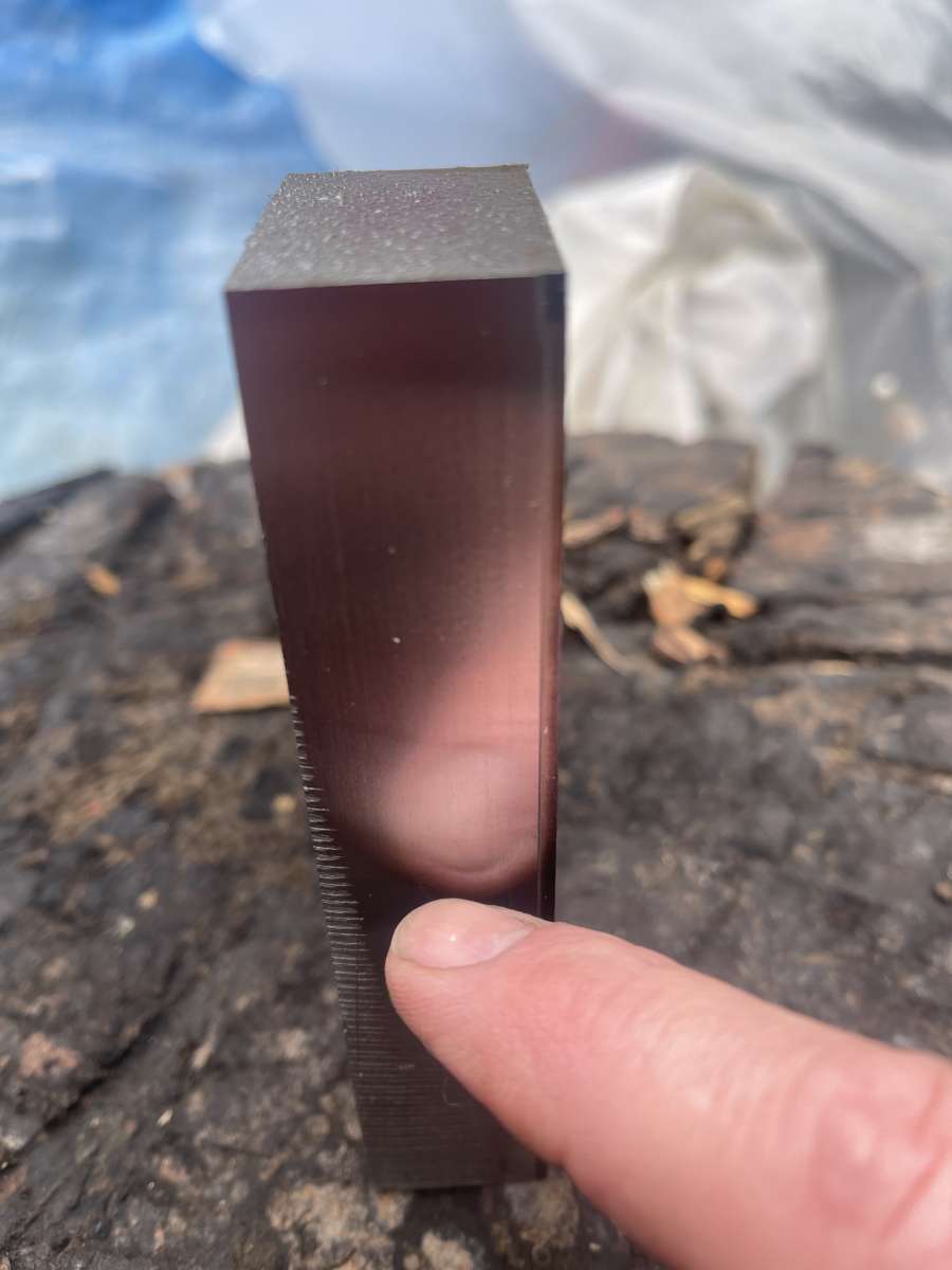

      Hello All
      I dont know if the above image is good enough for people to see but does anyone know why I am getting the lined finish from my manual surface grinder?
      Kind Regards
      Roy

        On a manual Ingar RT612 surface grinder where I used to work, similar finishes were apparent when the wheel required dressing or the DOC was a bit heavy. That machine seemed to give the best finishes with a DOC of 0.001″ or less with a freshly dressed wheel. No coolant on that machine, just dry grinding.
        Even when the wheel was freshly dressed & with a small DOC, the finish was not as visually “perfect” on that machine as would be expected with an automatic SG with coolant, though the banding didn’t exhibit the burning / wheel bounce marks shown above & could not be felt or seen uisng a 0.0001″ dial gauge on a surface plate.

          Nothing can be felt or detected on the finish in the photo, the material was cast iron, I did wonder if this was caused by a coarse wheel or spindle bearings. The grinder is a capco.

            You may get an improved finish on cast iron with a very open wheel
            If it’s spindle bearings the finish will probably improve with a heavier cut unless they are very bad. It would probably also improve with a narrower (therefore lighter) wheel.
            Did you dress the wheel beforehand? If not, dress it and try again. Dressing the wheel will true it and make it cut more readily. If you dress the wheel and find that it cuts much better but quickly deteriorates then you need to swap to a softer/more open wheel.

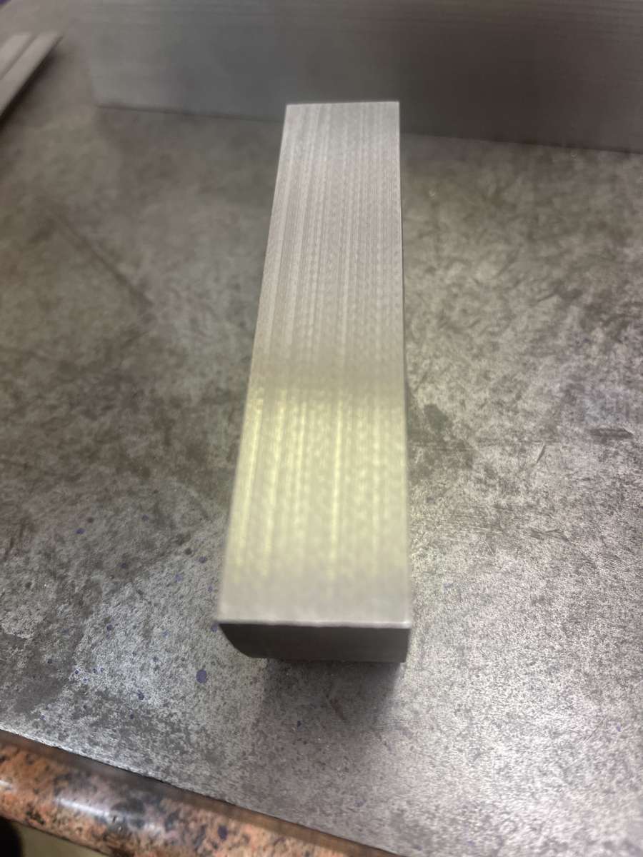

              I get a similar, but finer, ‘grain’ finish on a J&S 540 using auto-traverse. I have to grind dry because I cannot justify keeping the coolant unit full of soluble oil for the small amount of work I do on the machine. As the graining I get is ‘regular’ using auto-feeds the finish is quite cosmetically acceptable but obviously not to a tool-room standard.
              I have experimented with different cuts, dwell and table speeds but the results are always more or less the same. I fitted a new wheel-head drive belt after the old one perished but this made no difference either. I have been meaning to replace the wheel because I don’t know exactly what type is fitted, it was on the machine when I bought it years ago, as it looks like it’s getting a bit undersize now, but whether this will make any difference I have no idea.
              The machine is powered by a Transwave static converter which will not supply a true three-phase output, so whether any imperfections in the motor feed current produces small variations in the wheel speed or torque, I have no idea either.

                        I find I get more of a pattern with a fine 60 grit wheel, so maybe because it’s effectively pushing harder, than a 46 wheel which cuts faster. It gets better the thinner a cut I’m able to take, but there’s no fine vertical feed on my Herbert Junior.
                        I’m starting to think my bounce pattern wavelength is the same as the rack feed tooth pitch.

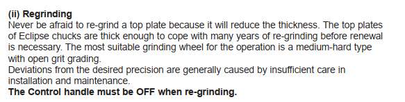

                                          I struggled with doing that job on my little Herbert; the chuck that came with it id 5″x10″, but the travel is only 4″x8″.
                                          I managed to get the full 10″ by swapping the traverse lever for a handwheel, but can only het the width of the table by moving it, which is far from ideal.
                                          I thought about trying an overly wide wheel, but even that is pushing it.
                                          The final cure was to get a top magnetic transfer plate, which is smaller.
                                          None of that is likely to affect you of course, but for me, one thing which improved the finish on the chuck was a mist oil cooler, using a synthetic grinding oil/water mix.
                                          Also an absolute minimum depth of cut to minimise local heating; again the water cooling helped with this, I just surrounded everything with paper towels, as it’s a dry grinder.
                                          Suburban Tools has a good video
                                          p.s. check your chuck instructions, some need to be energised, others left off.
                                          From my Eclipse manual

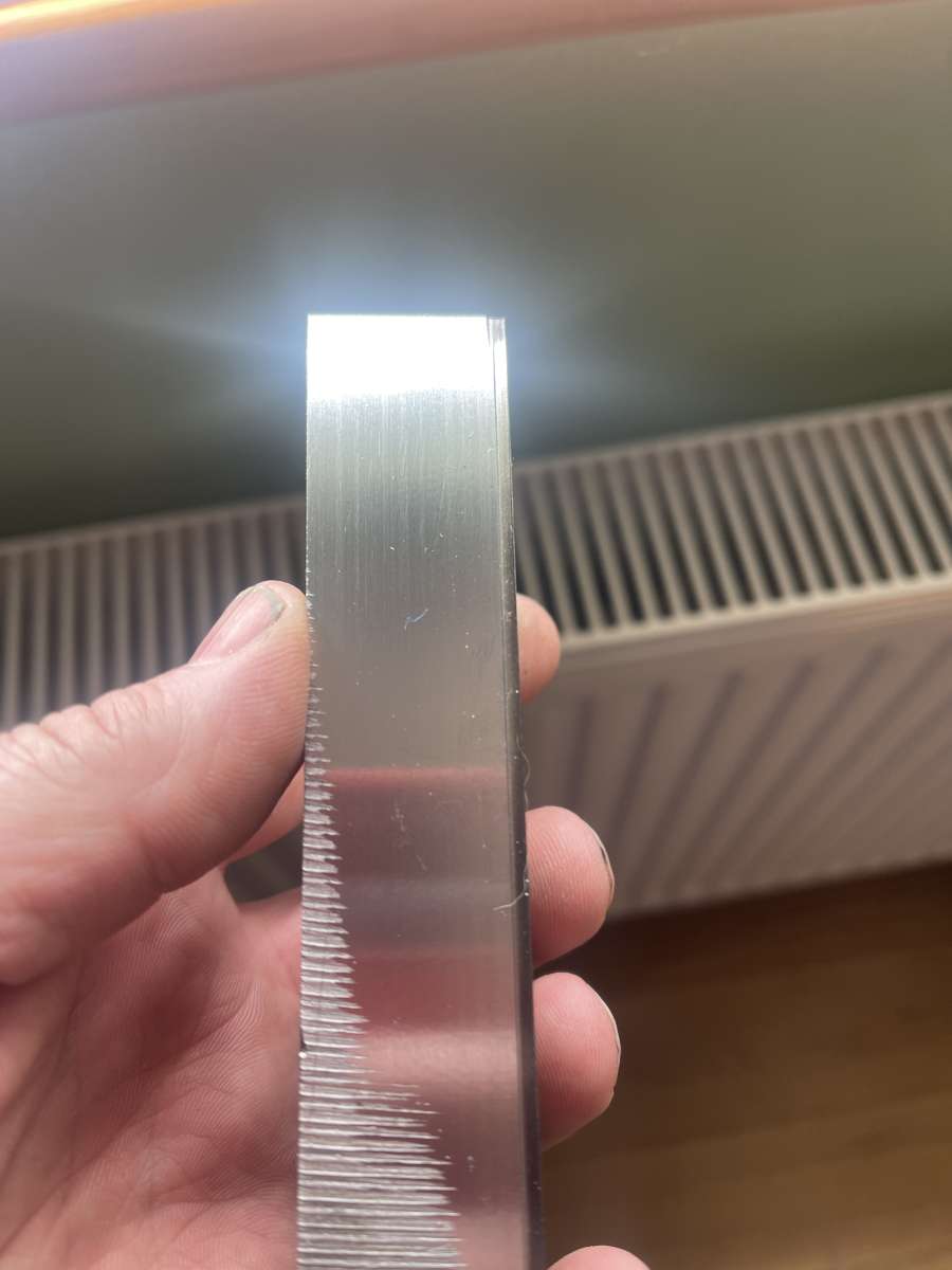

                                            Thank you for the advice, the pictures above show my finish now having taken the advice, This morning I took a look at the belt and it was flopping about all over the place at the back of the machine so I cleaned the pulleys and re aligned them, I then changed the wheel to a more open freshly dressed wheel, I noticed with a heavier cut it no longer stalls but burns. I think the above finish is good enough for the magnetic chuck unless anyone disagrees.

                                              I think you can be happy with that, what an improvement!
                                              For grinding your chuck use an open wheel and try to cobble up some coolant even if it’s just a mist spray. You can raise a burn on a chuck very quickly. You need to get right across the chuck in one dressing so that you still have some wheel left to spark the last bit out then you know that the chuck is flat. Check your gibs before you attempt it, or stick a sensitive level on the chuck beforehand and run it end to end on the travel. If the level moves significantly from fully left to fully right you’ll grind the chuck convex.

                                                Looks like your actions have solved the problem
                                                Good!
