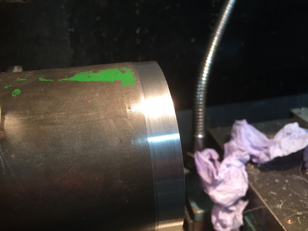

      Tony:
      "You are also only just 'skimming' the cold rolled bar stock. I have seen this effect on 3 phase lathes as well so not sure it's the motor?"
      Can you elaborate on that? Is that something to do do with a 'skin' on cold rolled stock? I'm not sure if it's germane to my problem – I saw the effect with deeper cuts, but posted the pic of a skim the hope of ruling out issues of lathe rigidity.
      Chris – twin smooth V belts. I have no idea how well the belts are matched though. I suppose if they're not well matched, it could be a cause of vibration. Thanks for pointing up that potential problem.
      John – the surface finish formula is interesting, but also (for me) frustrating – the author doesn't explain how he has arrived at it. There are are only three quantities in the formula – Ra number, feed rate and tip radius.. Presumably that means that other factors such as depth of cut and machine rigidity are negligible in his environment. Not so in mine! Maybe it's a CNC thing. I've no experience myself, but have seen the machines working and they seem to go for repetitive fast shallow cuts rather than hogging the metal off.

      #552222
      Tony Pratt 1
        @tonypratt1
        Robin, just saying I have seen that effect before & on 3 phase m/c's. If you get that effect on deeper cuts you can rule out the skin issue.

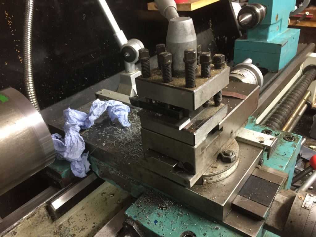

          Going back to the original post. I would like to see a photograph of the toolpost set-up.
          My reason for asking is as follows.
          I have seen in the past where some folk in their pursuit to have interchangeable tooling, have gone for a unit which is far too big for the lathe in question.
          Such set-ups mean the main cutting forces on larger diameter work are not taken by the top surfaces of the bedways front and back, but by the front shear and the rear under-bed shear. The top rear bed surface taking no load at all. In this situation the carriage floats, which induces chatter. This effect would be reduced on smaller diameter work, ie 2.5" work as stated, because the geometry of the lathe tool is then working where the manufacturer intended.

            Gray – thanks for your detailed reply. I was finding it very difficult to understand why the effect was more pronounced at larger diameters, but maybe you have explained it. Here is a photo of my QC tool post in a typical configuration:

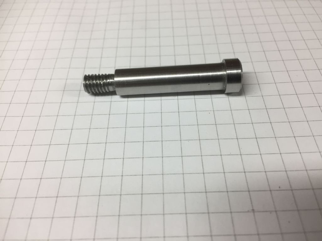

            Thanks also for you general comments. I have found that CCGT inserts (the ones I have are from ARC) are OK for finishing cuts in steel – this is an 8mm shoulder screw in silver steel I made tonight:
            which was finished with a ~ 0.05mm cut. I'm happy with that sort of finish.

                From your photograph above the Main Body of your QC system is the full width of the topslide. A 4 tool Turret, (usually supplied these days) usually overhangs the width of the topslide by a small margin. On my Maximat it is about 2 mm.
                The Tool Holder length on your system sits outside the Main Block, and the cutting tool extends beyond the Tool Holder. From this, and because of all these projections, the topslide has to sit nearer the operator on larger work. Nearer than the Lathe manufacturer intended for that particular diameter of work when using the standard equipment.
                When working on smaller diameter work all the cutting forces are working between the bedways, where they should be.
                As a rough rule of thumb the tool holder length should be the same as the standard 4 tool Turret.

                #552390
                Dave Halford
                  @davehalford22513
                  Your tool is only held by two of the four clamp screws on the holder, that would cause trouble on my lathe.

                      To wind this up (for me, for the present at least) I dug out the 4-way TP which came with the machine. When I bought the lathe (new) from Axminster it came with the QC mounted, and I just went along and used it without much thought.
                      I put the 4-way in place:
                      shimmed up a tool (PITA) and tried a cut under the same conditions as in my OP:
                      OK, not wonderful, but no 'screw thread' or other weird patterns at different spindle speeds.

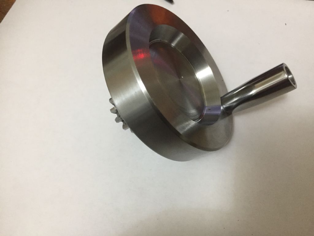

                      Eventually, after further experiments using the 4-way the part I was trying to make came out like this, straight off the lathe:
                      Well, OK, I polished the winding handle, but the rest is as-turned. I'm pretty happy with that. Well, f*****g delighted actually.
                      Many thanks, and especially to Graham Meek who pointed me in a direction which wasn't on my compass, but seems to be the way to go..
