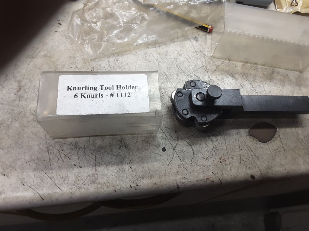

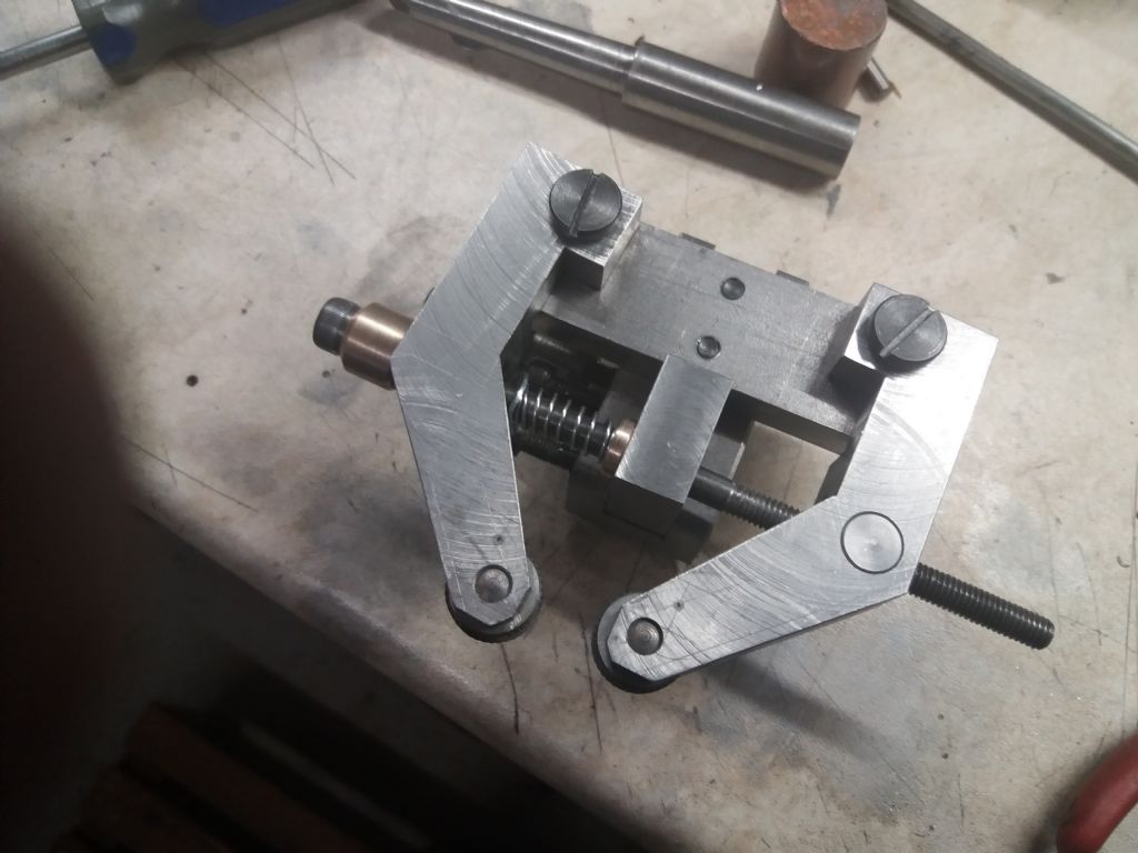

                    David George 1
                      @davidgeorge1
                      Hi Brian I made a knurlingtool from push type to make my clamp type and have changeable rolls for different size cuts using the original pins . I have another which you can have for free as it is not suitable for my lathe. Just drop me a message if you want it.
                      My knurling tool.
                      spare tool.
                      David

                              That's very kind of you David – many thanks. Unfortunately I need to make a simpler version of your own very nice knurling tool as I'll be using it on a Taig/Peatol Lathe and am very conscious of not overloading the (very small) Headstock.
