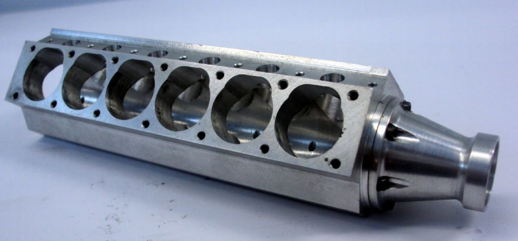

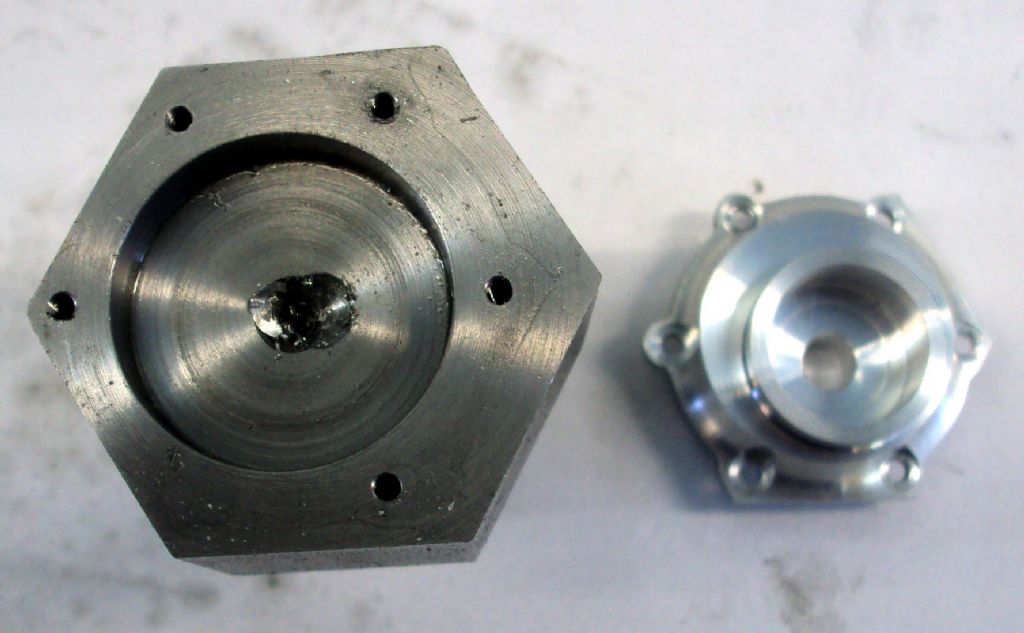

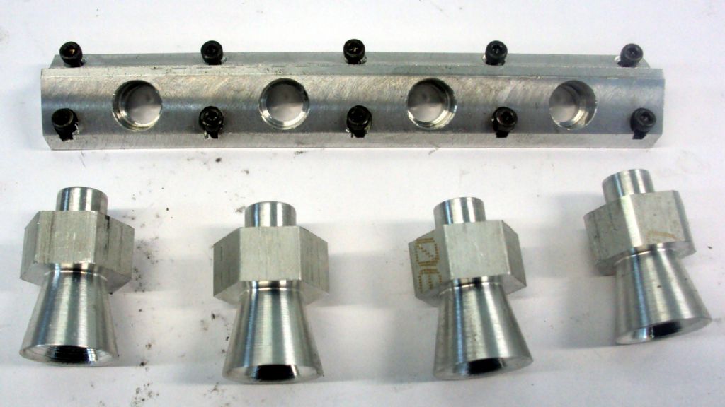

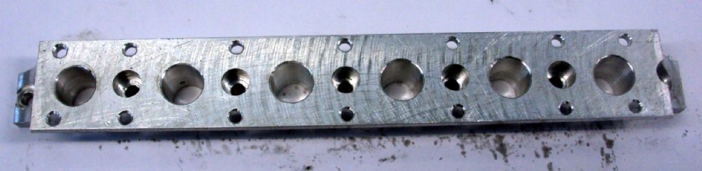

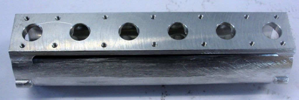

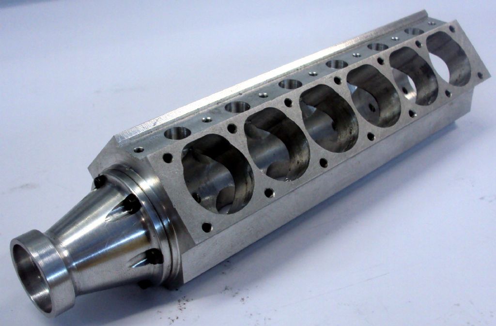

              dean clarke 2
                @deanclarke2
                Ok, so i have finished the front housing now, yay 1 more part down. this holds 2 21 x 12 x 5 ball races to carriy the front of the crankshaft. the rear end being held on a single ball race of the same dimensions. here are also the quad carb bodies i have roughed out along with the manifold.

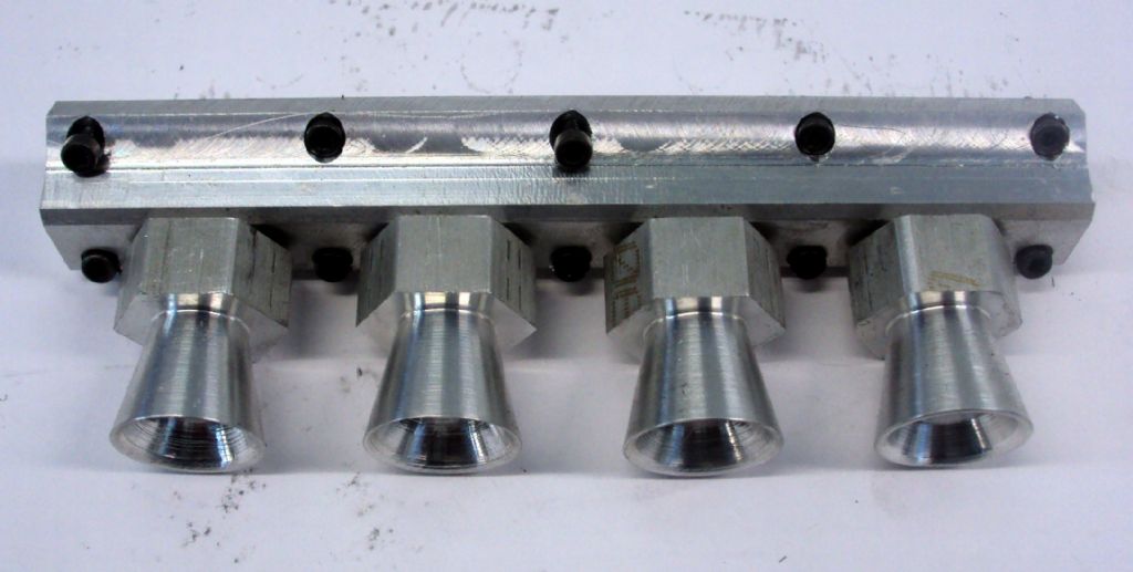

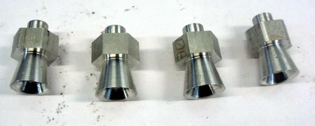

                Blower case is the next challenge, will post these photos as soon as i have done it.
                cheers for now
                dean

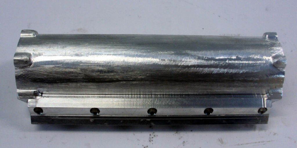

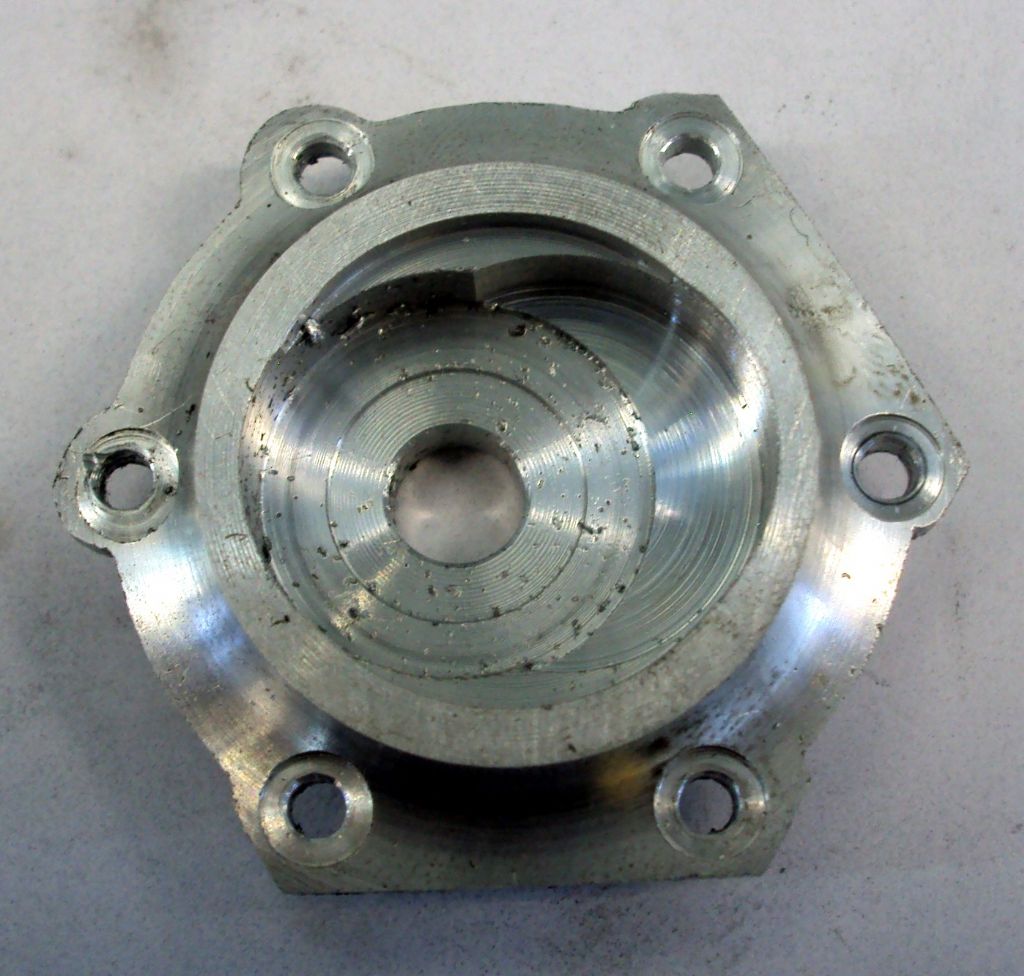

                #137834
                dean clarke 2

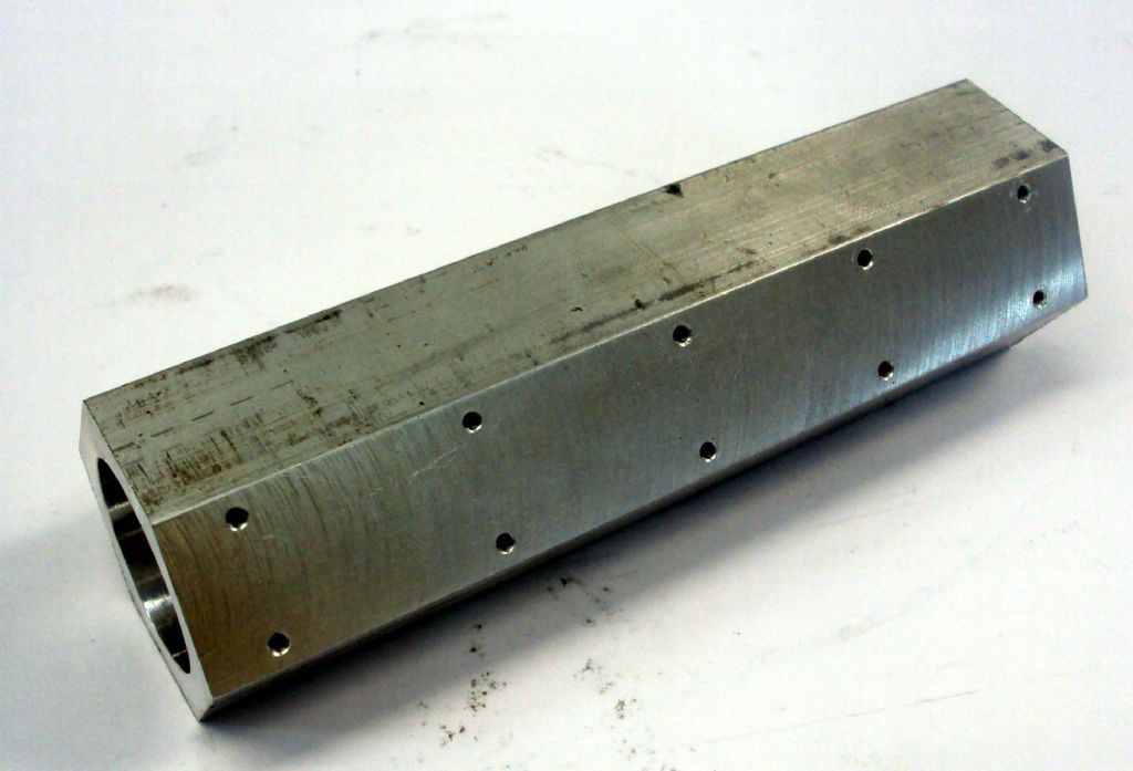

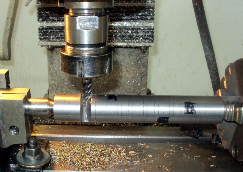

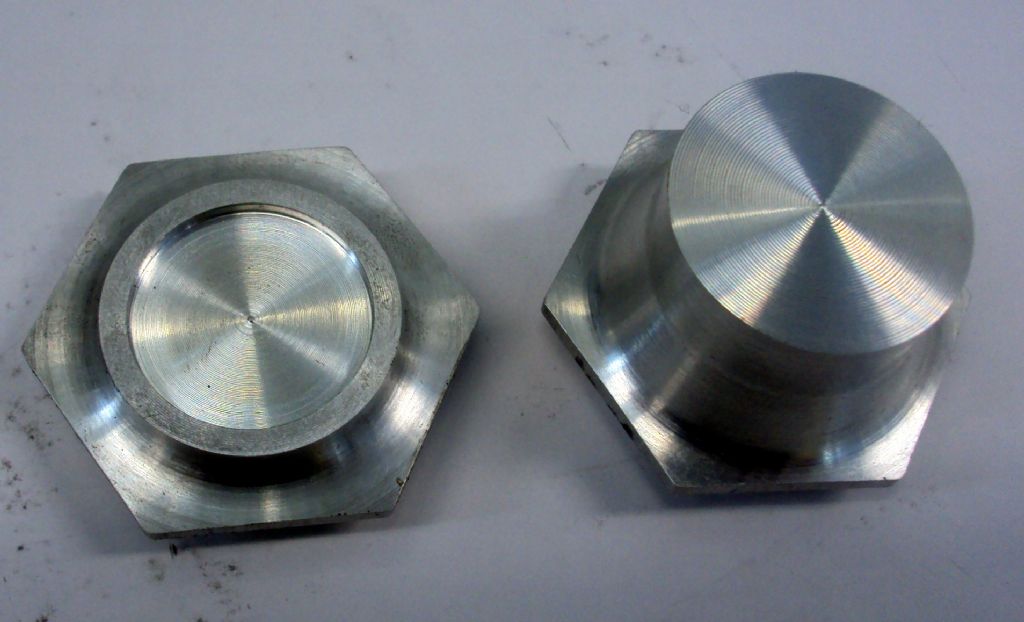

                  @deanclarke2

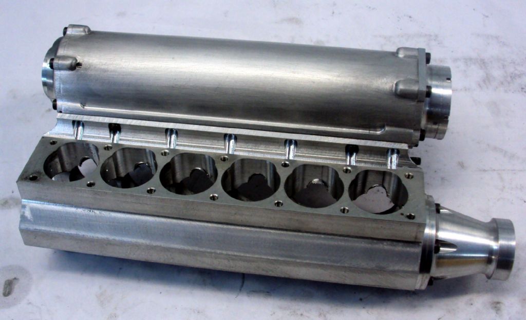

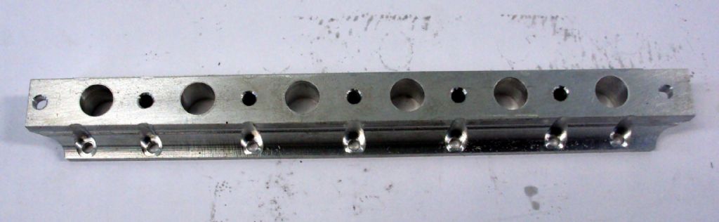

                  ok, so i had quite a bit of success over the weekend but also a somewhat frustrating disaster. got the supercharger case all but finished and both end caps machined up , made the offset turning fixture to machine the bearing holes for the blower rotor. this turned out to be not quite as straight forward as i thought as you will see in the latest photo updates.
                  having made the fixture i inadvertantly fitted the cover up 180 deg out and machined the wrong side, OOPS, bugger. oh well start that part again…………….
                  dean

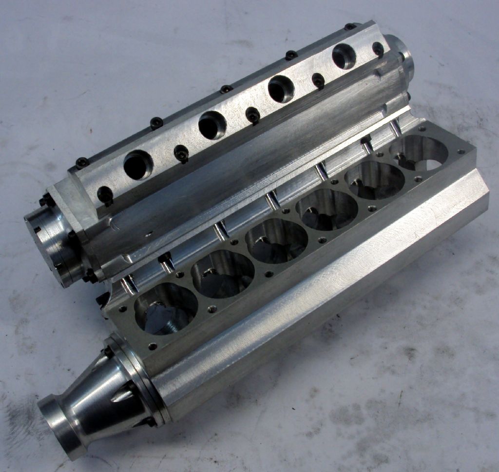

                  #138099
                  dean clarke 2
                    @deanclarke2

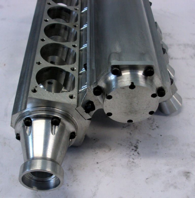

                    Hey guys , just thought i'd give you all an "assembled so far" bunch of photos of whats been done on this project up to date. i only have the blower rotor and vanes left to complete, then onto the crank.
                    cheers
                    dean
                    will keep posting progress if anyone's interested in seeing it?
                    dean

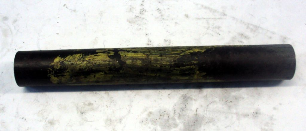

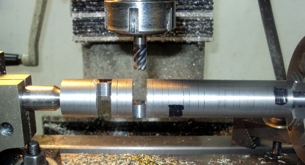

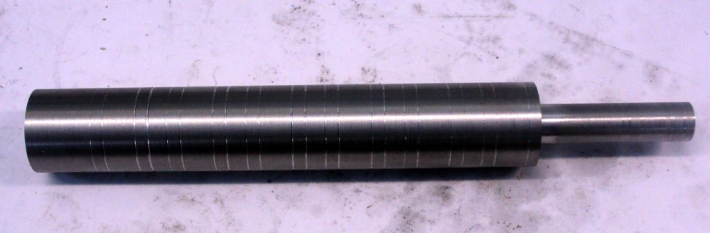

                        dean clarke 2
                          @deanclarke2

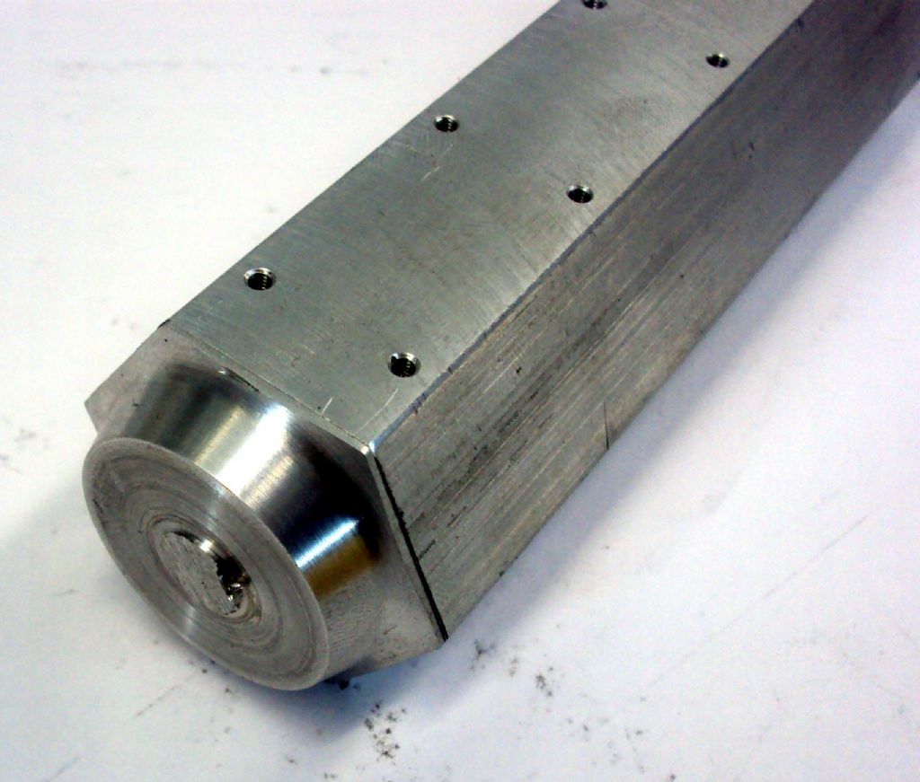

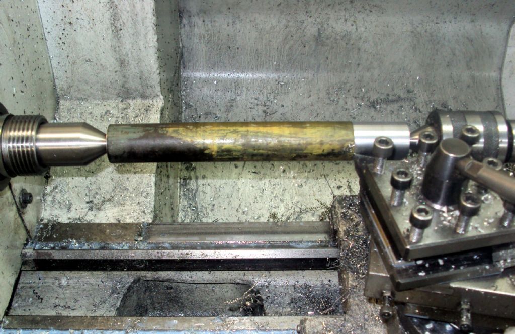

                          Well started the crank tonight, here are a couple of photos of the first two stages of machining
                          1st is bar stock cut to length and faced and centered both ends
                          2nd shot shows the front main fournel roughed out to go into a collet chuck.
                          3rd photo shows machining the flywheel diameter.
                          cheers for now
                          dean
                          #138190

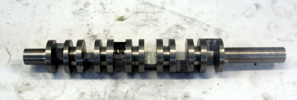

                          dean clarke 2
                            @deanclarke2
                            So heres the photos, LOL
                            so the sequence goes something like this, make the blank then machine the flywheel dia. then maching the front bearing to 1mm oversize and mark out all the flywheel, bigend and center main bearings. next its off to the mill for indexing all the bigend location marks, mill out the bulk of material for the be to leave a small oversize square. this reduces the turning in the lathe for the b.e. journel. once all the b.e. and main journels have been roughed out i grind the b.ends to final size followed by the mains. Big end journels are turned with the crank mounted in a special fixture. finally cut all the chamferes on the flywheel faces and deburr and polish.
                            dean

                            dean clarke 2
                              @deanclarke2
                              OK so another fine day in paradise and we saw the completion of stage two machining of the V12 crank. all B.E pins and main bearings have been roughed out to oversize by 1 mm ready for final machining to size.
                              Hopefully i will be able to finish machine and grind the crank this week, before christmas. Next will be the center main split bearings, backplate cover and blower drive.

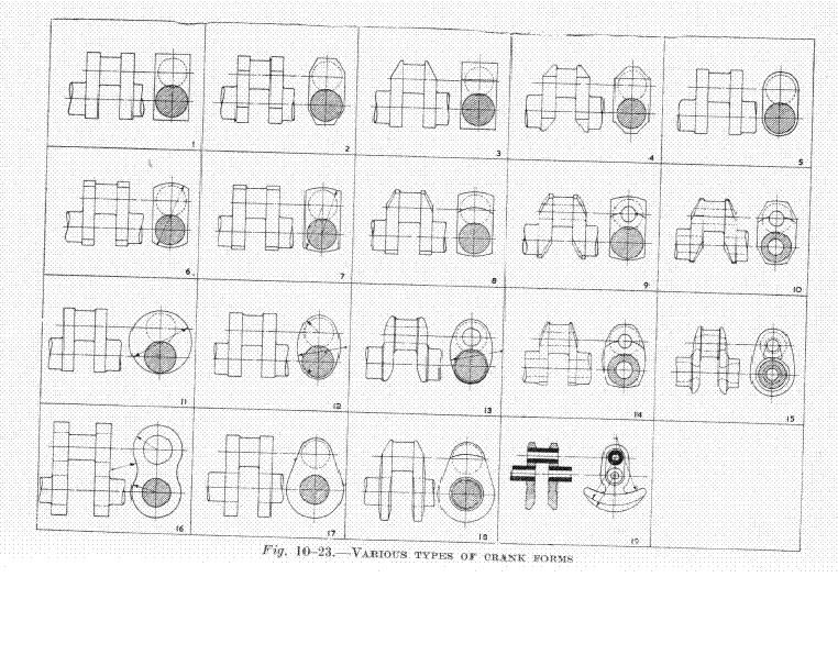

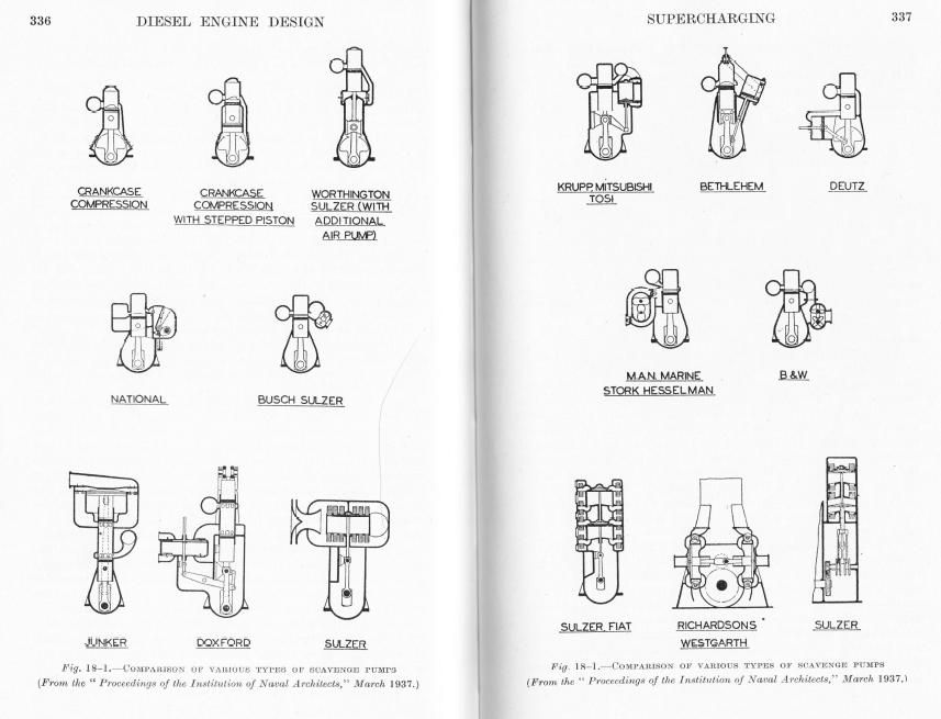

                                  Ady1
                                    @ady1
                                    All these fancy words like blower and scavenge pump and supercharger stirred the family braincell into remembering a book I once read
                                    I was Tubal Cains "Diesel Engine Design" and it contains a huge amount of detail on different routes used for different engines and their advantages/problems
                                    This is part of the crankshaft section
                                    supercharger section, etc etc
                                    Edited By Ady1 on 21/12/2013 12:33:17

                                          Hi guys and thanks for the comments and info etc. Hi jen, I accept what you are saying about 2 strokes with the port timing etc, and if you want to call it a scavenge pump then thats fine with me, each to his own, i will use the term supercharger as it will be forcing more mix into the engine than could otherwise be done. however without going into too much detail (secret squiral suff etc) LOL. the engine is arranged with porting and exhaust dimensions to allow some amount of positive charge in the combustion chamber, this is managed by using the rather large expansion pressure of combustion to act as a back door as it escapes out the exhaust system to allow positive transfer pressure to reach the combustion chamber. it is somewhat more involved than what i've just said but it does work. there are a few variables that need a bit more experimentation to finalise as it becomes a balancing act of appropriate pressures which will dictate drive speeds etc. Oh well i guess thats all for now will keep you all posted on the progress. The exhaust back pressure is also what helps stop excessive fuel consumption to a certain extent.
                                          cheers for now
                                          dean
                                          p.s. before anyone asks i have done some experiments and yes the theory is sound and will run, actually it will run very well i think but like my nanna always used to say " the proof is in the pudding" so we shall see.
