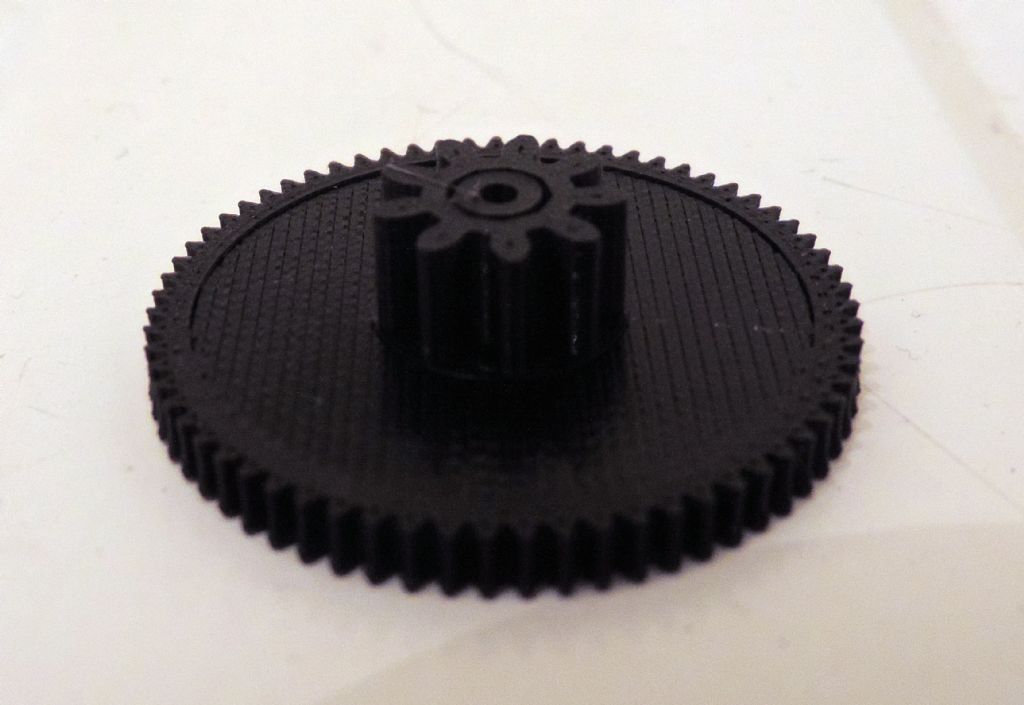

                              Neil, I believe I had a very quick chat with you about 3d printed changewheels at the Brooklands show last year. As it was a very quick chat indeed and as everyone else here wasn't around, the main point is that I have a 3D printed changewheel that has been in the gear train for just over 2 years being used as a fine feed and shows no signs of wear.
                              The downside is that it is not an extruded material print, it is a UV cure resin as I have access to that printer, but the involute profile is very good indeed.
                              At the time I had restored a 1930's Ideal flat belt lathe and had a list of missing changewheels from my set, so I printed those and a 63 tooth (which is the one shown in the below photo and youtube link) with the view of getting them cut from cast blanks. A parameterised model was made which takes DP, tooth count, wheel thickness, bore and keyway size so by editing each of those the set was made and being printed within 10 minutes of finishing the model. No finishing of any kind was needed, all gears fitted onto the lathe and mesh well as printed. They have been such a success that I no longer intend to replace them, even gear oil on the rest of the train doesn't seem to have worried them.
                              Happy to get some better close photos of them if there is any interest

                                    Michael, these are 16 DP for an idea of size. Photos aren't great, not much light in the workshop so depth of field is a bit shallow but it shows the required detail in certain areas. I've added high res versions so they can be zoomed into.
                                    High res link: **LINK**
                                    This one shows the lack of wear on the teeth given the use. Its sharp enough to see the tooth profile at the top of the gear by the cast one.
                                    The test is just visible in that, though it didn't come out super well in real life either, but it lists tooth count, dp and pressure angle.
                                    High res: **LINK**
                                    The machine that made them is an Objet 30 Pro by Stratasys (**LINK**), so rather than material being a plastic filament melted and positioned by a CNC head, resin is deposited much like an ink jet printer and cured with a U.V lamp. I imagine there must be companies offering the services of machines of this kind, but as I have access to it haven't looked into them I'm afraid.
                                    Hopefully there is enough sharpness to show the tooth profiles in the high res photos.

                                      Many thanks, Chris … Very impressive.
                                      I fairness to JS though; I must emphasise that the blue one he printed for me was:
                                      (a) 32DP, and
                                      (b) produced on a much less sophisticated printer,
                                      #285090
                                      John Stevenson 1
                                        @johnstevenson1
                                        I must admit that the quality of the gear I did for Micheal wasn't good.
                                        Didn't realise it at the time.
                                        The printer is a UP2+ which is a reasonable quality and should do better.
                                        Some gears I have here are far better so lather this week [ need a new filament holder as they have changed reel size ] I'll print another 127 off on 32DP using the finest settings.
                                        I may well have chosen a lower resolution by default.
