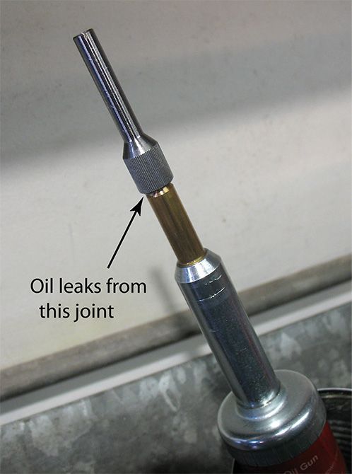

          On the topic of oil guns, yes, I have one of the Myford (Wanner) oil guns, but the thing has begun leaking at the join between the brass pump cylinder and Myford's add-on steel nozzle section.
          I've tried tightening the connection, but it still leaks quite badly in use.
          What would be the correct material for me to use to seal those threads? Teflon tape? Perhaps some Loctite product?

            Ignatz, please tell me where you got the oil gun tip from as the club needs one, and yes, PTFE tape will easy cork it oil tight John

                I bought one of these guns when first on the market then about 90 gbp ,but it has always leakedwhere you arrowed and ptfe has never cured it ,I have resigned myself to a leaky gun.

                      Much is said about oiling the Myford and what oil to use ! DO NOT use chainsaw chain lube ! For Nutto in the oil gun use a light engine or hydraulic oil to spec SAE 10 or ISO 32, this can be bought in 1L bottles. For slide ways Etc an engine oil to SAE 30 or ISO 68 a straight mineral oil is best not a multi grade, often sold as for classic cars/engines.If you have the quick change gear box then from memory EP 90 gear oil is used.
                      Since you have a lathe and the original oil gun was notorious for leaking the following may be helpful. A the usual thead for oil and grease guns was 1/8" BSP, (a common thread) and "O" rings are avalable in 4, 5 and 6mm by 2mm section (and many other small sizes) it would not be difficult to make an adaptor or a complete oil gun to solve the leakage problem. May be I should come up with a design ? Noel.

                          @ john fletcher, … I used that PTFE tape on the oil gun connection. First cleaned all the oil off of the threads (both inner and outer) and then gave three tight wraps of the teflon tape after which I tightened up the connection with two pairs of pliers – using suitable amounts of cotton cloth between pliers and fittings to avoid damage to the parts in question.
                          The oil gun now works a treat. No more leaks from that joint between the brass pump and the steel extension.
