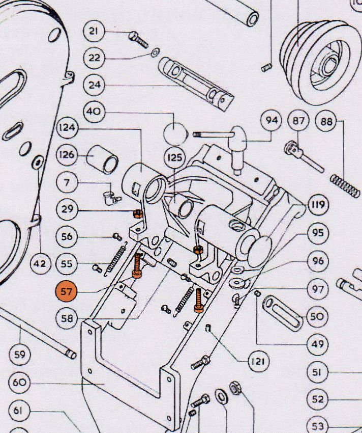

          Fowler,
          … I tried running that lathe at the higher and highest speeds. Definitely a bit more vibration and I can see where a segmented belt might be of some use. Time will tell if this is something I will choose to invest in.
          During these brief high speed tests I noticed a pronounced 'squeal' when switching on the motor… ultimately to figure out that the motor drive belt is a bit slack when placed in the high speed position. It seems to have a correct tension in the low speed position, but I could be wrong.
          Does this indicate that a replacement motor drive belt is required?
          #566926
          KWIL
            @kwil
            An "easy test" for belt tension, Grasp belt midway between pulleys using thumb and first finger. Can you just twist the belt 90 degrees, if so.OK
            As an aside, I can run my S7 at top speed without vibration being an issue. Yes it's a standard belt.!
            #566949
            Ignatz
              @ignatz
              Kwil,
              … thanks for the info. I twisted the belt as you suggested and it went quite a bit further… about 135 degrees.
              Actually, the belt looks pretty good, just maybe a bit too slack.
              Where is the adjustment for the tension of the motor belt located?
              #566955
              Michael Brett 1
                @michaelbrett1
                Two grub screws with lock nuts that rest on top of the shaft that holds the belt tension lever.
                Mike
                #566959
                Ignatz
                  @ignatz
                  Michael, … Are you referring to the two screws that I have indicated in this exploded diagram?

                      #567000
                      Michael Brett 1
                        @michaelbrett1
                        Ignatz
                        Yes , you use the screws you highlighted to adjust belt tension.
                        Mike

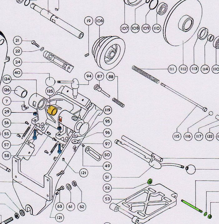

                        #567051
                        Ignatz
                          @ignatz
                          John, … great suggestion to use the change gear retaining studs to check the hole threading. It turns out that the holes at 'C' for mounting a quick change gearbox are indeed M6. The others are 1/4 BSF.
                          Michael, … I fiddled with the tensioning screws (indicated in blue below), but ultimately had to drop the motor a bit (shaft indicated in green below) as well to get the motor belt and counter-shaft belt tensions to balance.
                          In the process of testing it out I discovered that the counter-shaft bushing at the clutch control arm end ( #125 indicated in yellow ) must be pretty worn since the associated oil cup (mounted at red dot) empties out in mere minutes… or sooner.
                          Obviously, until I take the time to disassemble the counter-shaft/clutch assembly I won't know if I just need a replacement Oilite bushing or both that and a replacement counter-shaft.
                          #567066
                          KWIL
                            @kwil
                            Micheal, as Ignatz has pointed out the green bolt and nuts are for the motor belt adjustment, the blue ones are strictly for the layshaft pulley (106) to spindle belt tension.

                                Ignatz
                                  @ignatz
                                  Haven't had the time to tear into the counter-shaft assembly to assess the damage at that leaky bushing, might be a few days until I have a free moment to do so…
                                  …but, I've a few questions about that ahead of time.
                                  1. If I'm replacing that worn bushing (#125) should I also replace the bushing at the other end of the shaft (#126… I'm not seeing any unusual oil loss at that end.)
                                  2. How much wear is considered normal on the end of the counter-shaft?
                                  3. If the counter-shaft is worn are there ways to save it? Polish the end? Turn it down?
                                  4. What is the normal running clearance between the shaft and the Oilite bushing?
                                  5. I'm certain that I'm not the first to encounter this sort of problem. Can anyone point me at any posts on the forum or perhaps online videos that present the proper way to handle this repair?
                                  Any extra hints or tips gratefully accepted. wink

                                    Fowlers Fury
                                      @fowlersfury
                                      Re: Ignatz & oil loss from countershaft:-
                                      Unless you feel some compelling, desperate need to dismantle & replace the bush then I doubt there is any great requirement to do so. AFAIK, those oiling cups on the counter-shaft of S7s lose oil at a prodigious rate.(it's almost worth collecting and recycling !).
                                      I just top up prior to use and live with it – been that way for many years on my S7. The oiling cup on the front bearing of the mandrel doesn't lose oil at anything like that rate and remains full for long periods.
                                      I do though always oil the nipple on the other end of the countershaft. For that it's worth investing in a genuine Reilang oil can with the appropriate female end as the Myford oiler is notoriously cr*p. The Reilang is not cheap but saves a great deal of annoyance as the oil goes through the nipple and not all over the lathe.

                                        Martin Kyte
                                          @martinkyte99762
                                          As the countershaft bushes are sintered oilite type you would expect them to absorb the oil at a fast rate. They can only hold a certain amount, The rest will dribble out. I wouldn't fuss over them too much.
                                          You talk about a squeel when turning on. Although you said this regarding the motor the usual source of this especially at higher speend is a dry clutch. Just a drop of oil between the cone and the pully will illiminate this.

                                          #567156
                                          Ignatz
                                            @ignatz
                                            Fowler & Martin, … I doubled checked the oil usage at the right hand side of the counter shaft bearing once more. With the motor belt at on the low speed pulleys the oil tends to remain in the joint ( and the oil cup ) as once would hope. When the motor belt is placed on the high speed pullets then the oil starts weeping away from that right hand shaft bushing at an amazing rate… empties the oil cup in less than twenty or thirty seconds.
                                            I know that the Oilite bushings being porous retain oil within, but should I be concerned at this great rate of oil loss?
                                            A related question: If the oil loss is this fast when using the high speed range, how long would you estimate that I could safely run the counter shaft at high speed before needing to give it another shot of oil?
                                            About the squeal – that was entirely due to the motor belt being too slack. The squeal came from the pulley slipping within the belt during high speed start-up. Once the belt was properly tightened the squeal disappeared.
                                            Chris, … great suggestion about using that little piece of cloth between oil gun and nipple. The oil gun now seals properly when applied to the nipples….
                                            … of course, the silly oil gun still leaks all over the place from its own seals so that my hands probably get more oil than the lathe. laugh
