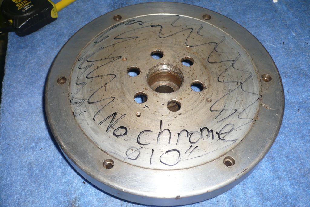

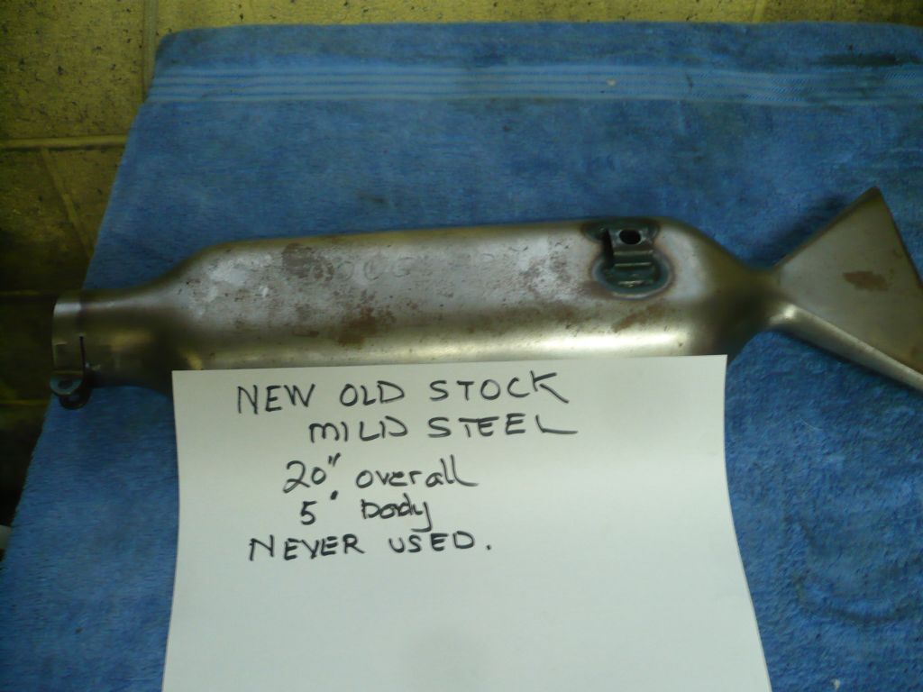

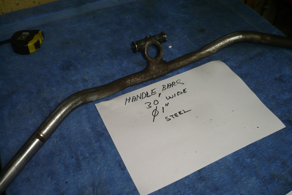

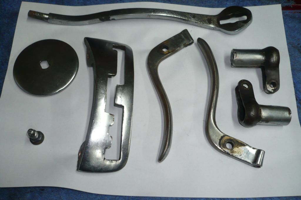

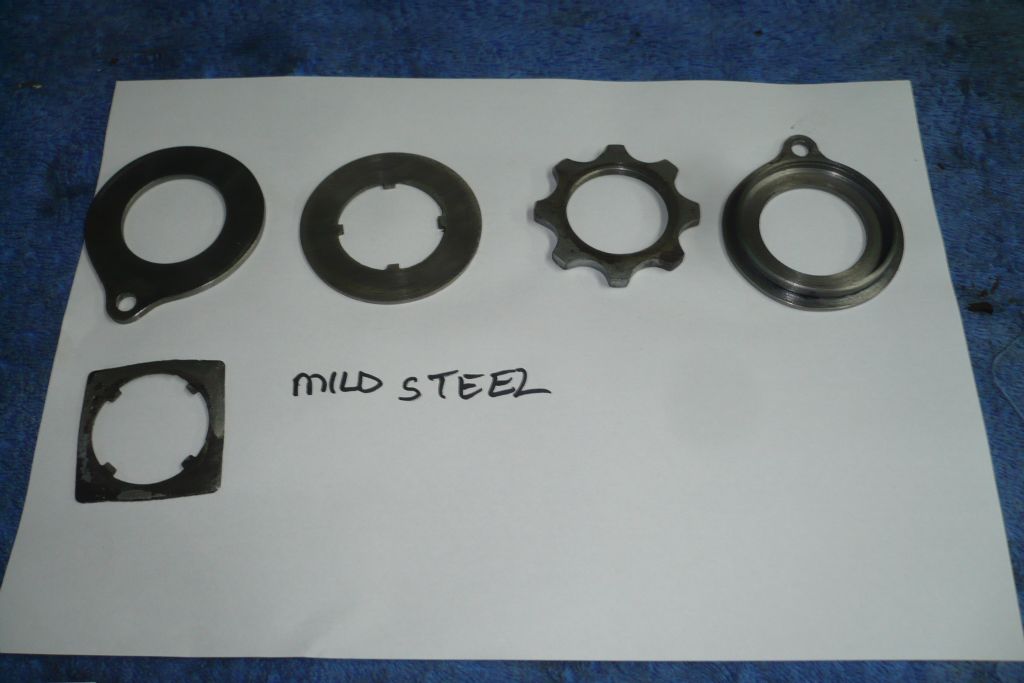

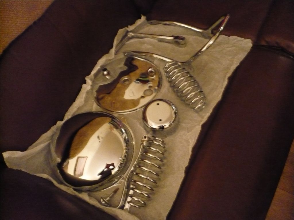

                                                As we are talking chrome anyone like to guess the price of triple plate chroming of these eight parts I had done last year.
                                                Regards Colin

                                                  Last week I sent off the chrome work from the Douglas, it's a 1930 machine so it had chrome and nickel but I am going all chrome, I am not having the tank done it will be silver as chrome was an option, again anyone want a guess a price.
                                                  Talking cost, I do most things myself so I save a lot but I can spend from £2.5k to £4k depending on the machine.

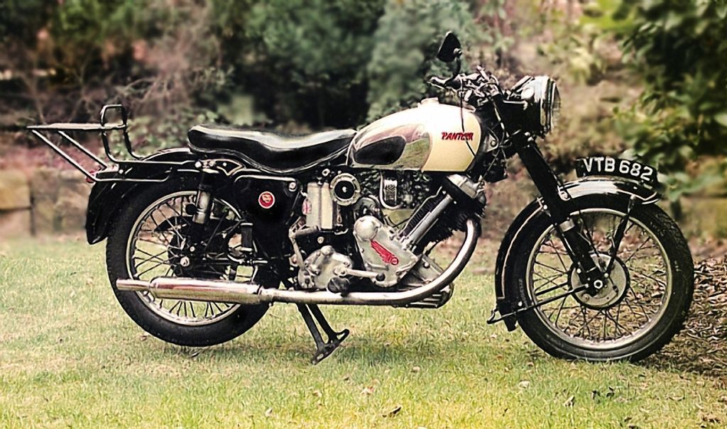

                                                    True enough about chrome re-plating these days. For one of my rebuilds where surface rust had ruined the original chrome plating, I used a nickel plating kit. The process is safe enough altho' tedious & requiring a LOT of preparation. A preliminary coating of electroplated copper is advisable on mild steel. The final finish of course will not look as reflective as chromium but a polish with Solvol or the like and the appearance is very close. For chrome-plated Cu oil pipes that needed replacing, I made new pipes then silver coated them. Again, a simple, safe process used extensively by clock restorers.The silver (from silver nitrate soln) binds directly to the Cu surface and is resilient to oxidation if coated with a non-yellowing clear varnish..
                                                    A low-res image of the Panther but the covers on the rear shocks, the front brake actuating arm, tank filler cap and a few other smaller items had been Ni plated back in '84.

                                                      Posted by colin brannigan on 17/01/2023 14:45:37:
                                                      Regards Colin
                                                      100 Quid?
