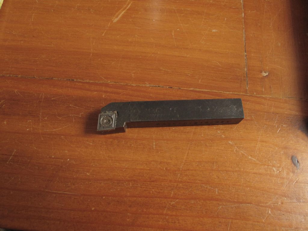

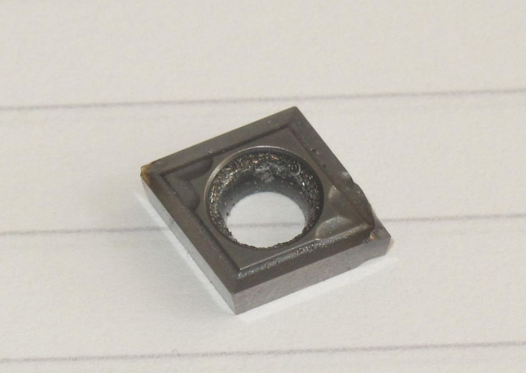

        img_4933.jpgimg_4931.jpgCan anyone identify this sumitomo carbide insert?
        The insert is approximately 15mm cutting tip to tip on the longest edge. I have used it to cut brass, steel and stainless however I don't know for certain its intended cutting material.

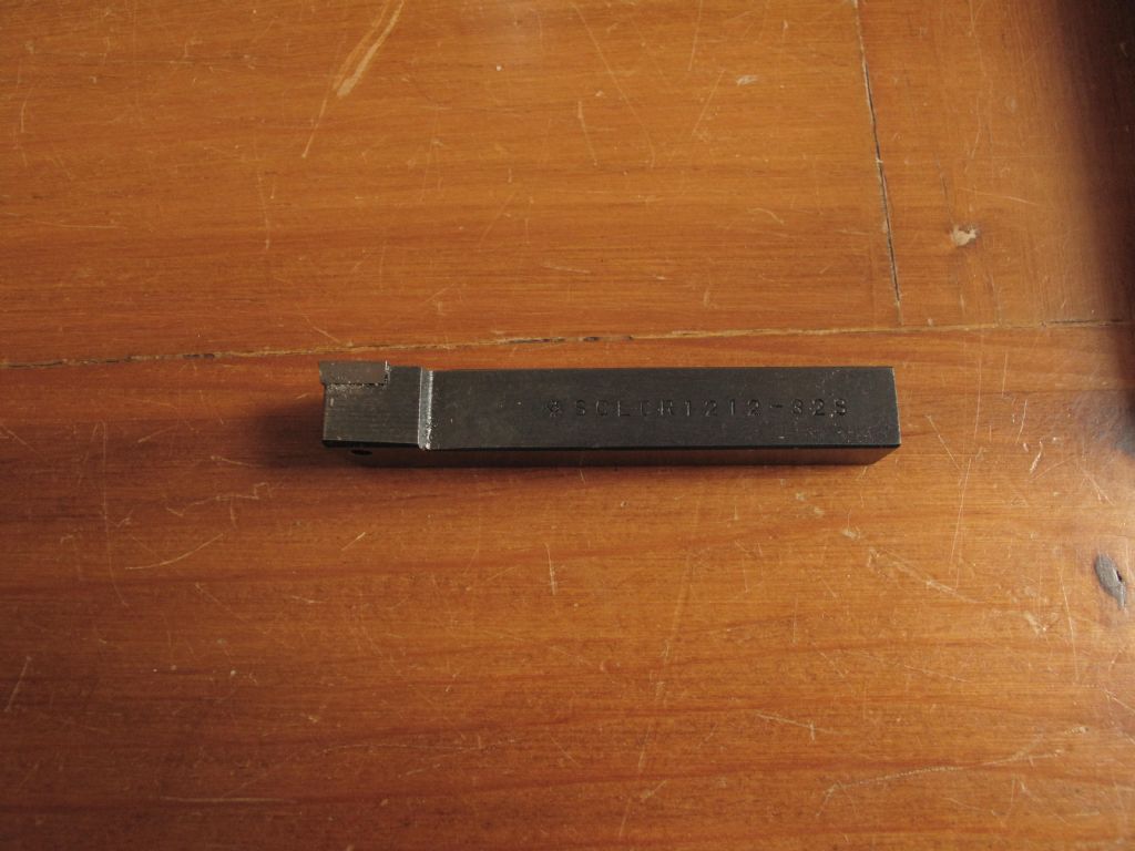

        If anyone can identify the part no, it would be much appreciated. The tool holder reference number is sclcr1212-32s.

          Probably something like a CCMT090204 but no idea on it's properties. But could be CNMG because of the deep chip breaker.  Is there a ref number on the side of the insert ?

            Sadly there isn't any part no printed on the insert, but here is a close up of the cutter.img_4937.jpg

              Looks to be the MU type chipbreaker, but you should be able to deduce the full code from this GU catalogue

                With the holder description indicating it is 12mm x 12mm and the tip being 15mm on the long corner to corner I'd go with C*MT 120402…. rather than 09 as it looks as long on one edge as the holder is square

                  Can you confirm the number Jon? There is no SCLCR1212-32S in this Sumitomo Catalogue I found online. Nor does Mr Google find it. There is a SCLCR1212-F09 for which Sumitomo list inserts: CCGT 060202 RF-X; CCMT 09T304 N-SU; and CCMT 120408 N-SU.

                      It is certainly single sided, and looks to me to be a CCMT12, the CCGT12 for aluminium would also be useful. The size is the inscribed circle diameter in mm, with this shape, just measure across the flats in mm.

                        Edge to edge on the flats the cutter measures 9.52mm which may avoid some confusion.

                          That will make it an CCMT 09, just looked like it was about the same as the 12mm holder width.

                            CCMT 09 it is then, you can get the cheap Chinese inserts readily which are pretty good quality now, and also the CCGT09 for aluminium which are good for stainless steel and for fine finishing cuts on steel. Only experiance will tell you what depth of cut and feed rates to use, these inserts have two edges only, unless you get hold of tools which use the obtuse angle for roughing.

                                Hi Jon, in the early '90s, there was a chap called I R Rivers, trading as L B & S C R, in London SW12. He used to demonstrate Sumitomo tips and tooling at the Model Engineer Exhibition, and sold a small range, by mail order. Your holder is listed in his catalogue. He listed the following tips for it: CCGM 32XEFM (0.1mm tip radius), CCGM 320EFM (0.2mm tip radius), CCGM 321EFM (0.4mm tip radius), all in T12A grade carbide, a robust, general purpose grade, which worked exceptionally well – you could throw blue and smoking chips all over the workshop, working at what then seemed ridiculous feeds and surface speeds, and also take very light finishing cuts, all with excellent surface finish.
                                Ian Rivers faded from the scene, and Mr Carter appeared, I suspect for not very long, around the turn of the millenium(?).
                                I haven't looked at a Sumitomo catalogue for ages, but would not expect any of these holders or tips to be listed. I believe that Sumitomo's tips and holders, then in production, did not respect the ISO dimensional standards, and, by the late '90s, Sumitomo had fallen into line with the rest of the manufacturers, producing ISO-compliant tips and holders. Someone please correct me if this is wrong. This was bad news indeed for those of us who had invested in their tooling. Grrr!
