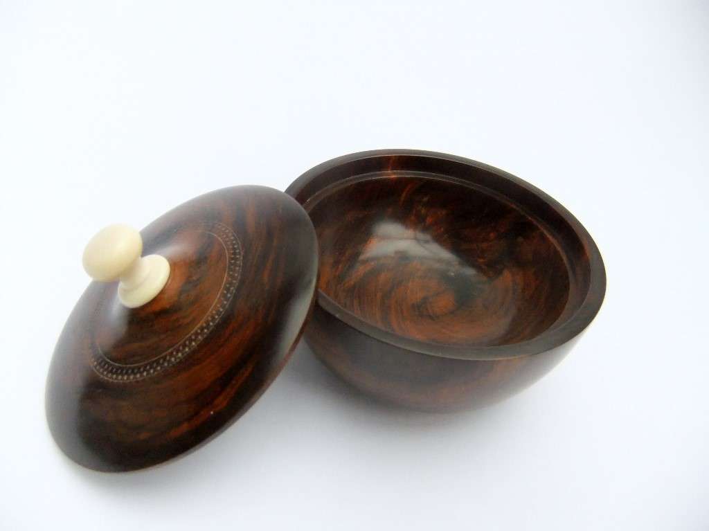

            As already mentioned, the preparation is the key, I have used Cellulose thinners to clean the surface as well as roughing he wood surface a little where it needs to be glued.
            Remember that the Polyurethane type Adhesives do foam so a tape barrier is advised also a little dampening of one surface helps it to cure better.
            Worth noting is that the Polyurethane glue can push the part out of position to make sure it is clamped during setting and yes I have forgotten to do this once, lesson learnt.
            I have done this with LV wood and plastic. See Photo of the knob on top of this piece.

                        Dalboy: I like your bowl, which looks rather 1930s. Is the pattern around the top the pattern from an old bowls ball or something that you created?
                          James.
                          Something I created using a very cheap knurling tool that I acquired before going into model engineering and a skew chisel for the two lines. And yes i still do woodwork and turning

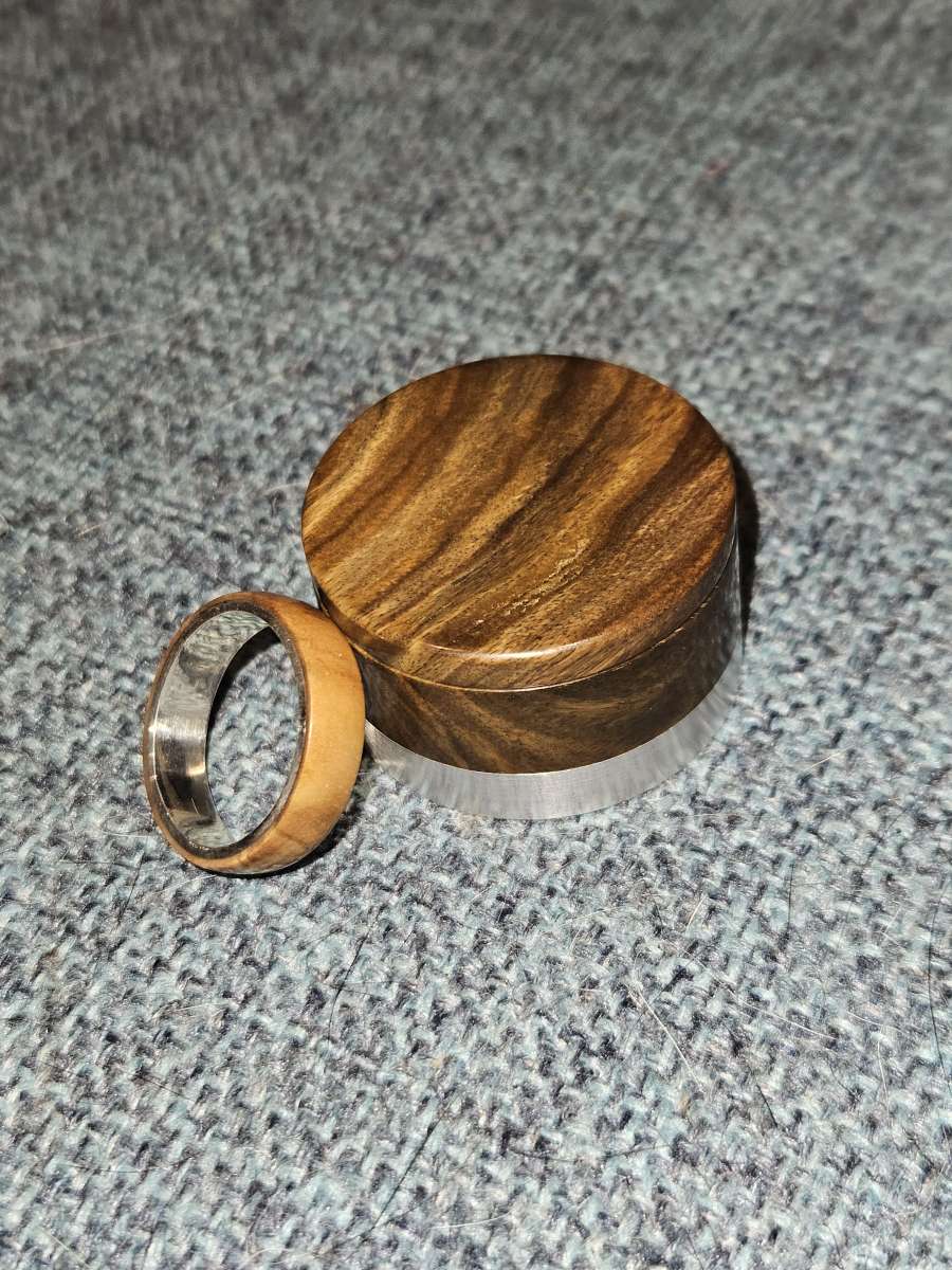

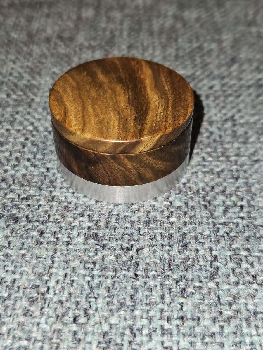

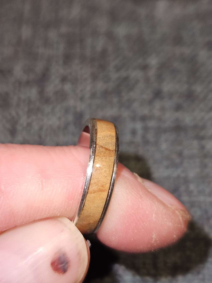

                              #767125
                              James A
                                @jamesalford67616
                                In the end, my son decided on having an olive wood ring instead. I made two styles. I still used the lignum vitae to make a case for the ring. These are the finished items.20241025_20572620241025_20582220241025_205849</p>
