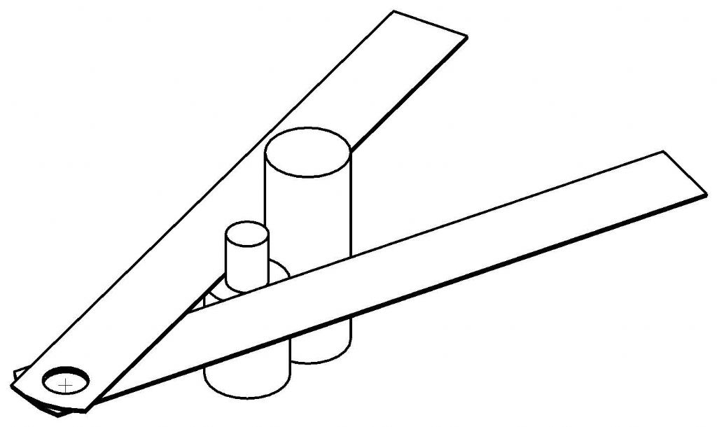

      Hi Graham,
      Your `twin rule’ solution is a very neat idea, and puts more sense into my bit of geometry.
      I’m sure it will prove useful to others, especially if shown with a 3D picture.
      Thanks for your closing comment.

              Hi Graham,
              While you were fast asleep last night, I was hard at work cobbling out an interpretation of your smart method. Should anyone wonder what the blazes we were talking about in the distant future, they can view my renderings with jaw-dropping awe.
              If you are someone who has just tuned in, the steel rules are clamped together through their (already existing) holes.

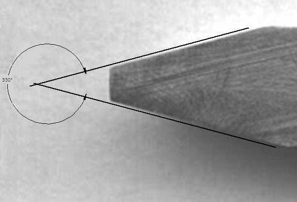

                  Hi all, I’ve just had an email from Gray asking me to load this pic on his behalf.
                  He was trying to do so yesterday but was not able to do so for some reason
                  I’m sure Gray will be on later to add more.
                  Regards – Ramon

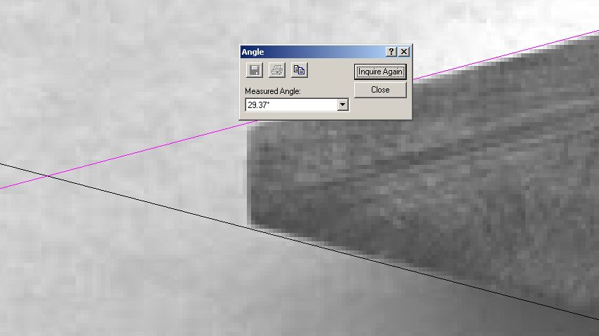

                              Graham, I loaded your jpeg into AutoSketch and blew it up so that I could see the jaggies along the edge and ran lines along them, which is as accurate as you can get with it, I think. Here is the result (only the end shown – the lines ran along the whole length):
                              29.37 degrees.
                              Edited By Steve Garnett on 01/04/2011 11:26:38

                                            I agree with Steve quite closely and make your angle about 29.48 deg
                                            Is that close enough?
                                            I imported you jpg from PS Pro into Deltacad after cropping and then added the angular dimension. I checked the accuracy by printing from each application and measuring and the result was the same in both cases i.e. both printouts matched.
