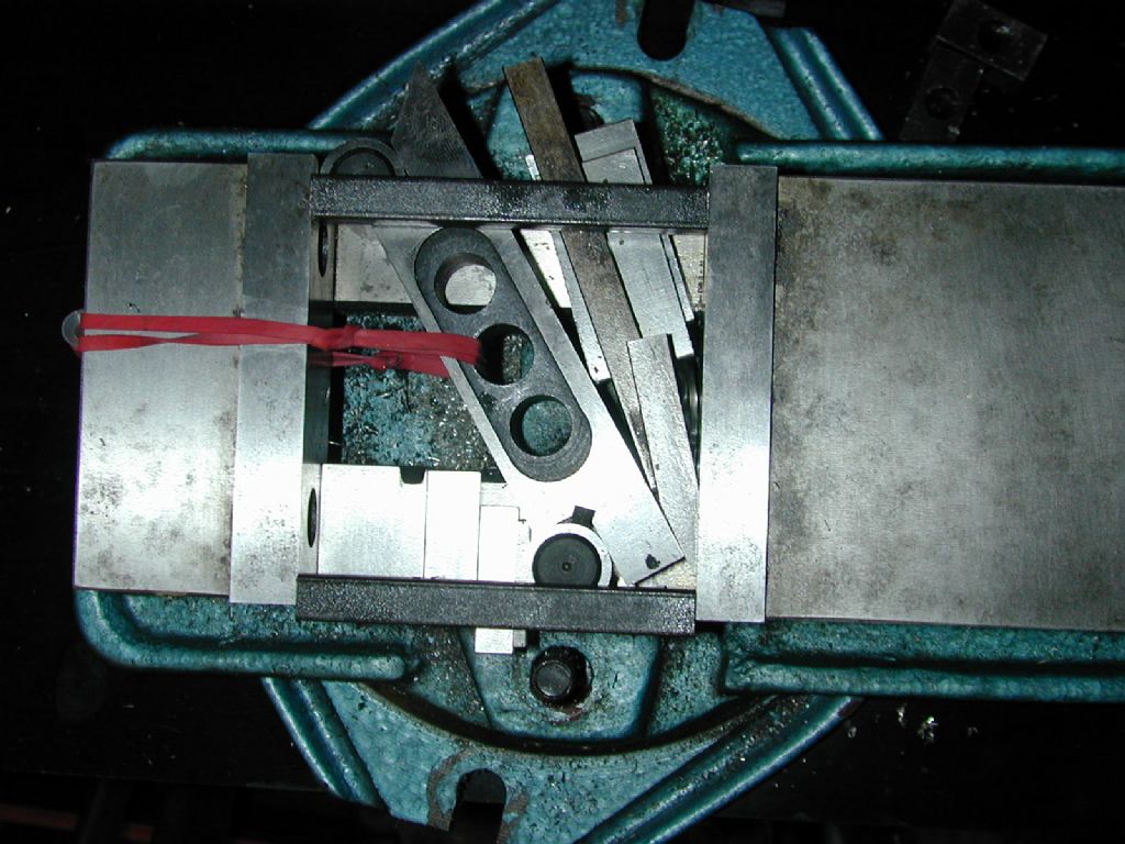

          John C
            @johnc47954
            Hi Grey,
            Would a sine bar and slip gauges inside (say) the parallel jaws of a milling vice work? You’d still need to sight the tool edges inside the included angle but you could maybe feel the rock in the tool.You could nip the jaws up onto parallels even if this left the tool nose unsupported.
            All th ebest,

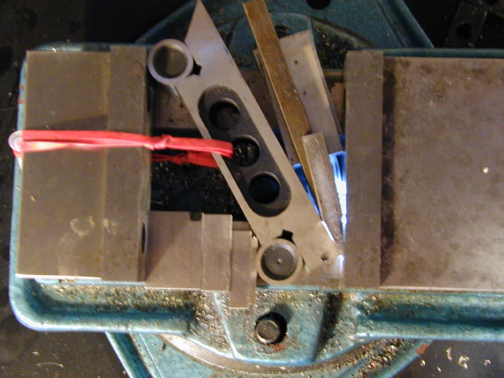

                        John C
                          @johnc47954
                          Hi Gray,
                          Further to my post above, I rigged up a mock up of the vice and sine bar. The two bars between the vice jaws are machined together to the same length to ensure the jaws are parallel and the rubber band is to keep the sine bar and the slips together. I put a key ring LED under the tool to show any gap. The ‘tool’ is a bit of steel I ground to 29 deg internal angle on my Worden, set using an ordinary protractor, so as you can see it would need a skim to be spot on.
                          The first photo shows is without flash and with the matching bars removed to show the keyring LED shining in the gap, the second shows the general idea.
                          Hope this helps,
                          ( And I also hope I have got the right end of the stick!!)
