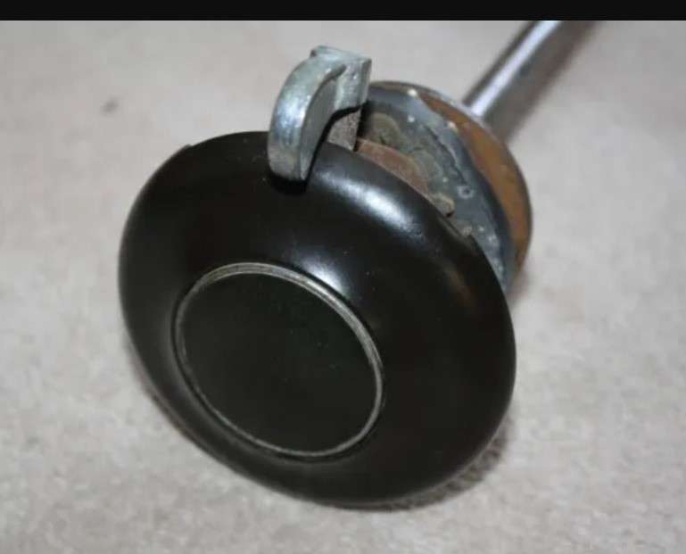

      I wish to make a replacement metal trim for a Lucas horn button. It is the chrome metal circle in the picture below. It is a square u-shaped cross-section, made of thin metal. The channel is approximately 3mm to 4mm wide.
      Does anyone have any suggestions how I could make this, other than by carefully tapping a piece of metal around a former?
      Lucas Horn Button
      Thank you.
      James

        Can you make a dimensioned pencil drawing of it and upload.
        I am puzzled by the ‘square U-shape’. Does that mean vertical left leg, horizontal base leg and vertical right leg?
        On an industrial scale, it would have been pressed/stamped. Expensive tooling but amortised over 100,000 units, it is cheap.
        If the gap between the two legs of the ‘U’ is an artifact of its production method rather than essential to its function, make from solid bar. Turn OD, bore ID, part off. Stainless can be made to look like chrome, or perhaps nickel plate brass or steel.

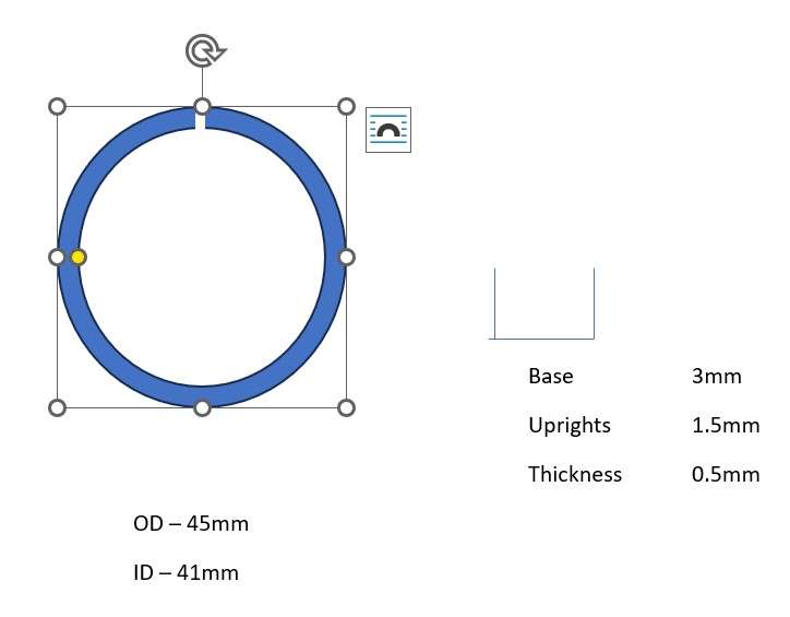

                                          James Alford
                                            @jamesalford67616
                                            Thank you for the suggestions. I am not sure about turning the piece from solid or trepanning it, not least because of the thinness of the material and my ability.
                                            The sketch below gives the sizes. The split at the top is to allow the piece to be opened up slightly to get onto the button.
                                            Ring
                                            #709025
                                            Martin Kyte
                                              @martinkyte99762
                                              I would turn it out of solid. The ‘hollow’ back is not really needed I suspect. I would turn the shape on the face of a piece of bar. Boring the centre deeper than the shape and then turning the outer diameter to size. Form the curve and part off. Piercing saw to create the cut. The diameters may need adjusting down a tad to effect the ‘nip’ onto the button.

                                                    That is similar,  but a little different. The version I am working on is from the mid-30s. The original ring is pressed somehow from a strip of metal. If it had a solid back, as suggested in a different post, it would probably interfere with the mechanism behind it.
                                                    James.
