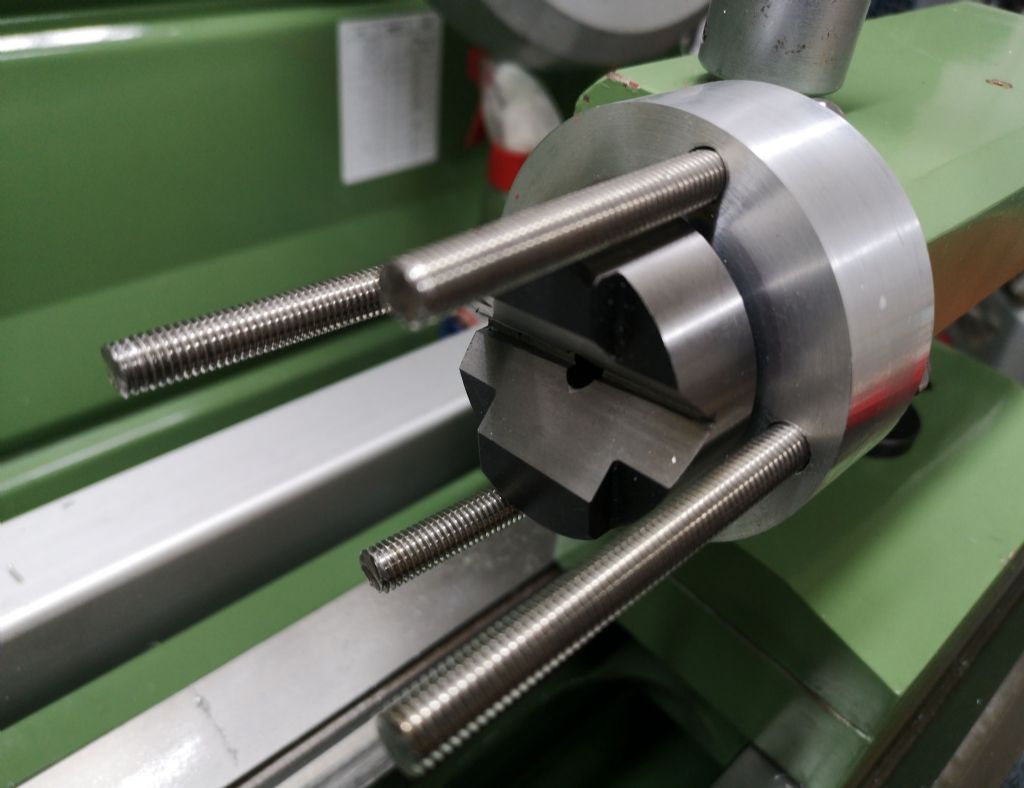

                                        #511412
                                        Terry Kirkup
                                          @terrykirkup37827
                                          Hi William. Here's something I was savaged for recently on this site (but it worked!).
                                          And my grippy "thing" for the tailstock (bought the blank arbour, made the chunk of aluminium, maybe too deep)
                                          Have fun and take care.
