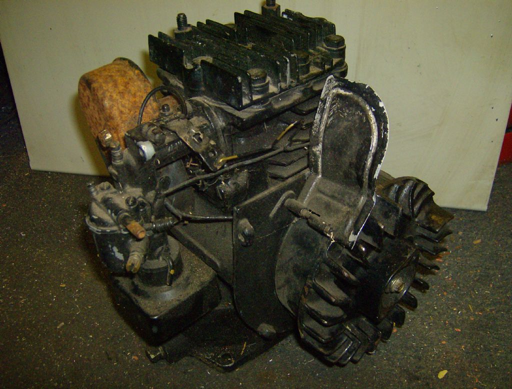

        A couple of weeks ago I picked up this old 78cc Suffolk Colt engine at the tip. The flywheel was held on by a small self-tapper and it was coated in thick black paint:
        Now it has become this:
        The main jobs were:
        Clean black paint off everything (especially carb!)
        Weld up cowl from old storage heater panel
        Re-attach flywheel
        Turn up starter pulley
        Clean carb
        Make new throttle linkage and fix governor flap
        Make petrol tank from fudge tin
        new HT lead, and plug
        clean points (one of the few things not covered in black paint)
        Fuel tap (using 10 year old stainless taper blank and taper D-bit)
        Add balance weight to flywheel (four broken vanes)
        Base from salvaged timber
        Clean out old oil and refill with fresh
        Repaint
        Stater handle and coil.
        An LO! it ran for a fews seconds on the first pull, and ran happily after about three tries. I’m making a few final tweaks, most important is a throttle and cale linkage. In due course it should have a de-coke (don’t look inside the plug hole!) but I don’t want to pay £20 for a full gasket set. And I need  something like a 3-4″ pulley.
        Total cost of the rebuild was about £20, and could have been less.
        If you get the chance to do a similar job, have a go – it’s great fun!
