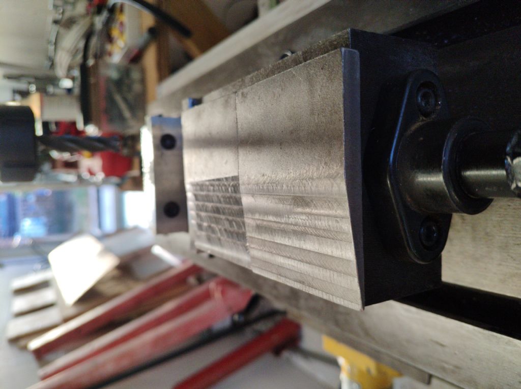

                        Thanks, I have a lathe, a very old drummond. It's a bit of a chore to use and it's 3/4" spindle thread limits it's duty a lot. With patience I could make this out of brass or aluminum. I've also got a Smart and Brown Model A, which I imagine would do this in a blink, but it's not running yet.
                        I've started milling out the plates to make the wedge as suggested by other posters. This is my first time on a mill so taking things slow. I've squared them up, with the drawbar loose, and it hasn't dropped yet! Ready to put the taper on them now, have to work out how to hold them to get a repeatable angle.

                                                      Not yet, I've started on the tapered wedges, I think an M10 socket screw would fit, I don't have hex bar but knowing that's an option if it does get stuck would be useful.
                                                      Progress is slow, this is my first time on the mill and work is mostly consuming me at the moment.
