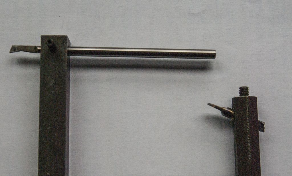

                        Hi Allan
                        For cutting that groove in the eccentric strap I made a little boring tool.
                        The left hand one is a boring tool(!) and the right hand one is like a tiny parting tool and this was used ( in the left hand holder) to make the slot.
                        Tool bits were made from 5mm dia silver steel hardened and tempered. The holders are just mild steel with the tool bit held in place by a grub screw. Not pretty maybe but quick, simple and effective. ( The sit in a drawer with lots of other "special" tools awaiting the next occasion!)
                        Good progress on your Victoria.
                        Regards
                        Norman
                        Edited By NJH on 01/12/2013 11:55:00

                          For the internal recess you need a tool that you can hold with its shank along the axis of the lathe and a cutter that protrudes back towards the operator. A bit like an internal boring or threading tool.
                          I would use a boring bar I have that takes 1/8" square HSS toolbits at either 45 or 90 degrees. One at 90 degrees with the end ground down to match the width of the groove would do it.
                          Another way would be to turn a disk of suitable diameter on the end of a piece of silver steel with a suitably narrow neck. grind or file away a quarter of the disk that harden and temper to 'straw colour'. I have a small version of such tool that can be poked into really small holes to cut grooves. If you have a suitable grinder you can make a tool from HSS rod, but not a practical proposition with an offhand grinder.

                            I made a suitable tool(used it when I made an eccentric strap for the Stuart S9), it is a bit of 1/2" dia. steel from the junk box, with a chip off an industrial hack saw blade brazed at right angles, it's rough, but it works.
                            Ian S C
