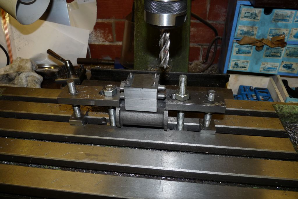

                                              roy entwistle
                                                @royentwistle24699
                                                Allan I think you will find that it should be up at the other end of the slide bars
                                                Just a thought and can I ask do you never use hand tools like files ?
                                                Roy

                                                  Thanks Roy – oops!
                                                  The Bridge in the right place.
