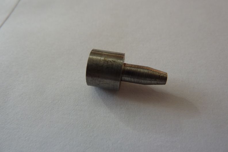

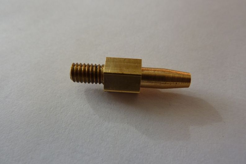

              #145891
              GaryM
                @garym
                Here are the adapters I made. Both tapers are sized to fit tubing, brass one is threaded to fit steam inlet and steel one is same size as a tyre valve. Rough and ready, just to do the job.
                Gary

                #145921
                GarryC
                  @garryc
                  Cheers Gary.
                  Had a length of 5/32 brass pipe arrive yesterday to fit the 1/4 x 32 tpi unions that screw into the cylinder. As I have some aquarium airline I'm going to give that a try first, I think it may fit directly onto the 5/32 pipe but not tried it yet. Still waiting for the unions to arrive from Stuart also a little pipe bender and some bending springs from elsewhere. I've noticed that this 1/4 x 32 tpi size union is not always stocked by some suppliers and may be particular / or at least mainly used by Stuart Models. The foot pump adaptor I will do as you have – the car valve diameter I think is 8mm from looking on the internet but easy to get from the car of course.. Hoping the unions may arrive today..
                  I've recently read somewhere, I've forgotten where though, there may be a corrosion issue if you use a steam boiler especially if only infrequently, I wonder if anyone can confirm if this is true or does a displacement lubricator cure this or help much. My intention would be to get a boiler after completing the next project unless this is a real problem. It would help to know as if true I will just go ahead and buy a decent air compressor now – real shame though if thats the case, surely not I hope?
                  In order to get the engine running nice and smoothly I can see that either a compressor or a boiler is needed – but having it work off a foot pump as well would be very handy… Preference though for 'proper' use is a little boiler.
                  Cheers and thanks again Gary.
                  Allan.
