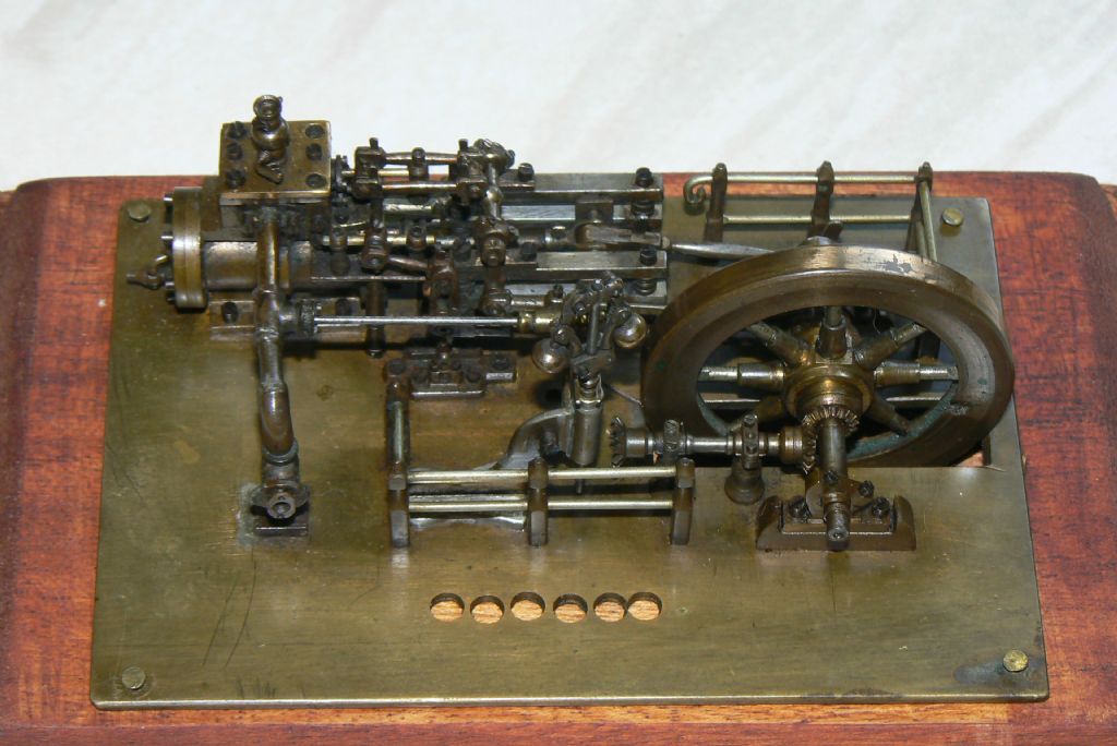

                              Hi Allan, if it's mill engines that you are interested in, here is a model of a mill engine. The model must have been made around 1905. For scale the spokes in the flywheel are pocket watch winders…
                              I found I could easily copy the configuration using the Victoria kit and Victoria spares, but not of course the intricacy. This is a model of the Lancashire mill engine I referred to early, but I've not been able track down the specific mill. (I still need to add the railings to mine…I wonder if these models are ever completly finished )
                              The lubricator is sat on top of the steam chest and is called a "shapely lady".   One old timer told me that getting the sequence of opening and closing the taps wrong was very exciting.
                              Some other photo's of this in my Victoria album.
                              Steve
