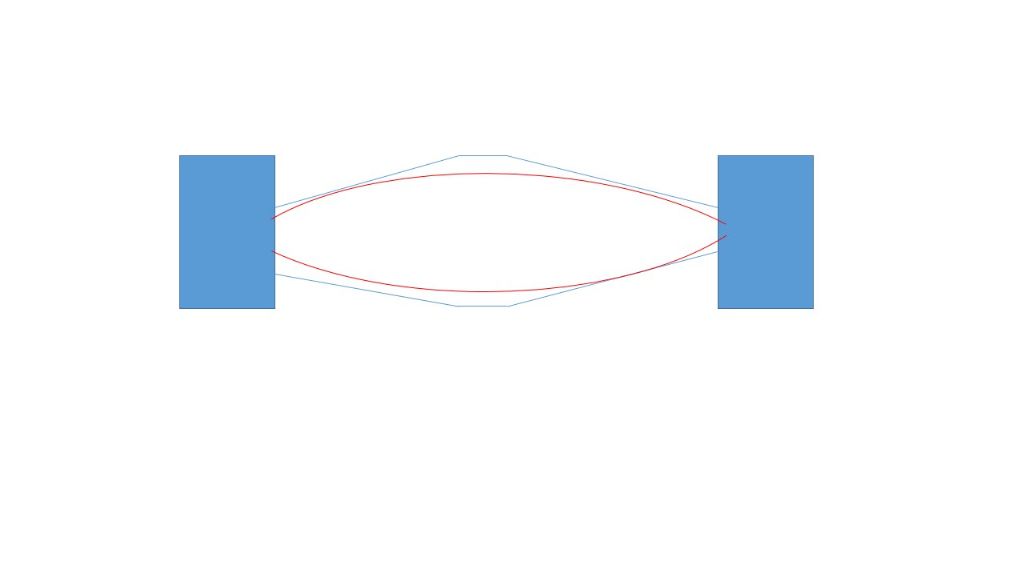

                                      If you (or anyone) could give me some idea of the procedure for turning the taper (between centres) on the Con Rod I would be very grateful?
                                      Thanks

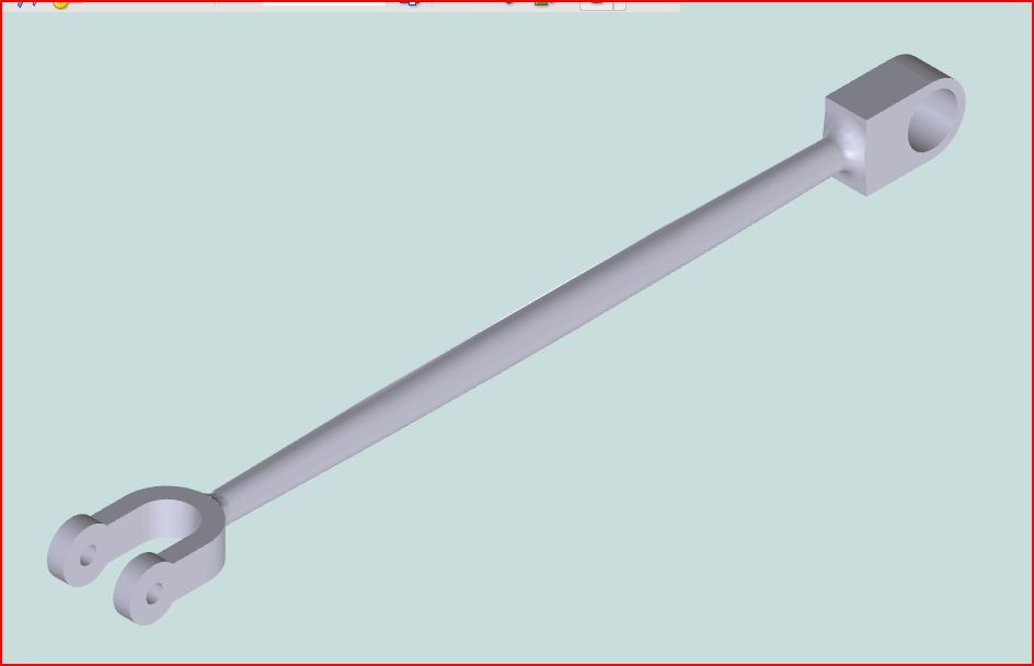

                                      #140333
                                        First rough out to just over the largest diameter for the whole length.
                                        Then change to a tool with a rounded end HSS will be fine though the button ended indexable tools can be used if you prefer and take the whole thing down to the widest part of the belly eg 5/16"
                                        Now to get the belly you roughly divide the length by 3, the middle stays parallel and the two ends taper from 5/16 to 1/4, a bit of trig gives an angle of 1.1deg but you will have to use some trial and error.
                                        Turn the 1/3rd nearest the chuck to the taper until it is 1/4 at teh end and fades out about 1.6" along the length.
                                        You can now either sawp the part end for end and do the other taper which will be the easiest if working between ctrs, if you are holding one end and just supporting the other then the topslide will need adjusting again.
                                        Now you have the three facets its just a case of using a file while the work rotates to blend the areas where they need followed by some emery cloth, make sure you cover the lateh bed, I use a board or cardboard, avoid a cloth as it could get caught in teh spinning work.
                                        Don't think I have any pictures of rods being done but this shows a pully rim being crowned which is the same process but I divided the width into 5 as you should be able to see on the surface towards the top
                                        This is the type of thing you should be aiming for

                                              Here is my setup – be interested in Jason's view of it!
                                              As per jason, I turned three facets two long ones at either end and a short flat in the middle. On my C6, the top slide only just had enough travel to complete the long facets. The next bit is a bit more like woodworking, I used 80 Grade emery tape to rough out the shape, then used 400 grade to get the scratches out, then finally using Brasso with well worn 400 tape. DO NOT wrap the tape around your fingers to get a good grip!
                                              As an aside The same sort of approach has my cylinder end caps looking almost like a chrome plated finish, it's amazing how well cast iron will polish up and it does retain that finish very well.
                                              Steve

                                              Steve Withnell
                                                @stevewithnell34426
                                                My best effort at a sketch – The blue lines are the facets in the previous notes, the red line is the shape of the rod that best fits the plan, the end dimensions and the mid dimensions are taken from the plan.
                                                Steve

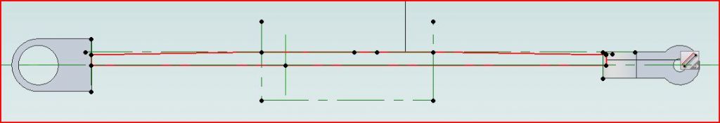

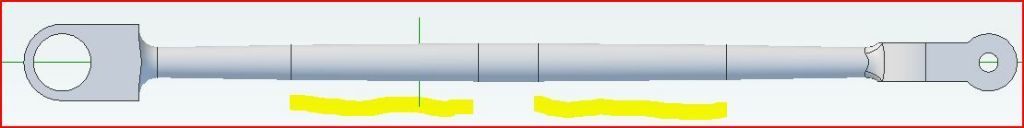

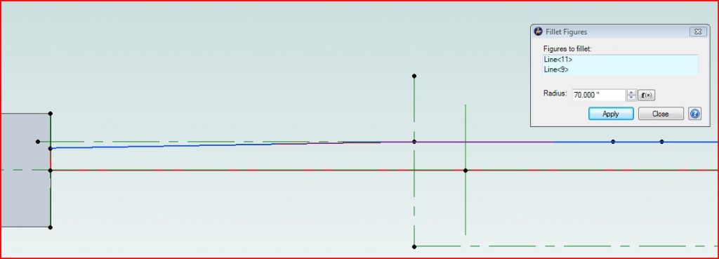

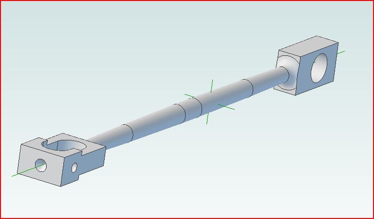

                                                  #140382
                                                    Steve as long as it gives a shape that is pleasing to the eye it probably has little effect on how you do it. The only thing I can see between the two methods is that my turned 1/4" and 5/16" extremities don't get filed so they can be set to the exact sizes, your blue lines don't correspond with these sizes so there is a bit of calculated gues work.
                                                    I've done a few sketches too.
                                                    The first shows the three facets to the curve in red. The two vertical green lines are at approx 1/3rd distance. I have exagerated the angle slightly so it shows up better.
                                                    The next shows a 70" radius curve between the two facets which are now in blue and the curve purple, this is what I would do with the file.
                                                    This elevation shows the two areas that are filed underlined with the highlighter
                                                    You can now start with the abrasives to blend it all into one.
                                                    And this last one shows how far I would go with the milling before you start turning although I have left the middle shown as turned
